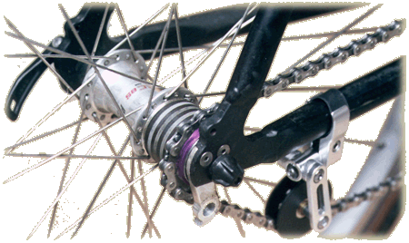

safe
Posts: 5701
Joined: Dec 22, 2006 12:14 pm
Post by safe » May 05, 2007 7:27 am
Looks like a good choice of components. The motor and internally geared hub will work well together. That's a good combo. Nice. 8)
As for the chain problems...
You have suspension and your pivot point is not centered at the same location as your front sprocket so when you hit a bump (or even when you simply sit on the bike) you will get "sag" in the suspension which will allow the chain to get loose. Add to all this that the swingarm probably flexes a lot and your alignment might not be perfect and you will have all kinds of problems.
I'd advise a chain tensioner. You could probably convert an old derailler arm and wheel to a tensioner. You want to have a "spring effect" to keep the chain snug and this will also solve your problems with the front sprocket being slightly off. This picture shows the right location, but it lacks a spring. You want the tensioner positioned so that it takes up the "slack side" and not the "power side" of the chain. Motorcycles have been doing this for years...

It seems like all I really need is the guide part. I don't really need the tension part. Perhaps I could buy something that is just a channel with sides that are as wide as the chain that just keeps it from veering in any way. Do they sell that?
Who makes the device in your picture? Where can I get one?

Beagle123 wrote: Who makes the device in your picture? Where can I get one?
I believe that one is no longer made.
Here are some others:
http://www.jensonusa.com/store/product/ ... eator.aspx
http://www.rhythmcycles.com/xcart/custo ... 299&page=1
http://www.bikemannetwork.com/biking/c/SSCHTEN
