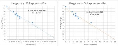

Post by Matador » Jul 22 2017 11:06pm
have a very old version the Arrow-7 Love it. My battery is not old though (100 cycles).... It's a 36V 10S10P 20ah... I dont have the one with samsung cells.
I got the one with cheap chinese cells .... Still, look at these numbers.... I'm mainly doing throttle only (My system is 350W continous) :
Here, dit a few tests
July 13 & 14 --------- Departure 42.0V (100%) -----> Arrival 38.4V (70%) -------- Distance : 13.5 miles ; 22.0 km
July 15 --------------- Departure 41.8 V (99%) ------> Arrival 39.9V (81%) -------- Distance : 8.4 miles ; 13.5 km
July 17 --------------- Departure 41.7 V (98%) ------> Arrival 40.6V (88%) -------- Distance : 3.0 miles ; 4.8 km
July 20 --------------- Departure 40.5V (88%) -------> Arrival 39.2V (77%) -------- Distance : 9.8 miles ; 15.8 km
July 21 --------------- Departure 40.5V (88%) -------> Arrival 37.6V (63%) -------- Distance : 13.7 miles ; 22.4 km
July 24 --------------- Departure 41.7 V (98%) ------> Arrival 38.6V (71%) -------- Distance : 13.2 miles ; 21.2 km (done in real 1:15 stop included... so average of 17 km/h in traffic and pauses).
I think I can do 35 miles (60 km) range and still have 25% left (33.0V) but starting there, cells will get unbalanced....
With my setup, my cells see 0.5C.... Pretty reliable for commuting needs.

It's a 36V nominal 10S10P. BMS is 25A max. I found out that the cells are cheap 2600mAh chinese 2C-max rated "DLG" branded cells : http://www.dlgbattery.cn/en/ & http://www.dlgbattery.cn/en/upload/2016 ... huxing.pdf
So that's 36V at 26 Amp-hours.... (936 Whr)
Sans titre-11.jpg (244.3 KiB) Viewed 26896 times
Not bad considering the price I paid for a second hand bike ... 600 USD. Manufacture code on the cells say they are form June 5th 2016 (1 year old cells).
Cheap cells yes, but at 2C these 2600 mAh cells could theortically give out 52A burst (but BMS is only good for 25A)... Anyways, controller is at max 15A, which is babying the battery
Hence I get great range on Manhattan island. I did a few discharges to see the range (my charger charges the battery at 41.7V fulled).
Sans titre-8.jpg (114.03 KiB) Viewed 26896 times
I wonder If I can really expect an 80 Km range on a full charge... The LVC is set at 31.5 V. Considering the amp pulls at most 15A and cells are max 55 milliohm. I can't expect much more that a 1.0 voltage drop at full load.
So it I check the curve all the way down to 32.5V, I could expect 80 km from this 26Ah 36V battery ? Quite awesome !
Matador

This is my 600 USD Manhattan commuter ride.... the Range versus Volts graph you see above are from that battery sitting under my seat (with those cheap chinese cells) :

Did a 39.0 miles on shot ride today. FUll twist throtte, pedeling along 95% of time, averageing 17.45 mph.
My hands are bruised and my ass aches from the long ride...
I really like the range. 39.0 miles is 62.8 km.
If went from 41.7V to 35.9V and did 39.0 miles. So that's grossly 12.5 Wh/miles or 7.8 Wh/km consumption...
Do you think I can push it even more ??? The battery is a 10S10P made of 2600 mAh chinese cells (max rating 2C.... so maximum 52 amps but anyways BMS is 25A).
At what voltage would you guys push it ? My LVC is set at 31.5.... Should I test discharge all the way down to 31.5V to test the range ?
I thought maybe 33V, not less.... I heard cells become unbalenced is discharges do zero.
