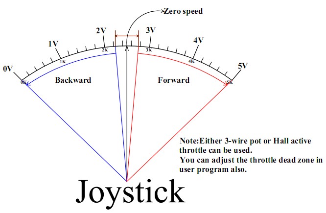

[x] Throttle effective starting/ending: Imagine using a joystick for a controller. If only the slightest movement of the joystick made the motor start turning, it might be difficult to control the vehicle at low speeds. In which case, you might want to ignore the first 10-20% of joystick movement for example. Also, depending the analogue signal from your throttle, you might find that your motor still turns even when you've let go of the throttle, in which case you should increase the effective starting position. Equally, you might turn the throttle all the way, so it was fully open, but the signal sent to the controller might not be registered as fully open. In this case, you'd want to decrease the throttle ending position. The defaults are 20% and 80%, but it's worth noting that this would make only 60% of your throttle travel usable.

  • 0-5v: 3 wire resistive potentiometer. I've been successfully using a typical B10K potentiometer as well as the small thumb joysticks that you get for Arduinos and the like.
  • 1-4v: I believe this is for hall active twist grip throttles? Could also be used with a 0-5v pot to ensure you get throttle full open/close.
  • 0-5k: I believe this is for a PWM input? Note, this won't work with an RC receiver as the pulses are different.
Unless you tested it and found it to work, in my version, the controller would not power up without a 1v current in the 1-4v mode so you can not use a 0-5v throttle on the 1-4v mode. This is important because in the firmware version I have, the brake throttle and normal throttle have to be of the same type. You must have either a potentiometer brake and throttle or a hall effect brake and throttle.

FWIW, you can still use a pot in 1-4v mode, but you have to add resistors to each "end" of the pot of a value such that they have about 1v across each one of them, so the pot itself only has 3v across it, so the range of the signal pin can only go from 1v up to 4v, preventing an error.
Simplistic math is if it's a 3k pot, you have two 1k resistors, one of which goes from the +v to the "top" pin of hte pot. The other goes from the "bottom" pin of the pot to ground. (the middle pin of the pot goes to the throttle (or brake) input of the controller).
So use the same ratio 1:3:1 to figure whatever resistors you need for the actual pot resistance.

Glyn wrote:
Feb 17 2018 7:34am
Step 4
[3] Releasing Throttle Starts Regen: This option will use regeneration whenever the throttle is released. For example, free-wheeling down a hill will recharge the batteries whether the breaks are applied or not. Note however, that if this option is enabled, then it will be more difficult to free-wheel. Values range from 0% (off) to 20%. 20% of what though isn't clear.
Did anybody figure out what this slider actually means? Could it be the width of the "joystick dead zone"?
