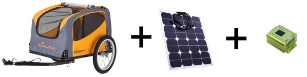

Post by solarEbike » Jun 14 2018 12:20am
John and Cecil wrote:
Jun 13 2018 10:23pm
I wouldn't mind a small cargo trailer with a solar panel top, and maybe a small sunscreen for Cecil made with a small solar panel.
Go for it!
I would add a coroplast panel to keep the PV panel from flexing too much and just attach it with zip ties. If you're in the US, $216 plus tax and shipping for trailer, solar panel and boost charge controller. I don't vouch for any of these personally but that should be a good starting point.

BTW, I love the solar camper trailer concept. There's a guy with a camper in this year's The Sun Trip. I'm betting he's the envy of the group when it's time to set up and strike camp every day.
I tried to design a pop-up tent concept that used my trailer as a support structure but just couldn't get it lighter than my 2.7 lb (1.2 kg) 1.5 person backpacking tent.
I also have a design constraint that my entire rig has to be able to fly with me on a commercial flight. That eliminated some other range-extending possibilities like this velomobile I test-rode in Holland two years ago.
