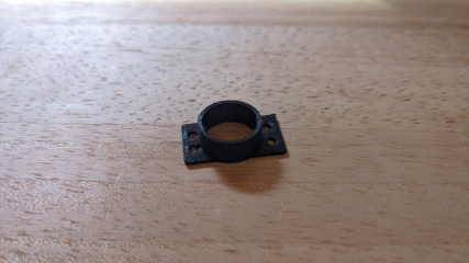

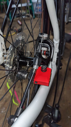

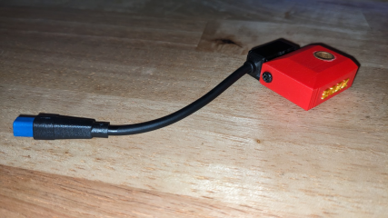

I wasn't happy with the Bafang speed sensor bracket:1783259475842.png
I started looking for other 3D models having a chainstay mount. Printed several, either they weren't robust enough or a poor fit for my bike.

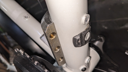

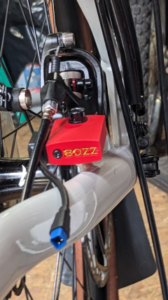

I noticed the brake caliper mount on my chainstay has a substantial bolt and mounting location that I can use. It positions the speed sensor directly in front of the wheel speed magnet. After printing several and adjusting fit I'm nearly there.

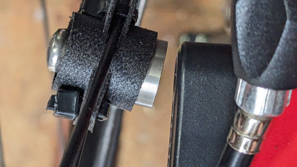

Mounted on the bike:
Tight clearance to the magnet on the wheel:
The final version will use a 5mm x 7mm x 5mm ID sleeve bearing so that the bolt continues to have full clamping force onto the caliper but the printed piece sets on a 15x15mm square and is locked in from the top with the bolt head and a flat washer.
Found a useful part on makerworld that lets you surround the magnet and hold it in position on the spokes. Printed two in carbon fiber and sandwiched the magnet between them with zipties.
I will post a picture of the final piece and fit up and try to publish the print files (although they may only ever work for my bicycle).

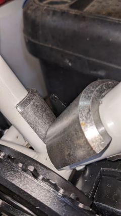

Going to try a novel solution for a torque arm bracket. I don't love the hose-clamped bendable steel brackets very much.
Let's see if I can actually pull this off. I've purchased a second Bafang "Middrive Triangle Torque Plate". This thing: 1783260533989.png
If you put two of these together, the grooves in them lock together. I "think" I can index the second one so that it has one armature bolted to the motor with the second (will get longer bolts) and it's other armature hole ends up positioned directly parallel to the seat tube.
I picked up some UTV weldable roll bar clamps in the correct diameters for my downtube and seattube.
Like these:

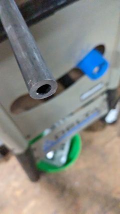

And I picked up some 9/16" DOM. I think I can create a double clamp that holds onto both the seattube and downtube near the bottom bracket. The DOM tube would connect the two weldable clamps, providing an immovable structure.
Then I can affix the clocked/indexed secondary ring directly to the assembly.
I'm a capable MIG welder but might tap the hillbilly magicians I know with better skills and equipment to get a good finish weld on it for a better looking end result.
Please poke holes?
I finished/finalized the design of an alternate wheel speed sensor bracket for the Bafang kit. This one mechanically locks onto the square brake caliper bracket. It features a sleeve bearing to enable full clamping force onto the caliper while holding down the sensor bracket. I will print a second one and keep it in my toolkit for any long rides.
Began working on a part that will secure the position of the BBSHD in the bottom bracket (I hope).
Got ahold of two UTV roll bar clamps. One has the perfect ID for the downtube. The one for the seattube was too tight. I took it to my neighbor who has a 60 year old South Bend Lathe. He turned it down to the proper size for me. Now they "fit" the two tubes.
I plan to connect the 2 pieces with some 9/16" DOM, am waiting for a tube notcher I bought to arrive before I can start.
I will likely double up the tubing, one on top of the other if space permits.
Hopefully you can see from the first pic the armature sticking up from the bafang triangle mount ring, I've got a second ring overlapping the first and I think I can build out from the UTV mount on the seat tube so that I bolt the motor directly to it, preventing spin.
I will have to shave the bosses on the downtube with a grinder and touch them up for the larger roll bar clamp to fit. Not thrilled to do that but I can live with it.

Got error 21 on the first test ride. Adjusted the position of the wheel speed sensor, another mm closer to the magnet and all is good now.

This AWOL geometry is nothing like it started life with. It had drop bars, now has swept upright. It had a 70mm stem, now has 35mm and 2.5" riser. The new seatpost adds about 18mm of layback. I find it bizarre I could (had to) change so many things to make it right for my body and riding style.
Random updates:
* Ran into a snag. Varstrom is swapping my battery. Basically the wrong battery. Long story, not worth the detail, but I have to give Varstrom kudos for how they are handling it. It was their mistake but they stepped up. I think a domestic vendor would have had fewer communication delays but Varstrom had stock when nobody else did, and like I said they are stepping up.
* Getting comfortable with the bike past few days, really like the BBSHD. I was concerned about the lack of torque sensing but had experience with prior Bafang products. The PAS can be set up to 9 intervals, enough to prevent too much power.
* Use on the hills (steep here) is giving me practice with gear changes and PAS levels. I can mostly keep the same gear engaged, feather the throttle for small resistance or set higher PAS when needed.
* Gear changes are smooth without a gear sensor. The engine cutout is used but doesn't seem to make a difference. I'm sure it would under the right load. PAS is toggled more than gears though so not too frequent.
