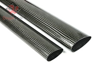

If you want to further improve it; try aerofoil, elliptical tubing for the safety frame:
Like this:
Or this:
Round Bar/pipe Cd: ~1.17
Aero teardrop (wing) shape Cd: 0.045 (26X lower than round)
You will notice a decrease in prop noise too. (see: Blade passing Stator noise)

Thank you for your interest! I thought about adding eliptical shape stirofoam around the prop ring but because I keep those semi circles that form the ring in a bag for transport, something too soft won't last. Plus the net is on the ring so it would have to pass through those eliptical shapes somehow.
But I saw that some companies make eliptical shaped rings now.
