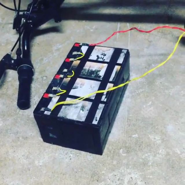

Good evening all,
I just wanted to give an update on my project. I found out that the whole kit is still functional but the battery proved to be a lil bit too heavy for the bike that it toppled over when I rested the bike on its kickstand. Here is a video before the incident.
Shortly after that, I invested on a new 1000w homcom rear hub which is similar to the kit I was tinkering with. I also bought a v power 48v 20ah lifepo4 this time around which actually might be overkill for the 7mile daily work commute. I haven't decided on a bike to install the kit into but I'm thinking of selling the kit with battery to upgrade to a fat tire kit and smaller battery... or even a bafang bbs02...

I just wanted to give an update on my project. I found out that the whole kit is still functional but the battery proved to be a lil bit too heavy for the bike that it toppled over when I rested the bike on its kickstand....
Even with a double leg vertical axis centerstand I have to be careful, especially to keep idots away from the bike while charging at work. One person decided to move it while plugged in and ripped the cord out of the wall receptacle. Good thing I checked it on my break to resume charging or it would have been a tough pedal of pain and an ordeal to make it home. :x
yikes! i'm glad nothing got damaged...
