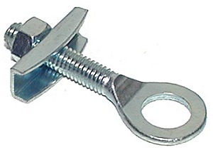

I had a motorcycle once that on two occasions had the rear axle nuts loosen. I was concerned, but by DOT rules, they had pull-retainers that did two things, they were like a large fat washer that prevented the axle from slipping out of the drop-outs, and they also had threaded studs pointing back upon which nuts would be tightened to tension the chain and align the axle. Something like this:
Once properly set, the big axle nuts could be tightened. I drilled a small hole in the tip of the axle so I could insert a cotter pin. This way if the nuts came loose again, at least I wouldn't lose the axle nuts onto the road. I would feel it was riding funny, and just pull over to tighten them.
Here's a pic of a scooter axle-retainer. Each application may have some custom dimensions required, but something like this would be cheap and easy to make. Personally my concern is not so much that the axle nuts might loosen on occasion, but that as the OP stated, the axle might fall out at speed.
