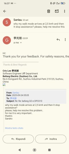

I wrote to baffang to complain about the walk mode, which no longer supports speeds above 2.5 km/h.
After asking me for the HW and SW versions of the controller and display, they replied that the speed is limited to 2.5 km/h for safety reasons.
I was irritated by the implicit falsity of this response, coming from a manufacturer that has made free power and free speed its flagship for all these years...
and I pointed out that with the DPC010 display, where you can't set the walk mode to 6 km/h, you can instead set the maximum speed to 40 km/h or 50 km/h.
After my reply, they again asked me for the serial number and SW version of the display.
