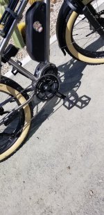

Eye catching, but discreet. Perfect for an undercover Godzilla bike that can't afford paint.

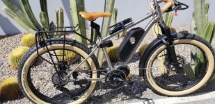

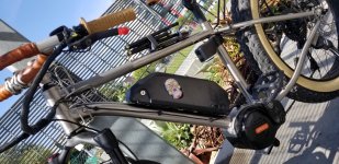

Low down and dirty ...
Present iteration
Love me some M620 w/ Archon X1 !!! rrrr, rrrrR, rrRRR, RRRRRR - zoom !!!
