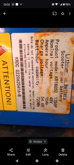

Hi all I have a 48v electric scooter...use mostly every day on a journey to my dad's .what takes 6 minutes so 12 ISH minutes a day ...it is a emoko hdv3...Iv replacement the controller.before .as gets blew ...it's been fine for months...and all of a sudden got to my dad's off a full charge .on way back cuts outs ...and as soon as I put the charger in comes on ...take the charger back off .run it off the floor .lasted 15 seconds.then cuts out again....won't turn on .till I put the charger back in it . Can anybody help me please .....will upload a pic of battery..specs ... anything I can do ...is it the BMS...or bad pack ......any help would be Verry much appreciated please

Well opened the pack up today......as it stopped holding charge..as soon as I took charger out.voltage would drop to 0...so bypassed the BMS . voltage went up to 53.7.....and stays at that . Will test tomorrow.and see if it runs below 51v ......if it do I will replace BMS .if not I will get a cheap Chinese pack ..of internet .this pack says it's 13s6p...as I counted the cells thire is 65 ..in 13 groups of 5 ...so is it a 13s5p thave just labeled it wrong 🤔
Measure each group of 5 cells individually before and after it shuts down. You'll probably find one group much lower than the rest. (Max would be around 4.2 volts when charging and probably ~4.0 at rest. Shutdown would probably be anything below 3.0 volts.)
Probably just try a find a new pack . For it as . tested today went down past 50v ..but got home at a snail pace 8mph ....so don't no weather to run thr batt flatt ...and give a good charge see if that helps ...but because IV bypassed BMS .will it cut off at saty cut off ..🤔
IV stoped using it now ...but can't find a replacement battery...the size this one is ...plus's it says it's 13S6P....but it only has 5 battery s. In 13 rows.....so do that mean it's a 13S5P....I can't find a battery that's long like this one

The only pic I have if my battery...is of the BMS .....but u can see. It has 5 rows of batteries laying flat..13 sets of 5 .....and it is labeled 13s6p....but surely it's a 5p..at as 5 batterys in each group....I don't no whqt cells that are .. nothing on them except 18650 3.6v

It would be interesting to hear what they say since there are no cells made that can meet the fake specs in the listing. Sorry, I can’t provide any suggestions that are in that price range,
based on your description and pic, it’s a 48v 12.5Ah pack, can’t tell what brand of cells.
S
ok it's a cheap pack anyway... Chinese that lie ...as on the sticker says 15ah...and 13S6P.. but it's definitely a 13S5P....and no brand on cells just pink
