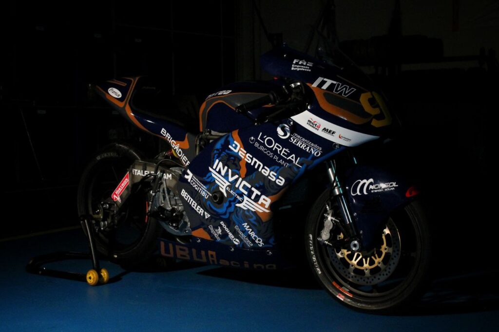

Building an electric racing motorbike from scratch
Peak power: 41kW, 140Nm (I think all ME1616 datasheets are overrated).
Top speed: 180km/h
Battery: 28s 20p (117.6V, 90Ah)
I'm currently working on a dyno to focus on field-weakening to achieve more speed.
Regards.

Hahaha, unfortunatelly, when I started the project AI wasn't as developed as now so, there is only hard work behind, hours and hours of research, test, you know.
Regards.

Any details on the battery?

Configuration: 28s 20p
Cells: Molicel P45B
Voltage: 117.6V (full)
Capacity: 90Ah
Cells: 560
Busbars cutted by laser and with nickel tabs of 0.15mm to be able to make spot welding. 4480 welds made.
Able to discharge 900A continuously.
Regards

Your battery is basically the same specs as mine (28s 30p LG MH1, same total voltage and capacity, 840 cell, capable of 300 amps continuous), it's interesting to see the two applications for what is essentially the same power source. Short-range speed vs conventional commuter. Obviously your cells have 3x the power output, but that's what's necessary if you wanna go fast!
So nickel all the way? Or any copper in the mix?
Ah, I see you're using the nickel tab with copper bus plates. I found the only way this works successfully is if you solder the nickel inserts in place, which is a lot of work for a DIYer. Also, unless there's some thin copper linking the cell to the plate [aka nickel-copper-sandwich(TM)] the nickel can't handle the current.
