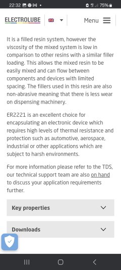

Is it good idea to use epoxy resin for controller potting for good waterproof and heat dissipation?
I found this epoxy, apparently one of the best on the market. What do you reckon.
Can I pour this substance into the controller, mosfets, capacitors etc ?
Epoxy Resin ER2221
Epoxy Resin ER2222

Grin fully epoxy pots their Phaserunner controllers. In their discussion of past models they mention this:
" In early 2019 we switched this design to using a stamped metal shell instead of a bare resin finish so that we could switch to a lower durometer potting resin that would put less thermal stress on the components. "
So if Grin's experience is meaningful, I'd be looking for a lower durometer epoxy or other low durometer potting compound. Note that they said "resin". That might very well refer to an epoxy. But it may not. I'm pretty sure the earlier models were potted with epoxy. There seem to be a lot of potting compounds available online with datasheets. All that said, potting the controller may be overkill and the epoxy isn't exactly cheap. Maybe just seal the box up really well and use some silicone seal at joints and mating surfaces.

So I got curious and found this reply to exactly that question back in 2017. Interestingly, he did not actually answer the direct question.
"I wouldn't worry too much about electrical insulation, they're all pretty good in that regards unless you are talking something with metal filler (or perhaps you are still dealing with 700+ volts?!). In the end what became the driving priority for our resin selection was very low mixed viscosity so that we could fill the phaserunner molds without air entrapment, and a reasonably low cured hardness spec so that the epoxy wouldn't be brittle in cold weather or stress the internal electronics too much. Thermal conductivity wasn't much of a concern since all the heat flow from the FETs is directly through the aluminum heatsink that is directly exposed to outside air and making physical contact to the metal bike frame."

Ok. Yes, thanks for that update. Its very important. Im thinking more about overheating than waterproofing.
