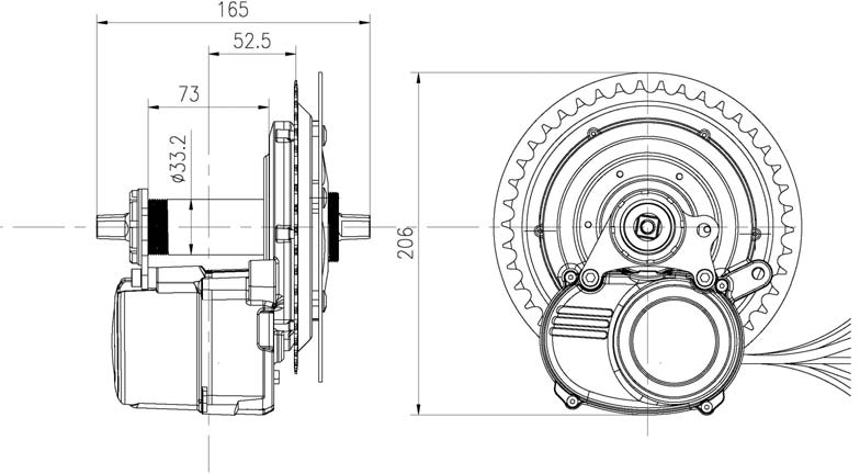

I'm doing a build with my daughter and we checked a few motor templates against the BB area of our bike to see what would fit on the bike. BBSHD and TDSZ were too large (bike has wider chain stays). I am assuming the toseven motors are also too large. I know we can fit a BBS02 with perhaps a little shimming and maintain an okay chainline, maybe. I am pretty sure a Photon will squeeze right in, no shimming required, and have a great chainline. I would like to use a small chainring 30-36 as we plan on using the bike to climb trails in the eastern rockies.
My question is with regard to the reliability of the Photon. In some of the searches I've done on this motor, there seems to be quite a few indications that this motor is not as reliable as the BBS02. With regard to the fact that we plan on using the motor to climb quite a bit, I would be interested to know if reports of reliability or lack of can be confirmed by users of the community in general.
I will add that we like the idea of a torque sensor for trail riding. The idea of a motor for this build is to get to places "up high" or far away, not to go very fast. Would the PHOTON work if we use a smaller chainring to keep it a at lower speeds on hill climbs?
Thanks for your opinions

The bike is a 2014 Transition bandit. Size large. 73 BSA BB. full suspension with decent but not extensive room in triangle for battery. 2x10 chainring. 27.5 tires. Bike weighs +/- 30 lbs.

Presuming the given small chainring 30-36 desire, frame chain stay issue, and chain line, IMO at this time only the CYC Photon fits. Good for extended steep hill climbs - err, no, seems not, especially when poking along on a unpaved route or trail. As reliable as the revised trued & true Bafang BBS02, the production numbers aren't in the same league, but I doubt it.
Like @Epithemeus, I've good success on my hills, but I don't have long slow climbs to overcome. The rolling weight (as in a lack of it) may make all the difference.
Your could gander the Toseven DM02 dimensions, but I think they're in the same ballpark as the TSZD2, and AFAIK has the same chainring / chainline compromises as the Bafang and Tongsheng:
IMO the key point is do you want a CYC torque sensor so it rides like a real bike, or do you want a BBS PAS that doesn't? Pretty simple. Don't believe all the reports of Photon heat issues... at least if you are a pedaler of a bike and not a throttle jockey.

Seriously, Photon really is your best choice. The Transition doesn't have a lot of room by the chainstays, which rules out the more common and cheaper motors. Of those that will fit, still completely stuff up the chainline since the smaller chainrings can't be dished inboard due to the size of the gear casing.

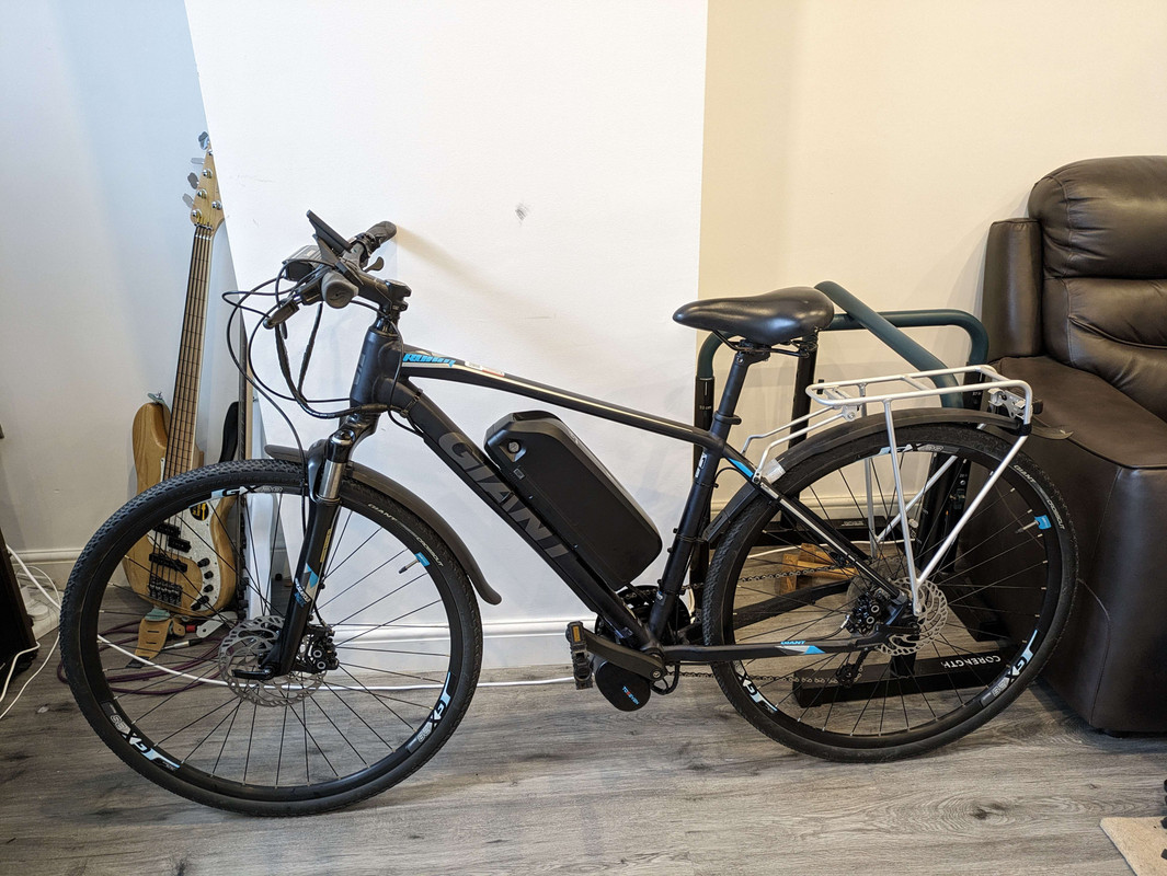

I've had a Photon on my 1x Boost hardtail since April 2023, and it has been great. A couple of minor issues but nothing serious or showstopping and which CYC have mostly addressed with later updates. CYC designed these motors for modern MTBs and they got that exactly right. My conversion is way better than any OTS hardtail ebike you can buy. No artificial 32kph speed restrictions, for example (in NZ we - currently - have no speed restrictions for ebikes). More power and torque, and the ability to also use throttle for quick assists. Conversion feels solid, professional and does not creak or rattle. Very tidy installation.
Bike regularly gets used on >25% grades with no problems other than the front wheel barely touching the ground and steering in a mostly advisory capacity. The 34T chainring gives perfect chainline for me, ymmv. This bike will climb anything, and do it all day if you use sensible power and don't hurry.
The ability to easily configure the motor via Bluetooth and from the app should not be ignored, it is a big deal.
I get about 60km from a 520Wh battery with lower assist levels. Bike with motor and battery weighs about 21kg I think.
CYC seem to be committed to their products and their team is great to deal with.
