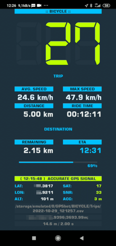

I wonder why we even need a speed sensor, since the wiring and installation could be simplified and tidier without it. When a GPS costs <$40NZD with its own case, charging port, controls, firmware, battery and display I would have thought it feasible to build GPS functionality into the control or display for cheaper than all the external hardware associated with the speed sensor.
Because non-military GPS for average joe is not as reliable as speed sensor. Some time ago I wrote an app for android using GPS and during testing I had noticed a lot of weird readouts especially if you go under the bridge or next to high buildings. Accuracy is never below 3 meters. Often around 10m.
My app in action
Would that matter for this application? I personally doubt it. And GPS could have a LOT of advantages over a speed sensor.
Calculated speed tends to fluctuate in some situations a lot. For example in one second you see 15km/h , then 9km/h and in third second 20km/h. With speed sensor measuring rotation speed of your wheel this is not possible. Calculated speed is stable as rock. No weird fluctuations.
FWIW Garmin has GPS's that connect to wireless wheel sensors and use long baseline GNSS to calibrate the wheel sensor so best of everything, very accurate, and can log that along with all the other fun stuff. Mine also has a wireless pedal cadence sensor, temperature sensor and heart rate monitor all of which get logged and readily display in google earth an other mapping applications...

Garmin also interacts with some e-bike motor systems, such as Shimano.
I was gonna add multi-band GNSS, but ya kinda beat me to it, and I dunno how global or country based the newer GNSS (Global Navigation Satellite System) technologies are.
I've tried out my new Garmin Ege under heavily leafed-out tree canopy rides, and it was steady and stable.
Newer GNSS, even consumer units, pretty much all utilize Satellite-based augmentation systems (SBAS), e.g. WAAS in north america, that cover most of the land areas in the northern hemisphere... WAAS is specified to bring accuracy to <3m but typically brings a consumer GNSS to <1m
But that's just for a given sample - averaging samples over time can give extremely high accuracy positions, better than 1cm in consumer units and sub-millimeter in the professional market
Phones have lousy GNSS antennas but benefit from having augmentation from the cellular network - still hard to trust them due to the lousy antennas
A decent GNSS will calculate speed based on the difference between two position samples and typically any error between two samples that have the same satellite view will change very little so speed is accurate in those cases - unfortunately if a satellite that's important to the solution gets dropped then the error before and after can change enough to put a burp in the speed calculation... most units will "filter" out the burps though
The wheel sensor/GNSS combo is ideal for speed sensing though - usually the error in a wheel speed sensor is primarily due to the error in wheel circumference however like averaging position over a long time averaging the GNSS distance the wheel turns over a long time will give a very accurate wheel circumference and similarly give very accurate wheel speeds - much better than the resolution of the speed displayed on most GNSS's...

We are in the process of setting up SouthPAN with Australia, because it would be economically stupid to not do something, the benefits are just too great to ignore. Early days though.
But that isn't going to (probably) ever be available in a <USD$30 consumer cycling GPS ex China or Hongkong, and nor is it necessary. However it astonishes me that the GPS I just got has GPS+BEIDOU+GLONASS+GALILEO+QZSS capability. We're a long way from a military GPS being the size of a back pack, with power requirements and training to match.
The requirements to just give a general indication of speed for cycling are pretty low, and many bikes don't even display speed at all.
BTW in NZ almost all the commercially manufactured imported bikes from the major manufacturers are all speed limited at 25 or 32kph and 250W. This is crazy because in NZ the power limit is 300W and we have no speed limit specifically for bikes at all.
You aren't going to vary appreciably from those speeds if the GPS glitches a little, your own mass will smooth your actual speed out even if the GPS didn't do that already. And even a 5% error would be of little consequence - I can't even see a fraction of that when comparing my speed sensor output to what my GPS displays.
Yeah we setup C-band correction in the very early days (mid-90's) and did our own high precision L-band a bit later... the typical
SBAS system doesn't cost much to setup and operate so it's a bit surprising that OZ/NZ has been dragging it's feet
I agree - for me speed on a display just isn't important at all on a bike, don't pay attention to it. I do like taking my gps logs and displaying them in google earth and when you pull up the "show elevation profile" it shows all sorts of things in the graph including speed, heart rate, temperature, pedal cadence, etc.
I was trying to correlate my heart rate with speed, pedal cadence or whatever and really couldn't find much correlation - after really pouring over the google earth profiles I finally figured out that my highest heart rates were when I was crossing busy streets! LOL... I don't ride on the streets but the multi-use trails out here do cross some busy ones where cars are often going 55mph or more...
