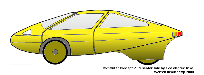

For a tadpole, side-by-side seems best. More fun for the passenger too.
For a delta, optional FWD or AWD is very possible using the Enertrac motors.
I'm enamored of leaners (so cool) and wary of flipping a non-leaning trike...

I thought about this.
http://recumbents.com/wisil/e-bent/TandemE-Trike.htm
This vehicle has to go fast enough to not be a rolling road block. A big electric motor is certainly the answer.
The toughest part is licensing. You know that even if you build it with pedals, if it has a motor it won't be street legal. A vehicle with 3 wheels is categorized as a motorcycle though, so the way around it is that you have to start with a vehicle that can be licensed as a motorcycle. Maybe one of the Chinese high power but still cheap e-scooters. You cannot use any bicycles suspension or braking components. It has to have brake lights, turn signals and headlights.
Already you are well on your way to making a heavy vehicle, but probably it can be built under 300 lbs.
-Warren.

Lots of "reverse trikes" out there and a few electric ones..... 2 passenger side by side .. electric ? ... back to Chipman
I was thinking along the lines of side X side seating might be considered a CAR by the idiot govt bunch. MIGHT need crash testing ($$$$) and all sorts of weird places to throw money.
A front-rear seating, would be MUCH more like a Motorcycle. I also was thinking, build the first one, get it licensed as "experimental", which should be really easy, then, as more are built, do the "Title" steps.
If several people worked on getting the first one put together, it would provide real world road testing. Then, they could all build another, and do the same "experimental" all in other states. This is the easiest way, I think, to get started.
