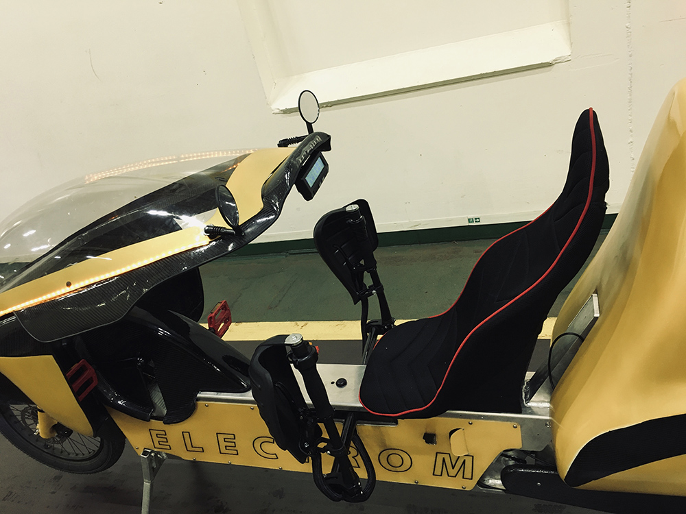

Check out how the Electrom handles. It is not o nly a recumbent, but a LWB recumbent.
https://youtu.be/E73FWv2EgaM (See 7:43 into video)
https://youtu.be/7QcXxJmJgl4 (notice how well it makes the harpin turns)

ebike4healthandfitness said:
Check out how the Electrom handles. It is not only a recumbent, but a LWB recumbent.
I can find you video of someone making unicycling look easy, too.
[youtube]RkppaV-gQXU[/youtube]
Some of us have direct experience riding LWB recumbents, and we know what they're like by actually trying them. Maybe you should accumulate some real world experience before you make declarations.

Let me guess this was one of the zero trail very low flop recumbents :lol:
Tell me Chalo which LWB recumbent(s) did you ride?

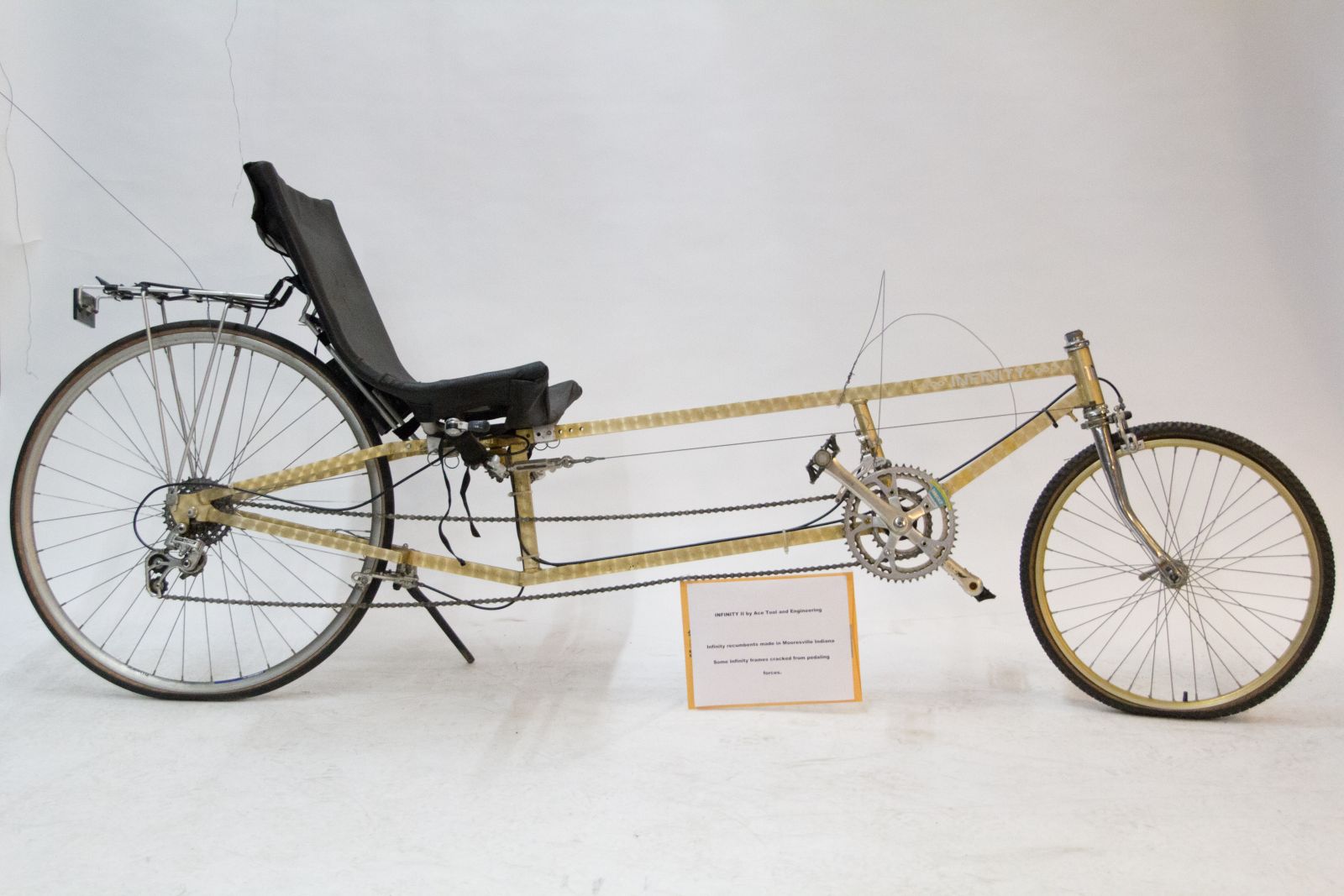

Tell me Chalo which recumbent(s) did you ride?
The very first one I tried, back in the '80s, I was super excited to ride and predisposed to like. In less than a minute it horrified me instead. Infinity II LWB:
In the decades since then, I've tried Tour Easy and Vision LWB models, and BikeE, Trek, and Cannondale CLWB models. Not one of them behaves as well as the worst upright bikes I've ever ridden.
You can see for yourself if you only try them.

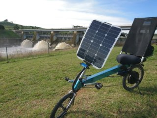

So many questions like how would the wires be handles on a spinning wheel and how much weight added to the wheels and most importantly how much of a wind sail would those panels. A trailer would great or a sun shade for the rider.
Another function for fairings would be a place to mount a flexible solar panel.
Apparently this has even been done for bicycle wheels as well.
Notice the second to last picture claims 40W for the single wheel.

Looks like an early and scary adoption of drive-by-wire.

A few things standout looking at that bike.
1. Headtube angle is much steeper than the one seen on the Electrom. Forks looks to have a good amount of offset as well. Definitely looks to have less flop and much less trail than the Electrom.
2. Handlebars on the Infinity II are in a really awkward position. I have a hard time believing a person will have good fine motor control with the grips positioned in such an odd way. In contrast, the Electrom has a a great ergonomic positioning of it's grips!
3. The Infinity II cables (for steering) look really thin. I can see that hurting (due to stretch and play of the cable) the already bad situation with the very awkward handlebar positioning. The Electrom advertises a rather thick 3/16" cable which is going to dramatically reduce play and make the great handlebar position work even better.
4. The Infinity II frame looks a great deal more flexible than the Electrom's frame. This flexiness only makes the previous mentioned issues for Infinity Ii even worse and adds even more problems not even mentioned yet.
The website for those solar wheels is motorwavegroup.com.
Here is a YouTube video of a bike using the wheels:
https://youtu.be/wVW9pYga7F4
And yeah crosswinds will be an issue, but perhaps this could be handled adequately by a steering damper?
The first e-bike I ever made had a PV array on both front wheel and frame, and I made a device called a "slip ring" to carry electricity from the wheel array to the charge controller.
The Achilles heel of any such setup is that any cells with a shadow on them bring down the performance of all the other cells in series, as if they were also shaded.

My Ryan Vanguard looks just like Chalo's Infinity to the casual observer. It's about 30 years old; since then the line has changed hands and is now Longbikes in Colorado, and the Vanguard-ish model is about the same but has a little higher "bottom bracket". Probably the leading bicycle of this type, in terms of sales, is made by Linear.
Same straight, under seat handlebars, which I like well enough that I retrofitted the same on my new recumbent, removing the factory above seat steering. The linkage is a rod rather than wires, but I think I may be slightly envious - I assume the wires run closer to the frame than my rods.
The head tube angle is normal for a bicycle; the very shallow head tube angles commonly seen on above-seat steering designs are not because it's a good thing, but because that angle is dictated by the need for the handlebars to span that front to back distance. When designers give up on that and use a linkage rod or wires, the fork angle goes back to normal.
Frame flex is to some degree held out as an advantage that compensates for lack of suspension. I don't really buy that, myself - real suspension is much better - but anyway it isn't a noticeable issue on the Vanguard.
I don't have a lot of direct experience with this, but it's better info than you're going to get from someone looking at a picture and speculating about poorly understood design principles: Recumbents are designed and tested and they're typically going to be pretty rideable - for someone. Someone else who ends up sitting in a different place on the bicycle because of different leg length, or someone who is otherwise physically quite different from the test subjects, is likely to find it riding quite different.

I have a solar panel in front of my BikeE CT which also acts as a fairing of sorts:
Somewhat ironically, at least anecdotally, the energy efficiency gained from the panel being in-front and deflecting the wind is greater than what I typically gain from Solar charging while riding. Once stopped/parked the 40W panel with good orientation can get me a solid 15W of continuous charging through my crappy DC-DC converter setup.
I plan to do the same to another BikeE (AT) I've just finished converting also. Details here:
https://endless-sphere.com/forums/viewtopic.php?f=6&t=57751&start=325#p1694224
I also plan on converting a Giant Revive and may do the same with a solar panel on that also. I've found the largest practical flexible panel I can fit is around 40-50W before it becomes too cumbersome.
It also generates a heck of a lot of passing by comments also. Even though the bike above has over 20000km riding around Canberra, I still get comments almost every time I ride it which is at least 3-4 times a week typically.
Do you think you're losing a lot in the conversion, or is the panel just not putting out much more than 15W?
