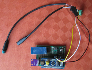

No problem in principle, if the M510 has an NTC on the motor windings. But I have to identify the ADC input pin for that. Any idea which pin carries the NTC information on the PCB connector? I guesss this is the right one, but which of the six pins? :unsure:
It looks like Bafang changed numbering of those pins or maybe flipped the connector on PCB. On M560RS the numbering is different. I do not know if the connector on your picture is flipped or if they just changed the numbering.
Regarding the connector locking tab orientating here are the pins for the 20K NTC Thermistor. The pins on the thermistor leads connector should be the same for all the motors in regard of the locking tab location. You have to check where the tab is to find out the pins (but if you have the motor just see where the leads are connected).
By the way, for same reason Bafang uses wrong numbering for the pins. The 1st pins is indicated on the connector with an arrow and correct numbering order described in the connector manufacturer documentation (and they follow the common numbering order for such connectors), but Bafang numbered those pins differently on the PCB for some reason.
This is really strange. There are only 3 pins connected on my PCB. GND, +5V and one signal. Three pads (1,2+4) have no traces on the PCB.
I followed the trace via some ferrite balls and resistors to pin PC4, which is ADC channel 14. So I can implement the temperature reading now.
I do not know which pin is for signal and which pin is for ground on the Bafang PCB. I only know which pins are for the thermistor. There are only 2 wires connected to 2 pins on that connector. 5V pin is not used, it is there for nothing (or maybe to trigger an error in case of user connected PAS sensor to the temperature sensor receptacle). Just signal and GND are used on that temperature sensor connector.
On the LUNA controller the pin #3 (from you picture) is connected to 3.3V voltage divider circuit (the thermistor is part of the voltage divider circuit) and to MCU through some resistors. The pin #5 (from you picture) connected to GND. On the Bafang controller it might be swapped and operate with different voltage, but I do not know details about it.
Hm, strange. The voltage on this pin does't change with the temperature. The pin PA4 changes. But that pin is also the one that reads the on/off button. So it has a dual function?! I can't really believe it, because the measured value also changes slightly with the battery voltage, so it's actually unsuitable for temperature measurement?! Maybe it is just a temperature drift of the resistors on PA4? :unsure:
Or this is a dual safety function, the controller switches off on low battery and on overheat?!
