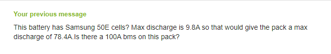

How does this battery look?
The cells are good, but unfortunately the total discharge current isn’t sufficient to supply the controller and motor.
The 50E cells can discharge 9.8 A. So with 8 parallel groups using those cells, 8 x 9.8A is only 78.4A, while the controller is 100A.
Thanks,should not have a 100a bms then too i guess.
