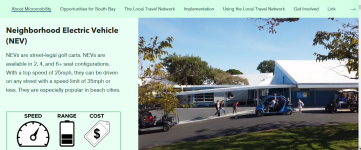

According to this parts of Southern California would like to have Neighborhood electric vehicles in bicycle lanes:
A neighborhood electric vehicle is a much faster than that 500w "ebike vehicle" used in London I linked. Whereas the London vehicle has it motor cut off at 15.5 mph, a Neighborhood electric vehicle is capable of 25 mph.
Very interesting road use proposal.
However, nowhere in the text is there a mention of NEV's being allowed to use dedicated bicycle lanes.
The maps show appropriate lower speed roads where NEV's can be used.
BTW . . . the fun thing about NEV's is they use common "off the shelf" motors and controllers which are easy to upgrade or reprogram for better performance.
Oh yes there is:
And prior to this they labeled NEV as micro mobility:
See that NEV in the upper right hand corner of the picture above depicting various types of micromobility.
They also listed NEV under micromobility here as well:
