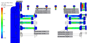

The FEA results came out excellent on this design with a fairly good FoS across the board. The mounts and housing show that they can easily withstand a 20G frontal loading (with a 28kg battery load) so that should somewhat offset some of the welding weak points.
The 0.2 appears to be a singularity on an external corner on the perimeter of a nut so it can be discounted.

Lots of things going on that have taken some focus off the project. I did however get all of the FEA completed for the battery housing and sent the files off to the mill. I got an email back from them yesterday confirming that the parts had been made and shipped... they sent a "proof of life" (below) photo which was amazing to see!
I've spent a fair few late nights over the last few months putting the engineering report together for the certification as this should make the process a bit more straight forward. All of the load cases have now been done and the box + mounts are standing up to the crash test simulations. The SF looks acceptable for all critical locations, and the stress on the bolts is well within yield for class 12.9 bolts.

Some FEA highlights:
20G Frontal Impact
15G Side Impact
10G Rollover

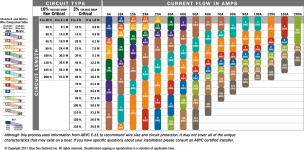

Random question to everyone following the build, I’ve been trying to find some high current plugs for the battery outputs. I have an SB350 Anderson plug but it’s massive, and there aren’t any good waterproof panel mount sockets for these so don’t really want to use it.
Can anyone suggest a smaller panel mount plug/socket solution that can carry up to 250A? It needs to be compatible with 00 (70mm^2) cable.
Well, the SB175 is UL1977 rated for 280A (table at end of post copied from Andersonpower), and IIRC it's about half the size of the SB350 (still pretty big). But the largest barrel contacts for it only go up to 1/0.
What kind of waterproofing are you after? WP the contacts from behind (wire entrance), or only protect them from in front (when not in use)? Or something else?
The 175's get used in trailers and other environmentally-exposed things, so I've seen some panelmount stuff for those that *ought* to be WP for that kind of usage (but dont' know if they really are).
Would a 3D printed part for the mount be an option? If so, the WP boot / cover / gasket can also be made by printing a mold to cast them with in silicone.

Why do you want to use 70mm².
I have a QS10kW Hub motor drawing 400A during acceleration from the 21S100Ah battery, all is wired with 35mm² and does not get hot during normal drive.
If I stay in the 10kW normal motor rating, my 7kWH battery cant deliver 150A for about 30 Minutes, and only therefore I have choosen the wire size.

Thanks Amberwolf. The reason I grabbed the SB360 is it was the only plug I could get to support 70mm^2 wire, which I've used through the HV system.
I'd like to put some kind of weather-proof panel mount socket/s on the top of the box so I can quickly disconnect it for maintenance. I really don't want to chance any water getting into the traction pack enclosure when I wash the bike or if it gets caught in the rain.
Incidentally I managed to track these down today and they are a very compelling size. This is the type of thing I had in mind, but was hoping to see what some others on the forum may have used:
If I stay in the 10kW normal motor rating, my 7kWH battery must deliver 150A for about 30 Minutes, and only therefore I have choosen the wire size.
Dominik, some of the references I used for wire sizing suggested 2/0 gauge (00) for anything over 200A, and most plugs rated for 250A use 70mm cable which is why I went this size. There's a lot of conflicting ratings and advice so I picked the most conservative one I could find for electric drives (I really should have just calculated it):
The motor tops out at ~220A burst - but you're right, it wont be drawing peak current for long periods. I'm sure thinner cables would probably support this with minimal heating, but I didn't have much practical experience with high current cable performance. I thought it's a negligible cost and weight increase for the short lengths from the battery pack to the motor controller so I don't mind oversizing it to minimise any introduced heat in the battery box. Most of the runs will be packed into enclosures and run close to electronics so it won't have much opportunity for convection cooling. It was a very conservative decision, and maybe not right one, but I already have all of the cables and crimps done for it.
I'm running much thinner wires for the charger and DC converter (6AWG for charging, 10AWG for DC converter).
