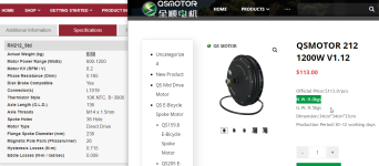

I came across the QS212 motor today. How does it compare with the Leaf? I found little information in the forum besides that thread. It is 1.6 kg heavier and doesn’t have temp sensor, but also has an M16 axle, is 212 mm with 26 poles and also very cheap.
In this Leaf thread, the 9C 212 is often used in the Grin Simulator to predict the thermal behavior of the Leaf because the Leaf doesn’t provide thermal results. However, the Crystalyte H3540 is available in the simulator, which has been thermally tested, even with Statorade. Isn’t this motor practically the same as the Leaf? The graphs are identical, right?
Also, in the simulator, the 9C HR212 appears more efficient and powerful. It runs a little hotter compared to the H3540 (assuming it is almost identical to the Leaf), but not by much. I thought the Leaf would perform better. Is there a catch?

It's a boat anchor compared to the leaf 1.5kw and RH212:
Efficiency seems unreal, is QS really honest about their efficiency?
But they also say this in the listing, which is very similar to the RH212:
I dunno man, i couldn't live with that weight! The leaf is plenty heavy already :O

The QS212 is lighter than the Leaf 1500w motor so I am not sure why you guys are saying it is heavy????
vladrov...I use the Crystalyte 35xx series of motors to estimate my Leaf temperature. It is the closest motor in the drop down menu to the Leaf. The RH212 is pretty close but there is enough difference in the design that it could be off more than the Crystalyte 35xx series.
QS212 1200W stated weight on webpage: 9 kg or 19.8 lbs
Leafbike 1500w stated weight on webpage: 7.35 kg or 16.2 lbs
RH212 1200W stated weight on webpage: 6.5 kg or 14.3 lbs
