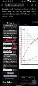

I played around with that but it is only the 5t. I think there is another motor roughly equivalent to the 4th maybe the Crystalyte 35 from Memory, but the simulator has only the 5t listed
Edit: re. Suggestions for controllers, I meant what people actually use for that level of performance. There are a lot of different controllers on the simulator
Show advanced > Set custom kV
For 4T - around 12.1, according to Leaf.
Thanks. Going from 58km/h to 68km/h goes from 1600w to 2600w, an extra 1000w for 10km/h gain. Hardly worth it usually.
Just bend over more when you want to go faster, and for the same watts. Pump up your tires for your speed runs for an extra 1/2kmh.
I pretty much always rode my leaf in a tucked / down low position on the lowest rolling resistance 2.2" tires i could buy.
The higher the RPM, the lower the air load, the better.

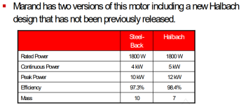

I agree. CSIRO had a ~97% efficient hub built in 2011. The cost to produce it was $10k and everything back then was done by hand.
I wonder what innovations were responsible for this level of efficiency? How hard would it be to implement these things?
Well first off, it's an axial flux motor.. these are typically more efficient than the radial motors we run..
The end turn losses are probably extremely minimal and it's also likely they used the highest grade materials they could get their hands on at the time.
Mass in in kg
It's a balls to the wall design!
There's a paper if you're interested in reading:
https://renew.org.au/wp-content/uploads/2018/12/marand_high_efficiency_motor.pdf
