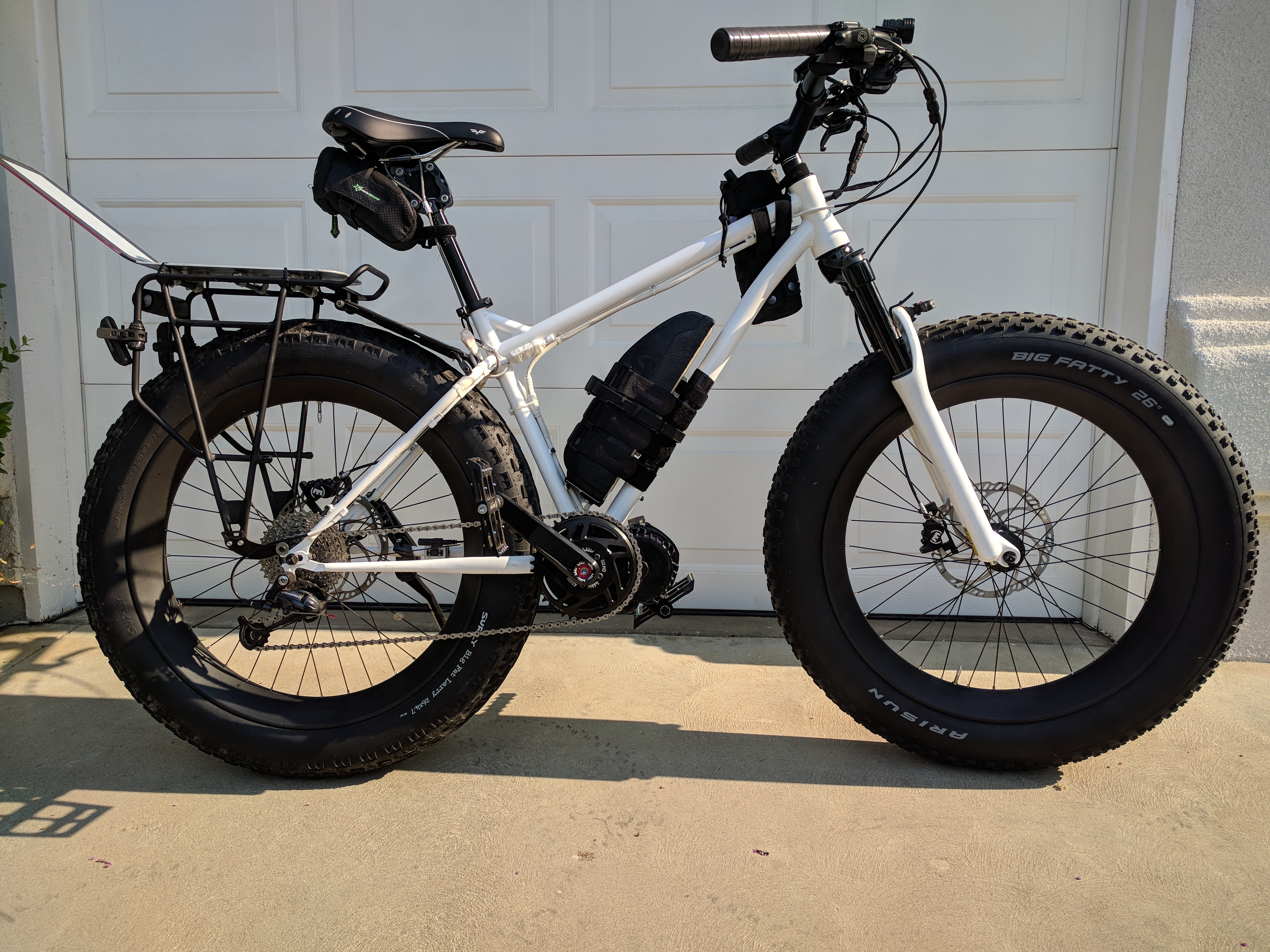

I built this cargo bike out of a Mongoose Envoy factory frame and fork. Besides that only kept the headset. Anyway, the rear wheel build uses a Hybrid 350 hub meant for Boost spacing. The Envoy uses 141mm spacing on the hub, and that oddball size is Boost using a standard quick release. So I bought the Boost version of the Hybrid, a set of QR end caps and it fits like a glove. You could do the same with the other sizes/versions of the hub.
Likewise the basic DT 350 in Big Ride (fat) width can do the same thing. For this bike, since the classic 350 has an alloy body, I bought the steel cassette body upgrade. Frame is a rescued and stripped/powder-coated Motobecane Lurch, and as you can see its QR.
I have put the 350 with steel cassette thru positively brutal singletrack climbs. Other steel cassette bodies are out there, but nothing has the ratchet advantage on the inside. Maybe a Phil Wood 5-pawl. But nobody would use one of those on an ebike.
I put a 32T ratchet into this bike when it was a street commuter/Costco Run bike. I very recently converted it completely to trails use (32T chainring on the front after this pic was taken). But the finer ratchets have been known to shred when used on singletrack. This thing is a monster so that strength reduction may bite me on the ass in the Lower Sierras where this thing will be getting its real workouts. I'd better add the original 18T ratchet to my tool kit just in case.
