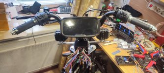

Контроллер был куплен EM-30s + ручки Z6, дисплей no name работает на 1 линии (импульсные пакеты)
Первое, чего я добился, это правильного подключения, сопряжения с контроллером, цветовая гамма фазных и холловских проводов отличается, что нормально для двигателя без названия.

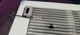

Можно ехать без вопросов, температура контроллера 35 градусов. Поднес датчик к панели посмотреть, датчик приклеен к радиатору.

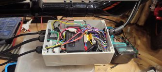

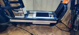

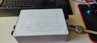

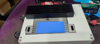

I put the controller in my feet, but it was behind me, under the seat, there was zero access...
I also added a temperature sensor, and the radiators are blown while driving. The box is IP68 plastic
I do not use connectors, only soldering, reliability is higher when shaking.

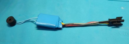

Good, working scheme.
Turn signals with sound.

Good, working scheme, I assembled it, (author AntonChip)

I've been wanting to make a temperature sensor in the engine for a long time, and now it's happened, I replaced the engine with a more powerful one, and it would be a sin not to install a sensor, I bought a different cable 3+6 wires.
In the ports, set the value (PA11- 53:Ext_temperatrue_MF52_103_B3380) And no problem, it works ))
Finished my scooter by summer.
On the side of the box is a switch for temperature, ecu or motor, very convenient.

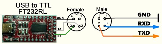

New option for connecting VOTOL to USB
USB Type-C to TTL on FT232RL
Works perfectly!
5 Volts no longer need to be connected to the board, it is powered by USB, only 3 wires, RX-TX and GND.
