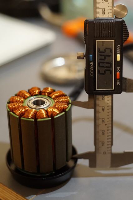

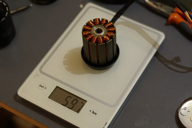

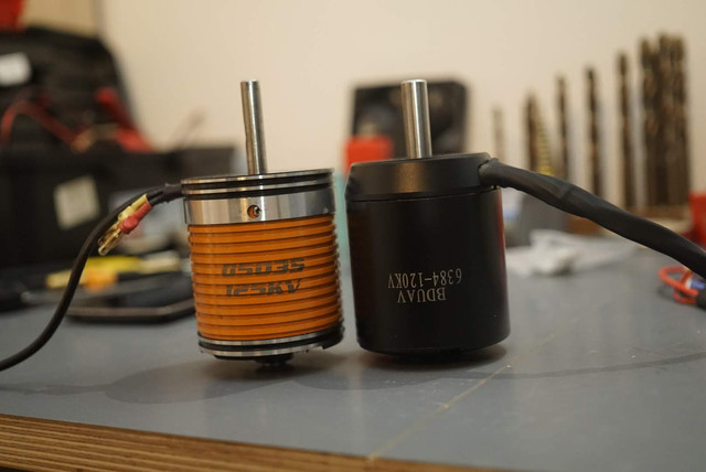

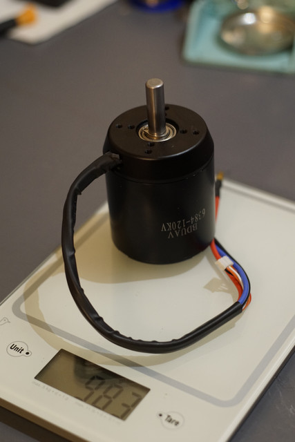

New toy time:
This puppy with chinese pedigree is very close in size to the orange D5035 but it's much heavier(~+250g) and at half the price! I wonder if it's more copper in there.. I didn't test it yet cuz i had a hell of a time enlarging the 8mm ID of 11t sprocket to 10mm as this motor's shaft.

Whoah i think we are going too far with the numbers here.. this motor is just a little bit longer than D5035. I expect it to be a little more torquier but i don't think it's stronger than Turnigy 6374. It would be too good to be true at half the price of Turnigy motors.
Still, i do think that a motor like this could be a good choice for cheap and light crank drive because it compensates for the lack of reduction.
I dont think i could measure realiably the lamination thickness, any tip ?

I think stator volume is probably a reasonable metric to compare motors (assuming other parameters are similar). Here are some rough stator dimensions from my motor spreadsheet. I didn't measure them myself, but I think they are in the ballpark. The Power (watts) numbers are the max burst (a few seconds) I have seen from my Turnigy wattmeter from all my rides. Note that I only use high power for short bursts (a few seconds), as I don't want to cook anything.
Turnigy 6354_________Dia: 50 Length: 25.6 Vol: 50 Pwr: 430
Turnigy D5035 Orange_Dia: 50 Length: 35.6 Vol: 70 Pwr: 557
Turnigy 6374_________Dia: 50 Length: 45.9 Vol: 90 Pwr: 655
Mystery 6384_________Dia: 53 Length: 50.5 Vol:111 Pwr: ???

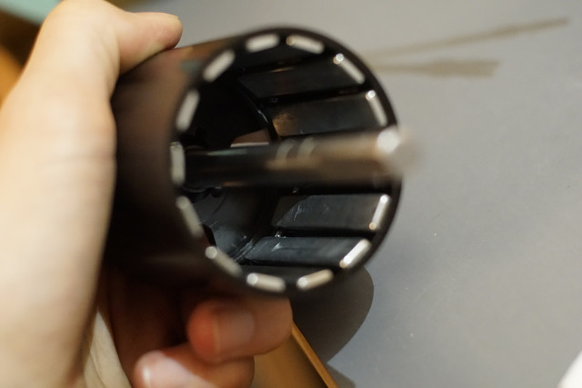

This motor has really the biggest stator of all with the outside dimension being roughly equal to D5035. There is a catch .. the rotor is not suported on both ends of the axis as Turnigy ones.. and sometimes when i spin the motor with my hand i hear something inside, like something is trapped between the rotor and stator. In normal use it was all right.

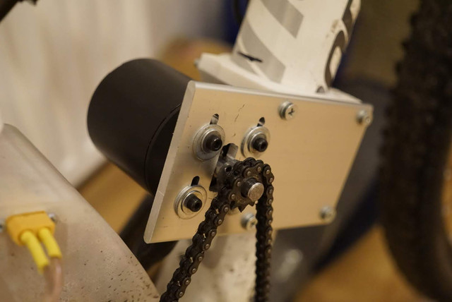

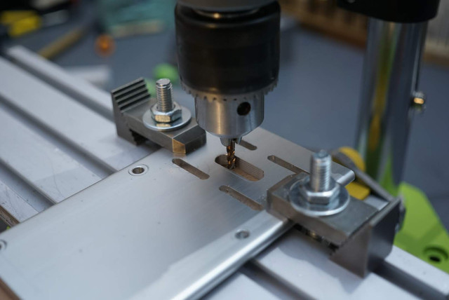

So i enlarged my 8 mm slot to 10mm and mounted the new motor. Spinning it without chain at a specific rpm the whole frame resonated. I thought that's a balance problem and probably i will feel it while pedaling. Boy i was wrong.. for inexplicable reasons this motor is sooooo much smoother then the Turnigy one that i couldnt believe: belt like experience. Even the sound is much better and more quiet too.
The only difference is that i use 11t sprocket instead of 10t, but i remember using the same on D5035 and it wasnt even close. I tested it sensorless and with the same phase current of 30A. I would say that in this unfair configuration it's a little bit behind D5035 but very close in terms of torque (because of the bigger sprocket). So it seems that it's a little more efficient. I didn't test it with higher phase current but i suppose it has to better otherwise i see no reason for the bigger stator.
Until now i managed to get away without supporting the end of the shaft because it's a little more thicker at 10mm. I will test at 50A phase current and get back with some results.

I see metal chips sticking to the rotor, but Turnigy was also leaking some magnetic field. I'm just worried because of the venting holes on the bottom, something will get inside and will frock up the very tight tolerance between rotor and stator. I will print a plastic cup and at least seal that part. There is another ~0.5mm gap between rotor and stator at the top, but that one is much harder to seal because one is turning, the other not. From this point of view Turnigys are better sealed and i would say splash proof. Not this one.

I received the Mystery 6384 motor a while ago. It took about 6 weeks to ship from China. I have 5 rides on it since the end of January.
Power:
I originally ran the D5035 (orange) motor. I switched to the Turnigy 6374 motor mid last year. The 6374 was a bit stronger (and heavier). The new Mystery 6384 seems a bit stronger still. I used the same current limits as the Turnigy 6374, since I worry about cooking the VESC. Also, the same gearing (11T sprocket). I really like the power!
Weight:
Not much heavier than the big Turnigy 6374...
Dust Protection:
Turnigy motors - Appear to be well thought out, designed for skateboards. I don't worry about dust.
Mystery 6384 (and all my other "open" motors) - None! There is ZERO dust protection. Rocks and large bugs can wander into the motor. I put electrical tape over the end holes, and made a sleeve out of plastic from a 2 liter pop bottle, which overlaps the gap between the rotor and stator.
Noise:
All my Turnigy motors (I have 4 now), have a pleasant, quiet whir. If silence is a 10, and a metal shop full of grinders is a zero, the turnigy motors are a 9 to my ears.
The Mystery 6384 has a fairly harsh and somewhat louder sound in comparison. I give it a 4. Tolerable to slightly annoying. All the other open motors I tried had a similar characteristic.
Thermal:
I'm not a power user, so my motors don't really get hot. I typically climb at 100-200 watts, with occasional 1-2 second bursts of 400-650 watts to boost me over obstacles.
No load current/drag:
On the workstand, it takes about 10 watts to drive the back wheel (in low gear), maybe a watt or 2 more than my other motors. It may take just a tiny bit more effort to pedal without assist, but I'm not sure. I'm riding in totally different terrain right now (more technical/loose rocks & gravel), and my chains are filthy...
Cost: Half!
Am I going to change back to the Turnigy 6374? Meh - not right now...
Overall I like this motor. I just wish it was a bit quieter & more pleasant sounding. However, for the price it's a bargain. I pay more for a tire!
