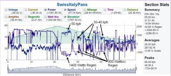

Because there was so much mountain climbing this was a perfect leg to showcase the benefits of DD hub with regen, though it also became apparent that we didn't have our setup quite as dialed as would be ideal. I had configured each Phaserunner controller to do a max of 12 amps of regen (so 900 watts net from both controllers) in order to keep the combined solar+regen charge current to just a little over 1C on the LiGo batteries to keep the cells happy.
However, what that meant is that if the hill was steep enough that 900 watts regen was not sufficient to keep the speed clamped, then the bike would continue to accelerate, and the faster down you went the LESS regen torque you would have on the motor because at a higher RPM fewer Nm are needed for a given braking power and regen wattage. We would only get more than 900 watts of regen once the speed of the bike had reached a point where the back-emf voltage of the motors was above the pack voltage which would be at +45 kph, and then suddenly the regen would increase again since the controller has no way to limit it.
This resulted in a situation where if our goal was to maximize the amount of battery charge recovered on the downhill, it was often advantageous to still use the mechanical brakes to keep our speed at say 30 kph. If we didn't use mechanical brakes, the speed might increase to 45 kph; we'd still be getting just 900 watts into the battery but the descent would be over that much sooner so the total amp-hours recovered would be less, with a much larger share of our potential energy would have gone into wind drag losses. It also meant that pedaling on the steep downhills like this was similarly counter productive, it would just mean going downhill faster less time spent getting this fixed regen into the battery.
Here's a link to just the data from the 2nd hill pass.
http://www.ebikes.ca/tools/trip-analyzer.html?trip=nbc8ZL
You can see that we get 42% regen range extension, with some sections where we were going above 50 kph and having more like 1200-1400 watts of regen from back-emf, but mostly we stayed slower using the brakes to keep it in the 900 watts regime.
Ideally, we would have had a setup with either higher C rated cells that can be charged at 2-3C, or a larger battery pack, that could take full advantage of absorbing the potential regen energy from the motors and Phaserunners. In that scenario with the phaserunners not having a max regen curren tlimit, we could have set a speed on the descent of say 30 kph, rowed and pedaled on the downhill sections too, probably had 1500+ watts going into the battery and likely doubled the amount of regen energy captured. Not that 42% regen is bad, but it doesn't represent the true potential in this scenario.
Another thing that this first day was very useful for was giving us an idea of how many Watt-hours we needed for a given elevation climb. Here is the data on this pass at 100m elevation steps.
As a good ballpark we could see that we were averaging about 100 watt-hours consumed for each 100m of elevation gain, and that became a really useful rule of thumb for budgeting our battery reserves on future hill climbs during the entire trip. If we knew that there was a 500m elevation climb ahead, we'd aim to ensure we had at least 500 watt-hours in the battery, or about half full, so that even if we lost sun while climbing there would still be enough in reserve to make it to the top. Once at the top, a flat battery is no issue since it's all regen going down, but if you run flat while climbing a hill then moving a behemoth of an ebike like this with no motor assist is a real grind.
You can see that on this 2000m pass, we dialed it pretty well. We took two breaks on the climb to allow some solar charging while the motors would cool, and only just hit the system's low voltage rollback right at the top of the mountain. The CA's LVC was set to 29V, but that includes the voltage drop along the long lead from the battery to the two motor controllers. The actual voltage as seen by the datalogger directly connected to the packs was a bit higher at 30.3V.

Now we're getting to the good stuff! Thanks for posting this analysis and the sample logs. Zooming in on the longer regen segments helped me better understanding what's going on.
justin_le said:
...and the faster down you went the LESS regen torque you would have on the motor because at a higher RPM fewer Nm are needed for a given braking power and regen wattage. We would only get more than 900 watts of regen once the speed of the bike had reached a point where the back-emf voltage of the motors was above the pack voltage which would be at +45 kph, and then suddenly the regen would increase again since the controller has no way to limit it.
:shock: :idea: Well, this would seem to explain some of the unexpected behavior I've been seeing on long and/or steep descents like increase/decrease in braking power around the 45 kph mark and more/less regen amps than my max regen amps setting on the PR. When comparing to your example speeds, it helps that I'm using the same motor (Grin 5T DD), wheel size (20") and battery (36V). Maybe if I re-read the definition of back-emf for the 11th time it will eventually sink in...
justin_le said:
...it was often advantageous to still use the mechanical brakes to keep our speed at say 30 kph. If we didn't use mechanical brakes, the speed might increase to 45 kph; we'd still be getting just 900 watts into the battery but the descent would be over that much sooner so the total amp-hours recovered would be less
Now I get why I saw ~40% regen on an extra-slow ride I took a few weeks back when the same hilly loop usually gets me 20-25%. I was descending the same hills at around 20 mph (32 kph) instead of the usual 30 mph (48 kph) or so. I knew the potential energy from the top to the bottom of the hill hadn't changed but it wasn't clear to me why I was getting so much more regen. (I also used less battery energy on the ascent.)
Excellent. I've been struggling with this aspect of on-the-fly range estimation. Now that I have the GPS Analogger working with the solar firmware, I'll have to figure out my Wh per 100m number.

Hey Justin thanks for the updates! You said something that struck a chord for me -
This is something I've noticed in my own riding, and it was very counter-intuitive to me at first.
When you are climbing a hill, a given throttle setting (on a torque-throttle setup) gives you a steady climb. If the bike sees a transient acceleration (i.e. you pedal or something) then it starts climbing faster. This requires more power (since you are increasing elevation at a faster rate) but torque hasn't changed - so you slow back down to the speed you were at before. Same thing happens if there's a transient slowdown - you speed back up to the speed you were at before.
At low speeds where drag isn't much of a factor this should be pretty simple to figure out - you climb at the speed where power = weight * (height/time.)
At first I thought going downhill with regen should be similar. After all, on my bike (as on most bikes) regen gives you a fixed torque resisting your descent - so you should descend at a constant speed, with regen "holding" you at that speed.
But what I found was the opposite. Because while the same formula holds (p=w*h/t) it's not stable. On a downhill, if you transiently speed up a little, then the "power" from the descent available (which is w*h/t) goes up - and the braking torque goes down as you describe. (same power, more RPM = less torque.) So you accelerate. Now you have more available power from gravity, since your h/t is going up, but braking torque is dropping, so you accelerate even more rapidly, until you hit the terminal velocity caused by increasing aero drag. When you transiently slow down a little, then the power available from gravity (w*h/t) goes down but braking torque goes UP, so you slow down even more. And you keep slowing down until you hit the limit of the regen, and then you creep down hill at some low regen point, usually a few kph.
One of the games I play during a long descent now is to try to find the magic point where the two (regen and descent 'power') balance out, both to maximize regen and for something to do. The one thing I don't like about this is it effectively requires me to 'pulse' the regen on and off (via the brake handle) to maintain this, and that's somewhat jarring. Someday I may find a two-way throttle (spring loaded return to 'zero' so you can twist one way for power, other for regen) so I have more control over regen, which would make the above a lot easier - and perhaps harvest a little more available power on a given descent.
An alternative, I guess, would be to have a speed-hold mode to keep you from exceeding X kph, and using regen to hold it there. Ironically one of my first ebikes (an EMS E+) did exactly that; when you were coasting downhill and the speed of the motor started exceeding base speed, the controller body diodes would start conducing power back to the battery and hold you at that speed. As I went to higher and higher battery voltages that stopped happening.
Thanks again for all the updates.

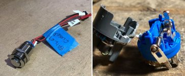

I'm finalizing the wiring on my solar ebike so I'm at a point where I have to address this issue. I've wired an on/off switch to the Phaserunner but need to keep the CA3 powered on anytime the bike is charging from solar which includes leaving it on overnight to record early morning charge current for those days when I don't get up before dawn.
Can I just run the CA-DP Plug's red V+ wire to the battery through a switch? Is there a way to turn off the CA3 backlight?
Yep - just switch the CA to Vbatt+ and you're all set. I wire my bikes this way - the switch also powers the lighting DC converter and there's a kill switch on the throttle to turn off the controller. This keeps the lights working and the CA instrumentation alive regardless of whether the controller is ON. Lets you switch off a sick controller and pedal on with everything otherwise working normally.
There's presently no means to switch off the backlight but a switch and minor electrical component could be added easily enough - there's enough room on the bottom or side of the CA case. The backlight actually plays a necessary role in the 5V regulator circuit so it's a matter of switching in an alternate component. I don't know the needed voltage drop off the top of my head but let me know if you want to pursue this and I'll post up something.
