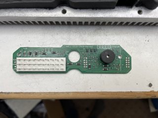

The daughterboard itself (I destroyed the cap on the bottom right by accident, but luckily that's one of the components I'm going to remove) - the 4-pin header in the top right is another serial interface, with 3.3v (pinout here):
Rear of the daughterboard:

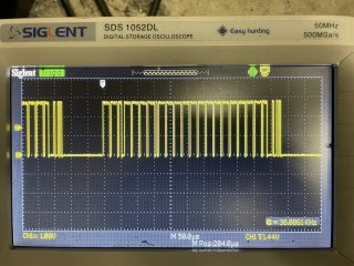

I've had some success after wiring everything back together. It looks like actual data is being sent through the CAN Pal's CANH & CANL (below is when I have the Voltage parameter being sent on one of the CAN configurations @ 250K), but I haven't decoded anything yet.
Unfortunately it sends several messages in a row and then stops, and repeats whenever it's reset. I assume it's waiting for an incoming transmission before continuing. I'll be hooking up my existing CAN bus with some debugging stuff soon.
My other guess is that the protocol is incorrect and the CAN Pal enters an error state, so everything that's sent out is garbage haha. We'll know soon!
It looks like just connecting things to the existing CAN bus with a termination resistor was enough for it to start continuously outputting:

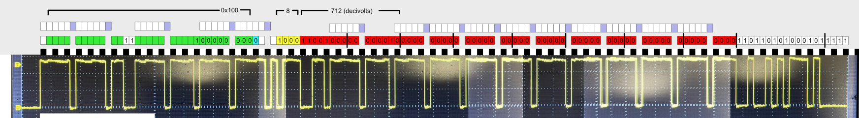

I can confirm that it's working and containing data! I broke down some assembled screenshots to figure out the data being sent, and can clearly see an extended CAN packet. This is SendID0 - the ID (as show in the parameters below) is 0x100, data length is 8, and my voltage is 71.2V:

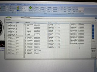

Here's the rest of the CAN parameters. I assume the other SendIDs are being sent too, but it was a little hard to see on the scope - once I have my system converted over to 250K, hopefully I'll be able to receive the data and everything. I'm a little worried that some of my modules won't be able to handle the extended packets - whenever I change the frame type in the CAN parameters to "Standard" (or 1, 0), it didn't seem to take. There might be something else overriding that.
The CAN SendIDx Timer functionality seems to differ a bit from the manual - I'm not totally sure I'm processing all the packets in time, but setting the timer for ID0 to 18, while ID1 is 56, ID2 is 57, etc. only sends ID0, but if I increase the timer to 19, ID0 sends for a couple iterations, and then it gets stuck on sending ID1. Setting it higher makes it send ID0 for less time. It feels like there's some comparison between them. Adjusting ID2's Timer seems to affect which is sent, too. The manual says that if the Timer is < 4, it's request-only, but these values are a bit higher than that, so I didn't think that would come into play. It's possible that my firmware version (6.4) doesn't support what's described in the manual, which is newer.
Ahh, it needs the ACK on the CAN bus line to continue through the timer count and everything. Once I had it hooked up to a controller that could ACK (previously was using a listen-only device), it alternates through the SendIDs as expected.

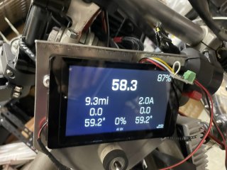

Experimenting with some of the different "data" variables on my display (speed isn't correct yet), and most seem to be working. It doesn't look like the "CurrentDistance" (which should be the remaining distance, possibly based on the current battery level) is displaying anything, nor is "CurrentSpeed", but "CurrentRotation" (RPM) works, so I can use that & convert. There might be more parameters I need to fill-in for those to work, but I thought I had all of the wheel/drivetrain ones filled-out.
