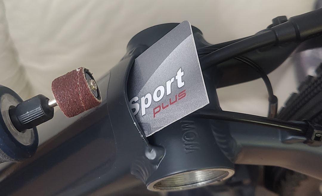

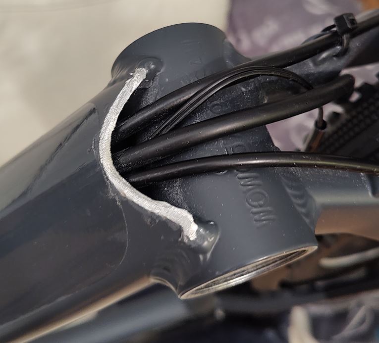

I'm one of the early adopters of this new Tongsheng motor.
Fitted this motor just two days ago to my Cube Aim Allroad XXL.
I have decided to ditch the archaic VLCD5 display and I have decided to use DZ41.
So far so good...

Btw, I know it's probably just me or my tired eyes, but it appears to me you've mounted the motor 'tilted down'' to the max, instead of forward/up. Looks like you have quite bad ground clearance.
Also, what you're riding looks like a commuter bike ( and not a 'trail' mountainbike at least ). Why did you choose for the more expensive motor over the cheaper one's, while the cheaper one's should suffice in a commute scenario?
It's all good so far. Nice and smooth power distribution. Torque sensing is also working as intended.
The DZ41 display I wish it could show voltage since the battery readings are not very reliable. Also the pedal assist increments levels could be fine-tuned. There is too big jump in power assist between 2 and 3. I hardly ever use 4 and never 5. Generally I stick to level 2 or level 3. On level 3 I can easily maintain 35-40 km/h without much effort.
Motor is placed as much upwards down tube allows. I had have to grind off part of the wiring management plate that is welded to the tube to gain some clearance. Had I removed more aluminium I could have issues with brake hydraulic tube, derailer wire and 1T4 controller wiring harness.
TSDZ2B here locally cost more than newer and more beffy TSDZ8 including custom duties. And I like to play with new gadets too.
