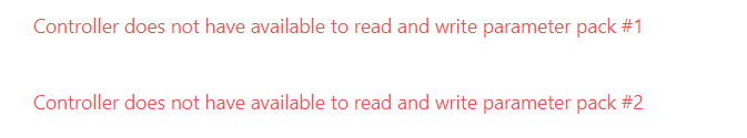

Hello again. I would like to ask some questions. After advices I wanted to connect my CAN controller to the system to change the value of the voltage in controller. In the program i see this info i posted below. Can I download this packages? I also would like to increase power of the engine, cause it feels like it's set on using eco mode. After connection i see all the parameters of the controller, but I can't change them. Are there any solutions for that?1730631861393.png

Hello again. I would like to ask some questions. After advices I wanted to connect my CAN controller to the system to change the value of the voltage in controller. In the program i see this info i posted below. Can I download this packages? I also would like to increase power of the engine, cause it feels like it's set on using eco mode. After connection i see all the parameters of the controller, but I can't change them. Are there any solutions for that?View attachment 361447
Probably you have firmware with locked settings. Sometimes this settings may be unavailable because of bug in my program, but in most case its a problem of firmware
Are there any solutions for this firmware problem? How can I change it?

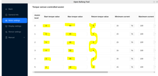

Andrey, good afternoon. Your program is a great solution for a freelance artist trying to customize their bike. Tell me or tell me in what units the parameters are measured in the attached picture. The problem is this: I want to adjust the assist in each mode very smoothly, but I don't understand what these values mean in this form. Do I understand correctly that in mode 1 the initial torque is 6 Nm (or is it some abstract value) 45 Nm is the maximum torque in this mode, 5 Nm is the recoil after the end of pedaling, 15 maximum current is the maximum current in this mode, which is needed for 45 Nm of maximum torque.
And the question is, why with an increase in the choice of mode, the torque settings decrease, somehow it is not logical or tell me what the logic is. Thank you!!!
Minimum and maximum torque mean values on pedalling torque sensor that are standing for 1% and 100%. I would recommend you to search for tutorial about torque sensor of uart engines on youtube, because this parameters for uart and can bafangs seems to be compatible
