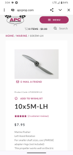

Guys who are running 12 volts are running this APC prop. It's actually a marine pusher, I thought they were just using a floppy plane prop
It's harder to measure RPM in a... So I'm currently trying to figure out how I'm going to prop down to account for my increased RPM.
* I have the stock prop
* The prop below is comparable
* I doubled my voltage... Now what do I do?
... I'm going to start by cutting down the diameter while watching the current draw, thrust, and top speed achieved under load...

* Trolling motor props are a nightmare of marked up junk
* Something like 50 bucks, easy
* The APC props can be an order of magnitude cheaper
* I'm thinking I will buy 10... Cut them down 1 cm at a time
From those learnings I'll pick more or less pitch, buy 10 more. There are plenty of simulators in the RC flight industry, I've heard of a few in marine... But there's just too many variables with the hull and the drag
