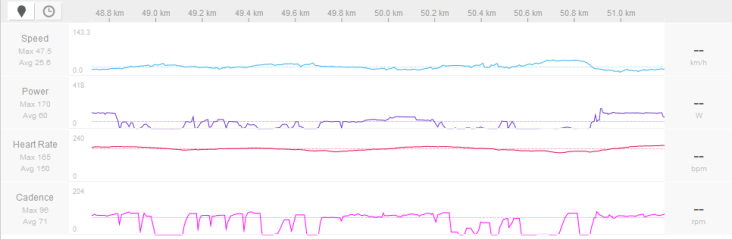

I'm not sure I've understood this but I've read it as the Mode setting on the Throttle Handle tab is affecting behaviour in PAS mode. I'm fairly confident this is not the case. Settings on the Throttle Handle tab only affect behaviour in throttle mode.
I've looked through my ride data and I don't find an increase in power as pedaling ceases. As an example, below is a bit more than 2 km of data while riding in a group. The average heart rate indicates a moderate human effort. The power trace is electrical input power with approximately 2/3 of that power at the wheel. The frequent abrupt reductions in cadence are to avoid colliding with the rider in front. Cadence goes to zero but doesn't show up as zero in the graph because the cadence sensor used to acquire the data has only one pulse per revolution and smoothing which reduces it's responsiveness. At the start we are climbing a 5% grade and I'm adding roughly 90W of assist at the wheel. I reduce the assist to around 40 watts at the wheel as we go over the crest and the grade undulates from there with me upping the assist as it steepens. Looking at the power curve there is only one small surge in power just before pedaling ceases at 49.2 km. Cadence at this point is a high 88 rpm which takes it above the limit for the BBS01. The slight power surge in this case is probably due to the cadence dropping to a level that the motor can keep up with, before pedaling ceases. The sampling interval of 1 second is not fast enough to capture the event clearly. A little after this at 49.4 km is a period of 6 seconds where the cadence rages from 95 rpm to 90 rpm and the inability of the motor to supply much assist at this cadence can be clearly seen.
file.php
The setting Stop Decay(x10ms) on the PAS tab I found to affect run on when testing on the Kurt Kinetic rolling road. I tried a large value, I forget the upper limit but there is one, and it ran on upwards of a second (I forget exactly) but it seemed a long time. Run on time also seemed inconsistent but I didn't investigate why. I didn't want run on because if you are drafting and the gap starts to reduce you need to be able to stop human and motor power as fast as possible to avoid collision and you can't use the brakes or the person behind is likely to collide with you. I set this value at 0, which was how it was supplied from EM3EV and as far as I can tell there is no run on. As stated in the EM3EV post, pedaling detection is either on or off, so when I say there is no run on, the cadence has to be below a level that is detected as off before assist ceases. The cadence sensor produces 24 pulses per revolution and I think pedaling stopped, is determined by no pulses for the period defined in Time of stop(x10ms), 0.25 secs in my case. That model hasn't been disputed here but I haven't confirmed it by testing. Keep Current(%) values of less than 100 make power, cadence dependent and with the BBS01 it is easy to be pedaling at a cadence that takes the motor into a region that reduces power. In either of these circumstances you get an increase in power whenever cadence is reduced. Current Decay(1-8) changes behaviour as well but only at Keep Current (%) values of less than 100 as far as I can tell.
You should be able to find settings that will avoid a power surge when pedaling ceases except from high cadences with the BBS01 and in this case power will only surge to the value you have selected.

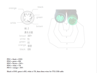

I just finished a programming cable using a display extension cable and Schmartboard female-female jumpers, available from radio shack ($6 for 10). No soldering / cable cutting needed! Just use jumpers from the pins in male end of the extension to your TTL device. Takes less than 5 minutes.
Here's how the finished product looks:
The attachment instructions are in the Software8FUN.zip file posted on post 1

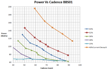

pjgold said:
The Current Decay sets how high in the rpm range the keep current setting comes into effect, setting this at 8 is almost the same as setting keep current to 100%.
I've found setting Keep Current(%) to 100 makes power largely independent of cadence which is not "almost the same" as the trace below with Current Decay set to 8 and Keep Current(%) set to 20.
In the other traces Keep Current(%) was also set to 20 but Current Decay was set to 4 which were the settings as supplied from EM3EV. The percentages are the Limit Current(%) as set in the Basic tab. While I don't know the model that produces this outcome I think these traces are inconsistent with the pjgold model provided for Keep Current(%) in post http://endless-sphere.com/forums/viewtopic.php?f=28&t=58780&hilit=proportional&start=525#p957582 .
The data was acquired without added human power and the pedals were manually rotated to keep the PAS operating on the Kurt Kinetic rolling road. Various gears were selected at a fixed level of assist, the data plotted in Strava and average powers and cadences read in regions that showed stability.
Ken if you have time would you be able to do another trace to isolate and compare the changes of the current decay.
What I'm looking for is same amount of assist say 30%-40% and compare
50% keep current - current decay 1
50% keep current - current decay 2
50% keep current - current decay 3
50% keep current - current decay 4
50% keep current - current decay 5
50% keep current - current decay 6
50% keep current - current decay 7
50% keep current - current decay 8
100% keep current
I would expect to see the point at were the power starts to drop off move up the range for each setting, but you never know!

I might give it a go but it's a long way down the priority list and it will not happen this weekend as I'm participating in the lifecycle event. It's too hot to ride at the moment, hence the reply. The data above is from early testing before I realised that setting Keep Current(%) to 100 mostly removes the cadence dependence, which I was keen to do. As far as I can tell Current Decay has no effect after that, so it isn't very interesting to me. Perhaps others can take this on. I proposed a model for what these settings do, which was little more than guesswork, but was disappointed not to get any feedback on its validity or otherwise.
Power does "move up the range for each setting" in the small data set above and a couple of others not plotted. However, it looks parallel and there is no "point at were (sic) the power starts to drop off". It must behave differently under some conditions or there would be no point having that setting. The only thing I'm confident of is that "setting this at 8 is almost the same as setting keep current to 100%" doesn't match the test results graphed above.
I'm using the Keep Current at 100% but have always wanted know how the current decay works.
