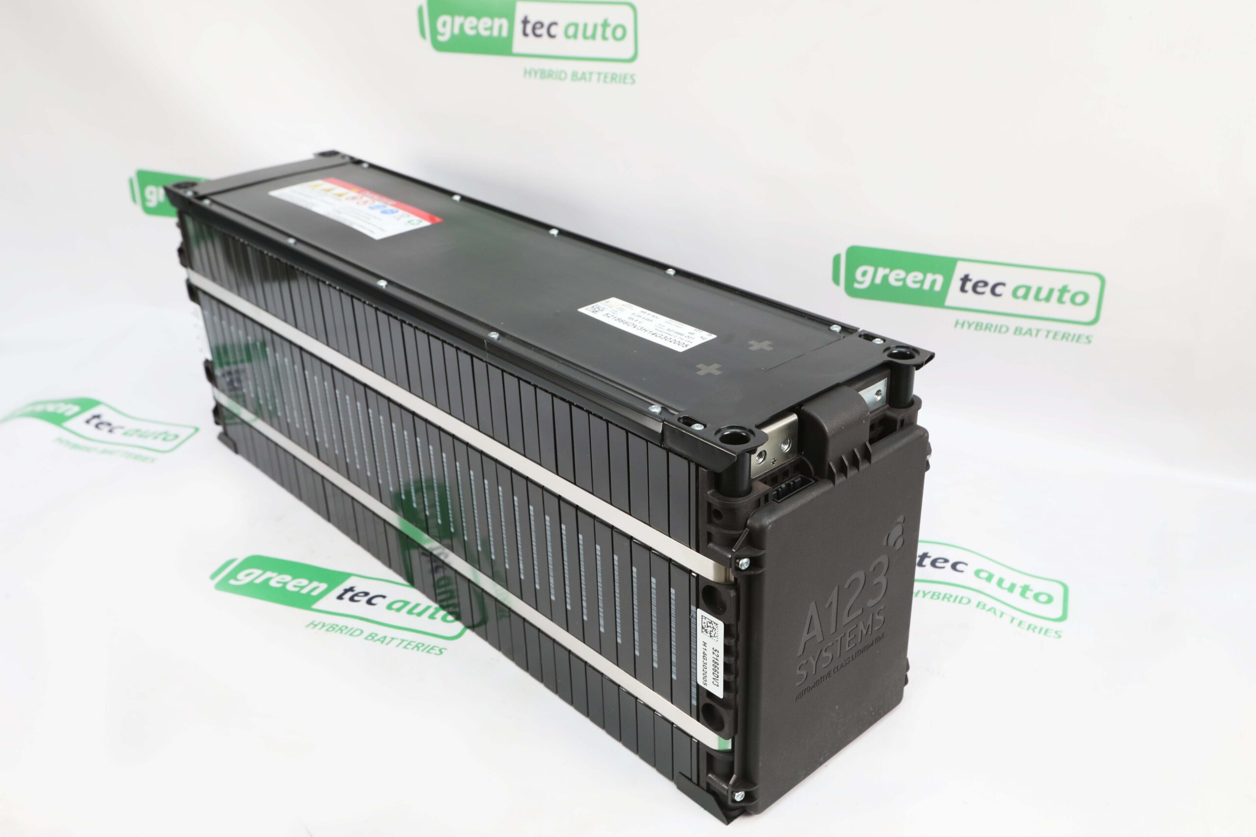

Battery would be an important part. Like spaim08 cells cheap. If they can produce for your needs.
Great love that cell. Stays in balance. Last a long time. How would I get one of those on my bike I wouldn't know

That A123 battery pack could run a lot of 110 volt devices. As my 72,v A123 20ah pack runs 1,200 watt hair dryers an AC unit. I stopped trying to devices as it doesn't have a BMS or fuse.
