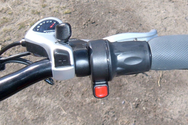

Shifters
The Shimano shifters are a bit unusual. Instead of using twist grip or normal index shifters, the front chainring is shifted by moving a lever (it's indexed). The rear selection is done by pushing a lever to go to a larger sprocket and pushing a button to go smaller (up a gear). It's different, but it works really quite well. With the motor, it's rare that you'll use anything but the largest front chainring - you only need to drop down when either climbing a very steep hill, or if the battery dies (but with over half a kilowatt hour of capacity, that's not going to be easy to do).

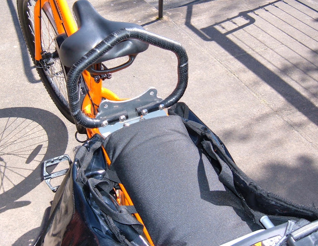

Seat Handle
There's no getting around the fact that cargo bikes are long, though the Rad Wagon is shorter than some other cargo bikes on the market. Sometimes, lifting the rear and swinging it around is the easiest way to park it where you want it. The Rad Wagon has a handle integrated into the seat to make this much more comfortable for you! It's thing like this - the little touches - that show me the people who built this really do understand how it's going to be used.

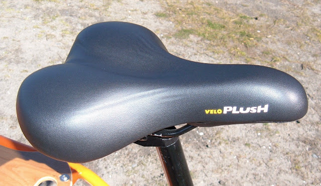

Seat
Seats involve a lot of personal preference, and there's no "perfect seat" for everyone.
The stock seat is a well padded Velo Plush of some variety or other (I suspect it's at least somewhat custom, based on the handle formed into the underside).
I prefer harder, narrower seats, so I'd probably replace it, but it's acceptable as a basic seat, and I had no complaints at all in the 5 miles or so I took it. For typical around town cargo bike use, it's just fine.

Cadence Sensor, Throttle, and Console
The pedal assist mode uses a cadence sensor, but it doesn't try to be smart. It functions as an on/off switch - if you're moving the pedals, it puts out power. The power level selected (1-5) determines how much power it puts out, and how fast it will top out on motor power. It works quite well, and it's easy to understand what the bike is doing. If you want to spin the pedals instead of use the throttle (while not actually contributing power), you can do so. Or you can use a low level of pedal assist and use the throttle.
The cadence sensor is the red unit, tucked up against the frame. It's pretty well protected by the chainrings, so it shouldn't be a problem. And, since there's also a throttle, even if it does have a problem, it doesn't prevent you from using motor power!
Turning the assist up and down while riding is easy enough using the controls on the left handlebar, though can be a bit of a challenge on really rough roads.
If you're creeping around a sidewalk or coming up to a bike rack, make sure you turn the assist down. Level 5 will get your attention in a hurry at low speed. Level 1 or 2 is fine, though.
The throttle is a half twist style throttle with a lock out button. The outer edge of the bar is just grip, and the inner part is the throttle. It's a smooth, light throttle, and there's no hand stress trying to keep it applied if you want to motor along. If you'd rather not inadvertently request 750W of fury, you can use the red button to disengage the throttle totally. If you turn the throttle off, it doesn't do anything, but it's a thumb press away from working.
I've not seen the lock out feature before, but if you're the type of person who rides along with pedal assist only, it's nice. I think it's required for some European countries as well.

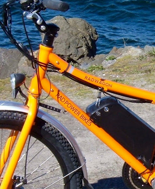

Battery Pack and Charger
The battery pack is a pretty bog standard style for 2016. It's a 48v, 11.6Ah pack, with just over 550Wh of useful capacity. Most electric bikes, when ridden at 20mph purely on throttle, will consume about 30-35Wh/mi. At the upper end (35Wh/mi), that's about 16 miles of pure throttle goodness. With a pedal assist, bikes usually consume closer to 15Wh/mi - so around 37 miles. And, of course, if you pedal more and use assist less, the battery will last longer.
Rad Power Bikes claims a range of 15-50 miles, depending on how you ride it. This seems entirely reasonable, and I really appreciate them using sane range numbers for their bike and not making absurd claims.
The battery pack locks onto the bike, and comes off with a lever once you unlock it. If you're riding in cold conditions, it's a good idea to bring the pack inside and let it warm up before charging - charging a lithium battery when cold (below freezing) can cause rapid capacity loss.
The charger is a 2A charger, which means it will take about 6 hours to charge a fully drained pack. The slower charging rate should help with pack longevity.
If you want to run your phone for months on end, you can take the pack off the bike and use it's USB port. The iPhone 6S Plus has a 10.5Wh battery. This is a 550Wh pack. That's over 50 full charges.
Significantly, their choice of a standard pack with nothing exotic means that down the road, it will be easy to find replacements. If Rad Power gets a larger capacity pack in the same form factor, it swaps right in, and since this is a standard enough design, it should be easy to replace the pack in 5-10 years when it gets weak with time and cycles. I have no concerns about their choice of battery, and I really appreciate them not going with anything highly custom or proprietary.

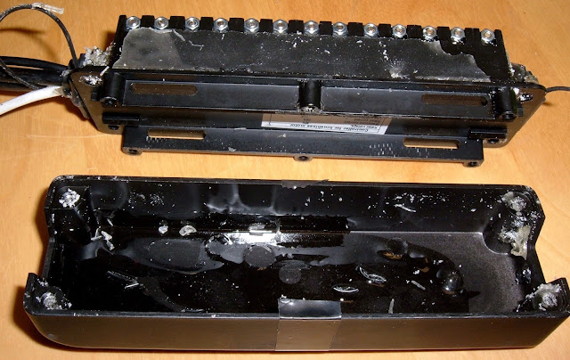

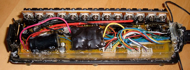

Controller
While I was at the store, I got to see a disassembled controller. And I am impressed!
This a fully potted 12 FET controller, contained in a strong aluminum enclosure that's sealed with an o-ring. You can see the potting below - it's the "goop" covering everything. It waterproofs the controller, helps with heat transfer away from components, and keeps things from moving or rattling around (while still allowing enough flex for thermal expansion).
The chassis of the controller has a large aluminum fin that cools the switching transistors - they dump their heat into this, and then transfer that heat into the base and the cover.
The bottom of the controller casing also has fins for heat dissipation, and is screwed into the bike chassis - which also acts as a heatsink. The cover is a thick aluminum piece as well.
This controller is absolutely overkill for the bike. Most 12 FET controllers on the market are rated for 35A or 40A. On this bike, with a 48v battery, the maximum current it will see at 750W is about 16A. That's less than half of what someone else might rate a similar controller.
Why do this? Reliability. Running a controller up near rated capacity works - at least for a while, until it doesn't.
Running this controller at a maximum of 50% of what it can handle, then putting it in a well cooled and waterproof enclosure, means it should last pretty much forever. Even if it's being ridden daily up hills, this controller has so much spare capacity, and so much cooling, that it's simply not being worked hard at all.
I can't ask for anything more. The team building this bike has done an amazing job of spending money where it matters - and this controller should be bulletproof.
