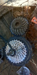

Racking up the miles crossed 350 miles sometime this morning while running errands and shopping. Went ahead and ordered that 11-34 cassette this morning along with a cheap bike tool kit to change it out with.
On another crazier note I also ordered a step up converter so I can break down my 5kw 51.2 volt battery and use part of it instead of trying to haul all 80lbs. It'll soon be time to break out an ammo can to put either 4) or 8) 105AH cells in to extend my range... Still need to open the controller box and see what kind of connector the battery uses so I can order the parts to connect the added power cells.
In the wee hours of the morning I ended up also ordering a 11t-28t freewheel since it looks like the cassette is not going to be right after all. In several places the sellers call the MF TZ500-7 a cassette and in many others they call it a freewheel. Now either way I have it covered.

Turned out it was a freewheel not a cassette. But it's swapped out now, bye bye to the 14-28 hello to the 11-28. Now I can pedal along with the motor at 13, 18, and somewhat at 23 mph. I think I'm still going to change the chainring. BTW It took me forever to learn the method for adjusting the derailleur! I almost went ahead and welded up the clutch in the motor but in the end decided to wait.
After swapping the freewheel I went for a 20 mile faster than normal for me ride mostly at 18 and 23mph and still had a little over 50% charge when I got back so it does help extend the range at higher speeds.
