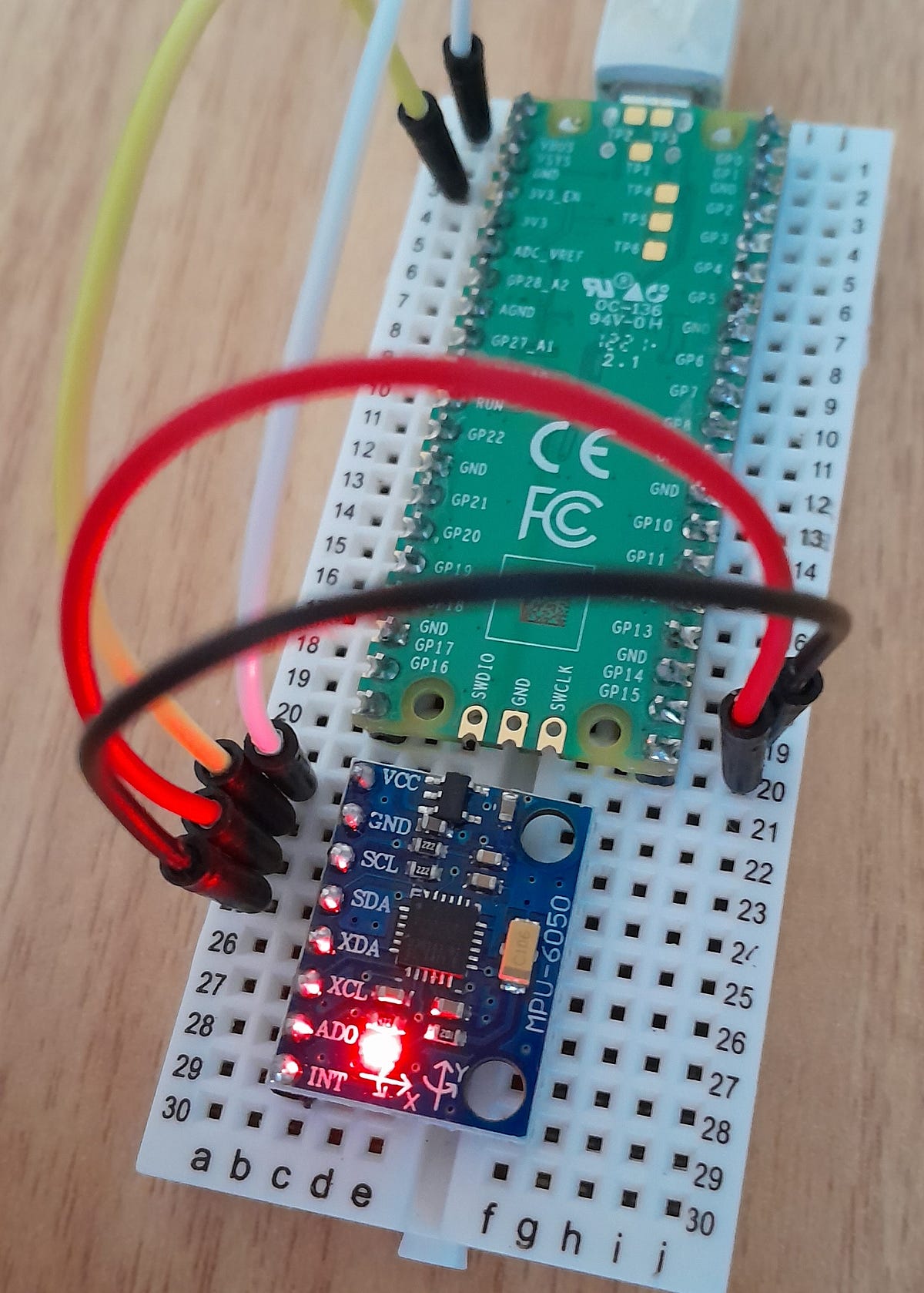

I like to tackle unfamiliar problems from both high and low levels alternately. Here's some IMU code for Pi Pico:
import machine
i2c = machine.I2C(0, sda=machine.Pin(12), scl=machine.Pin(13)) # creating the object that allows for I2C communication in MicroPython
imu = MPU6050(i2c) # passing the i2c object to the MPU6050 class above. This class will handle all communications
imu.wake() # wakes up the MPU-6050 (it may have been in sleep mode)
gyro_data = imu.read_gyro_data()
print(gyro_data) # (0.346823, -0.198345, 0.023958)
Taken from Development Tutorial section 3 of:
GitHub - TimHanewich/scout: Python-based Quadcopter Flight Controller Software using a Raspberry Pi Pico, MPU-6050, and a FlySky radio transmitter & receiver
with a step by step build guide here:
How to use an MPU-6050 with a Raspberry Pi Pico using MicroPython | by Tim Hanewich | Medium
I appreciate the thought, but I already have code-stuff to individually read IMUs; I even built a little breadboarded test unit on a previous page that read the IMU 3-axis angles and move servos to match them, from a gimbal-cameramount tutorial.
What I need is a program that will do *all* the functions I've previously described with the data gathering and processing of all the IMU outputs. ;) I have some concept of what's required, as a kind of block diagram sort of thing, but digging into coding to implement it keeps exploding my brain; there's just too many things I don't know or "understand" yet. (I've previously mentioned my brain problems in being unable to learn this stuff linearly and the gaps that leaves me with)
ideally it would be something that uses the mpu6050's existing onboard mcu to preprocess data to help this along, but i also don't understand the documentation they provide for them (such as it is--it seems to be pretty minimal, even insufficient, to use it's features). it's probably me and not the docs, though.
my usage for the data is so different from the stuff i find out there that i don't yet know hotw o adapt the code taht is out there to what i'm doing. i'm sure eventaully i'll figure it out, probably once the ai stuff can be used to teach me the process the same way you can teach a really stupid dog to eventually stop peeing on it's own head.
ATM I've got some heavy duty cold (for days now) that i can't think thru, so 'm probably not seeing / saying something right here, or misunderstanding what your post was about, etc. i could probably manage that last part anyway, without the cold, but it isn'thelping at all.
sorry i am all grumpy....mostly i'm exhausted and feel awful, beren that way for days when i took the week off so i could work on stuff around here and couldn't do much of anything but lay here most of the time. :(
No sweat, hope you feel better soon. It sounds as though you've enough h/w built to check how much noise and drift you get from your IMU and how rapidly it lets you re-read it. Those are or were IMU weaknesses so this might be worthwhile just to make sure it performs well enough for you to build up from there in the way you intend to.
If you dry run the Deepseek code with pen and paper is it along the right lines? When you list what Deepseek left out (compared to your prompt) if there's anything fundamental (rather than enhancements) you could try feeding the code back into Deepseek to improve upon, stepwise.
Apologies for the poor quality of the responses below, especially the typing, i'm not presently able to go back and fix all the problems i made tyipng it up. :(
not sure i'd call i t "built" ;) but it's on a breadboard.
I don't know. I expect there will be drift on each separate imu, and it'll probably need a separate board that has the ohter 3 axes, as these are only six not n9. so they can't compensate for it. i read of various techniques to use the searpate board to recalibratefor drift over time. taht's one of the parts of the wakefromsleep routine for the whole wolfy, where it will "stretch" and figure out where all it's parts are relative to each other and magnetic north, etc.
I don't understand what this means. could you explain?
even if i could read my writing :oops: :/ it would take forever to write it all out on paper with a pen*** and i wouldn't get anything out of it that i don't get from seeing it on screen where it's actually readable.
Even if i wrote it out on paper i wouldn't know what it is doing any better than i would any other way?
***if i used a pen i couldn't correct mistakes and i make lots and lots of those with wrong letters and shapes that aren't the right leters, or end up wiht them on top of each ohter instead of in sequence, etc. I'd have to use a pencil so I could erase all those once i went thru it enough times to see all the mistakes, looking back and forth from screen to paper over and over.
i have no way of knowing wheterh the code is right or not yet, i haven't learned enough to find out. if i knew enough coding to know if it was right or wrong, id' be able to write it myself. :oops:
to test the code i have ot build hardware that it can contorl and then run it to see what happens. but that's still being worked out. I need to build the test skeleton, then install basic servos for one limb, along with imus on that limb and the main body frame at least, so it has something to relate to position wise. then i migth be able to start testing the ai genertead code, and themmaybe start learning something from the process of figurong out what does and doesn'tw ork.
its not really right but you could think of the way i have to do things like this where i don't know all the details of exactly how to do something already as a jigsaw puzzle thats poured out onto the table and floor and the next room or two, and i just put together whichever peices i already have available whenever they fit. The puzzle is all there in my head, just that some of the pieces are still blank, cuz i don't know exactly what is supposed to go there, although i have the shape of it. i doubt that helps any, but...it's all i can think of atm.
if i had a partner to work with consistently whenever i could work on it, that laready knew how all these things worked, i could learn what i need from doing that. right now that will probably have to be the ai cuz they won't get upset by my weird brain that can't figure actual people out or sometimes can't deal with how they act towards me, etc. (this is why i need the wolfy in the first place because there's no people that would ever want to be or be able to be what i need and all of them "abandon" me sooner or later; dogs do accept me and want me around but i won't always bea ble to have a real one; someday i just wont' be able to handle losing another one).
i'm sure all this stuff makes me out to be a flaked-out weirdo, but...i guess i probably am.
That's what I meant by alternating: you've done a lot on the concept and functioning and the jigsaw is that top-down phase asking for a break. H/w is real-world and finnicky, so prototyping can often be better tackled bottom-up starting at the sensors, but if you can build a testable part of the skeleton then go for it. Alternating helps me to modularise a task that's taking shape and firm up the interfaces, and tends to expose 'minor' functionality that turns out to be daunting and needs working around.
https://google.com/?q=dry+run+a+program
Not only will you evolve Deepseek's code, but the more you skim or youtube code in an unfamiliar language the more you ingest how it works, making the language tutorials easier. There are things about Python I'm not keen on but it's the new English for what you're doing. Hang in there with the AI, it gained 2 IQ points while I wrote this ;)
