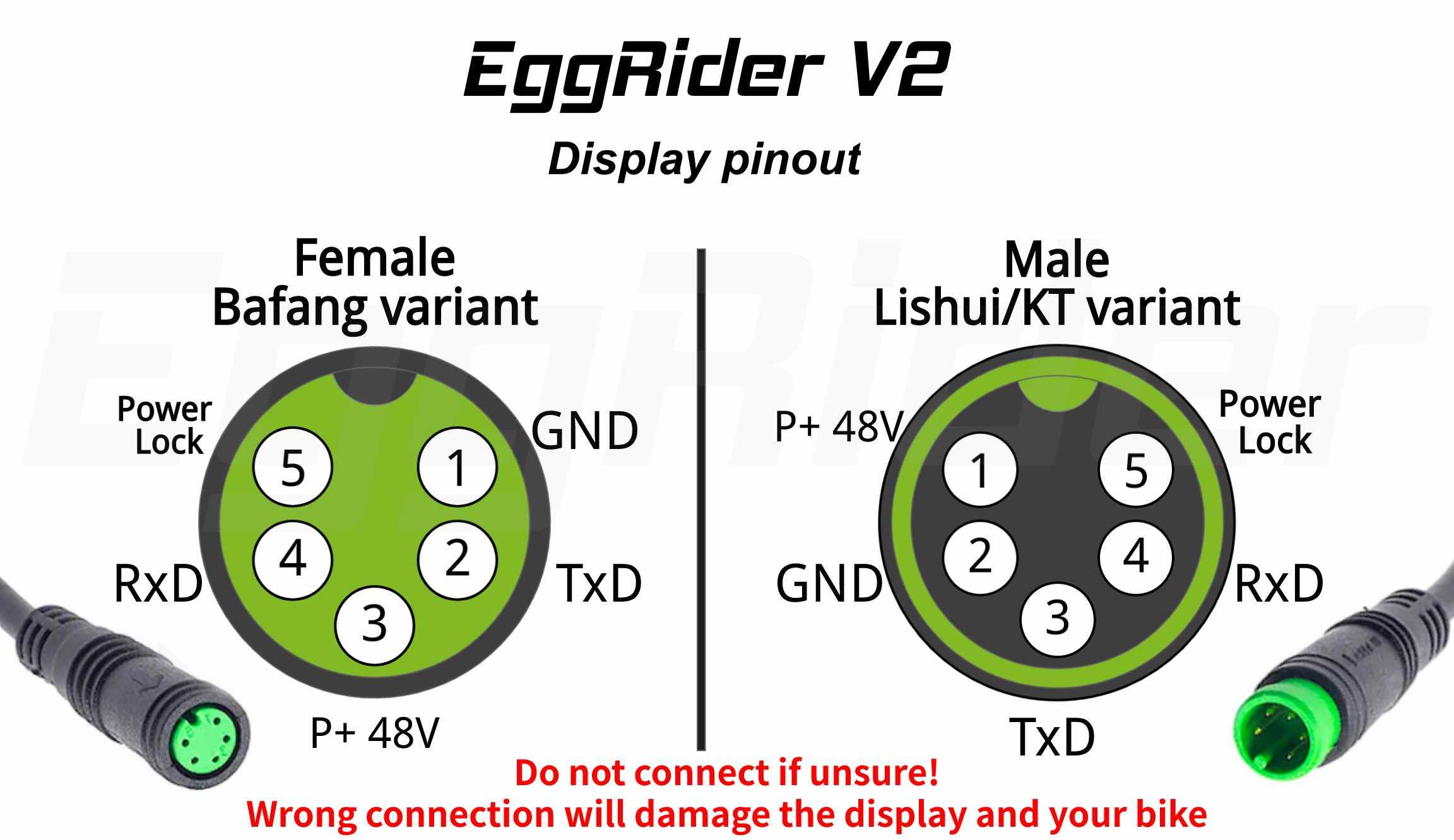

The image on the left above is an updated version of the image posted by @stancecoke below, I converted it to the female version of the connector because that is what mine has. Note that this configuration is for Lishui controllers and associated displays. The connector on the right is from an SW900 and I do not know what controller it fits but I "think" this is the standard wiring configuration for most controllers that use this style connector.
The table below and the numbers I applied to the picture of my connector also come from the image I posted earlier in this thread. The image was found on the web, it is not specific to my display, but is supposed to be "the standard." I recreated the table below in real text so search engines can pick it up, but readers beware that this may not be correct, read the findings below the chart before following this.
Table: Wire sequence for KT and Lishui controllers
KT and Lishui wiring sequenceWire colorFeature it provides
1Blue (Kp)Controller power line (aka power lock)
2Green (RX)Display data receiving line
3Yellow (TX)Display data transmission line
4Black (Ground)Display ground line
5Red (Power - VCC)Display power line (full battery power)
I connected the controller and main harness, turned the battery on, and then take voltage readings in each hole of the connector to see if I could determine if my controller and harness follows ”the standard.”
Here are the readings I got...
Pin 1 - .84 volts (blue?)
Pin 2 - .75 volts (green?)
Pin 3 - 52.3 volts (yellow?)
Pin 4 - I assumed this pin was ground based on the information above and kept my negative probe connected here.
Pin 5 - 53.2 volts (red?)
What I don't understand is why is there near full battery voltage on pin 3, which is supposed to be yellow (TX) according to the EggRider diagram.
Note that the image from EggRider conflicts with the image below that @docw009 posted earlier. His image indicates that the green and yellow wires are inverse to this diagram. In his image the green wire is labeled TX and the yellow wire is labeled RX, and in this image they are inverse of that, the green wire is labeled RX and the yellow wire is labeled TX. And as you can see in the readings I got from my controller, pin 3 (possibly yellow) had nearly full battery level voltage on it, so it seems to me that if I had followed the instructions on the other diagram to put a jumper between pin holes 4 (ground) and 3 (yellow), it would have caused fireworks when I turned the battery on. Note that there's a good chance there should not be near full battery power on the yellow wire, so I may have a problem here.

The Eggrider Homepage provides this drawing:
So connect pin 1 to pin 5!
You can easily find the GND pin, it has 0 ohms to battery -
regards
stancecoke
Thanks so much for posting the picture, it explains a lot, and I feel confident about trying the bypass. I updated the diagram in my previous post to be consistent with this one, I made mine the female version of the pinout because mine is female, but now there are both male and female versions to make them easier to read for others in the future. A quick question...

I'd still feel a bit uneasy with full battery power apparently on two pins, when it should only be on one. (Display disconnected right?)
Wouldn't you want to get to the bottom of this first? Perhaps you have a bad harness cable... Are they ghost voltages?
Find the true ground pin hole, or use battery negative for retesting the pin hole voltages...
