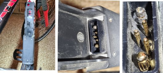

There, I had a time to better check connectors, but guess what, battery won't come out anymore!
Is it "stuck" somehow connected to battery failure, like maybe connectors are melted? I hope not.
I think that is just a stuck screw that goes from the battery holder to the bike frame (I found a picture of how it looks inside). Maybe the connector jack moved, or maybe something else.

Also, after last cleaning of the battery leads (maybe a year ago), it was easy to slide in/out without too much friction (so easy that if you did not lock it, it might jump out). So, maybe burnout happened because pins of connectors were not touched enough or the battery jumped on vibrations in/out in millimeters, and sparks happened often? (When the battery is locked it still can be slide in/out by a few mm).
May I open the battery to reach the connector and see the dimensions for ordering?
That bottom connector in the third pic, I had a few of them on some radio antenna gear I left exposed to the elements and in 4 weeks that gold coating was pushed off by rust. Underneath was this cheap metal. The Chinese are making some real crap and it's finding its way into all manner of gear. Just be aware of that, and the fact that steel/tinplate doesn't conduct current nearly as well as solid copper. Copper is up to 8x better and some cheap connectors can actually act like resistors and heat up.
Table of Electrical Conductivity
Lead's electrical conductivity is about 7% that of copper but it's used for battery terminals because it is malleable, cheap, and resists acid corrosion. Greater surface area is the key to performance with battery terminals on cars etc and contact surface area matters in all high current applications.
This is almost certainly a large part of your damaged connector problem.and will continue to quickly degrade any new replacement connector you install.

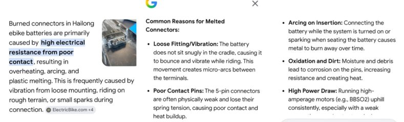

OVERALL: This problem was caused by
  • poor design-- weak hold down mechanism
  • poor quality control
  • insufficient testing
  • Cheap materials
Not really your fault, except for buying low quality equipment. :mad:

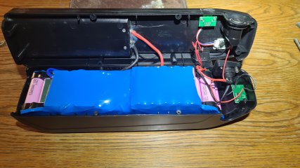

I am surprised that the seller didn't lie that there are real Samsung 3500 mAh batteries inside!
I am surprised that all batteries are in a plastic holder case! Nice.
I am surprised that the blue cover tape is cut for some reason. Is it normal that blue cover tape is cut? (I am the first customer).
Guys, I am scared of doing that, and need your support. The glue around the connector is strong and will be hard to remove.

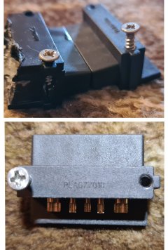

Unsoldering that connector was really pain in the a.s. It was very hard to remove it because solder won't melt it mixed with plastic and hot glue. Then I set solder iron to 400 C° and that works.
The connector number is pla077010. Not too many options for ordering from the EU. I was ordered from AliExpress, now waiting maybe month or more, because a small package 🙄

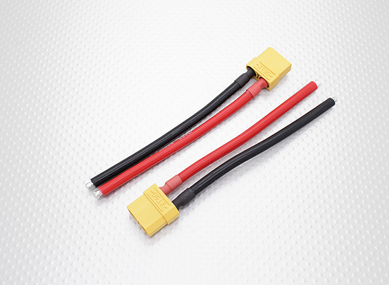

I've done a few XT30/XT60 connectors before on my e-skate, e-bike and drone. I have a soldering iron of 450°C. I will set it to max.

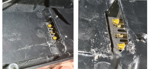

I melt the plastic, as you can see when I pull the connector out, because I set it only around 300 °C. When I increased temp., it went easy out.
On the battery connector, will be a little tricky and challenging. You see that access to the pins for soldering is a little "in the hole". So, some plastic behind that pin might be a melt, but who cares?
On the bike frame, male connector, do I change it or not? (I can scrape out/grind that bad pin). But maybe better both? This connector needs to be a little modified. You see that on the old connector I removed a little part so that connector can lie down nicely over the screw head.

How did they predict that this screw must go in?
There is no thread. I think it will be broken with force.
As you see on the old one, the screw is fully tightened, but it broke the plastic (That came from the factory. Not by me).
