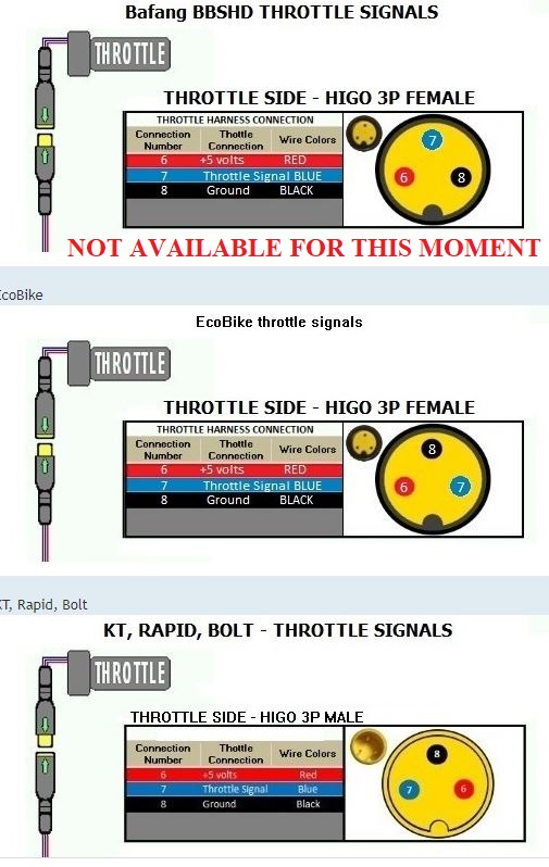

They offer the 3 pin Higo connector on the throttle itself in 3 different wiring configurations. I actually ordered the wrong one but it's literally just the wire colors that are different. A "wrong" throttle plug can easily be wired to work, just have to map the wires (each wire map is provided on their website) according to your setup. You may have red wire to black wire or something funky, but it's easy to figure out if your "colors" don't match.

- construction based on the hallotron principle (0.8-4.2V),
- soft elastomeric, non-slip insert in the place of contact with the thumb,
- works with any power controller,
- intended for brushless and brush motors,
- hermetic Higo connector,
- length of the cable: about 40cm,
- compatible (plug & play) with Eco bike or KT/Bolt/Rapid,
- can be used as a throttle or brake (if controller supports).
