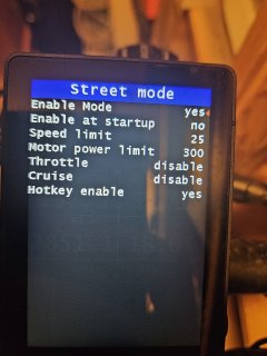

I read your post and you've got few problems:
Ad2 in menu temperature should be also "throttle" mode instead temperature amd throttle should working "unconditional"
Ad3.1 Try to change Decceleration in menu Motor but first change also in menu Torque "Coast brake adc" (its Foc) to c.a 24-25
AD.3.2 Your main problem is that you have probably Street mode enabled and it limits you to 500W and 25km/h, and throttle is off, but by pressing "minus" and "power" the "Assist" sign on the main screen will change color from white to red and then you have full power and speed (I'm sending photos of the settings you should have for it to work), in the display menu set the shortkey to "yes"
You can also experiment with the torque adc range, it's in the range of 0-40, but 10-30 works best for me, the lower the value, the more "sensitive" the torque and the less force you need to put from your feet
