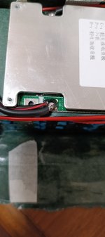

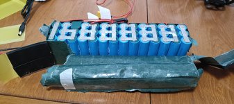

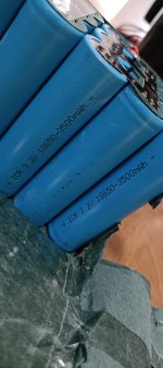

For those interested. 14s3p
Overall I'm impressed with the build. Insulated well, packed well.
Dodgy bits.
1 The marking on the cells (if anyone knows specs of these cells pls let me know)
2 the final pos and neg strip (at least it is doubled up)
3 I was concerned they had wired the BMS neg out incorrectly. But I searched and found the same BMS and it's meant to be that way.
This pack is to be parallelled with the original pack on my Steath Fighter. Capacity extension.
I'm going to bypass the BMS for main discharge and only use the BMS for charging
