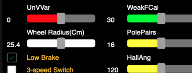

FYI
PC version change setting need send all settings at once. And transmit so slow, we need take an heavy notebook near your ride either.
so made this APK for speed up reading and change gear real time.
How to connect wih Bluetooth:
1. paired BT from phone setting
2. press BT button (default name is "slave")
3. selet your BT device name
How to change em-150 setting by phone:
1. select "s1" or "s2" for setting, or select for quick "EBS" "HDC" "Paddle" setting change. (some setting need press "Rst" or power off)
2. scroll down screen and choose one setting you want to change.
3. change the value by scrolling bar, setting will save to em-150 and read back from em-150 by BT
4. press "Lock" will lock your wheel prevent someone move your e-bike, you can press "Rst" or power OFF -> ON to release it
How to save setting group:
1. select "SaveRec"
2. the "normal" group will change to "Backup1" group
3. click "Backup1" group and choose one name which you want to save all setting in it.
How to recall all setting from setting group:
1.select your group name, stored setting will temperory load on phone
2. press "Upload" to send to em-150
3. if you want to cancel your choose group setting, press "Read" to read back form em-150
How to read/record your riding Km, WhKm ...
1. load APP, connected and riding
2. if you need record to another row, close APP and relaunch it
How to calibrate speed on phone (since em-150 only sending RPM data)
1.Current wheel size is 10inch, increase "RPM2Km" if your wheel size or speed is lower than realtime GPS.
  • em150_demo0314 (2).zip

Hello everyone, I have new questions and hope that someone can answer them. Is this motor a 4 pole pair motor? There are 8 seperate magnets on the rotor. And can I understand the hall effect sensor angle from this photo? When I enter 4 pole pair and perform a self learning test, the profram can not understand the real hall angle, I enter different values before self learning test, after a short spin of the motor, the entered hall angle value does not change. And normally I can not run the motor as well. Thanks in advance.

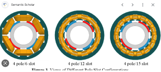

8 poles, 30 degree

My experience is u need try 3 phase randomly and with 3 Hall possible combination, and then work well. Good luck. ( remember use YB exchange setting if direction is wrong)
8 poles, 30 degree
So I will try 4 pole pairs and 30 degree, right? Are we measuring the shape angle of this sensor's outher size to determine the angle?

8 poles, 30 degree
And what is the difference between 30 degree and -30 degree? How can I understand the direction of it?

And what is the difference between 60 degree and -60 degree? How can I understand the direction of it?
Angle negtive means the coding for brushless ordering. Should swap that with hall sensor wire.

BTW, still remind you test all possible wire combaintion of wire, 'ecause it's the controller's limiation.

8 poles, and you can confirm your motor with a compass.
