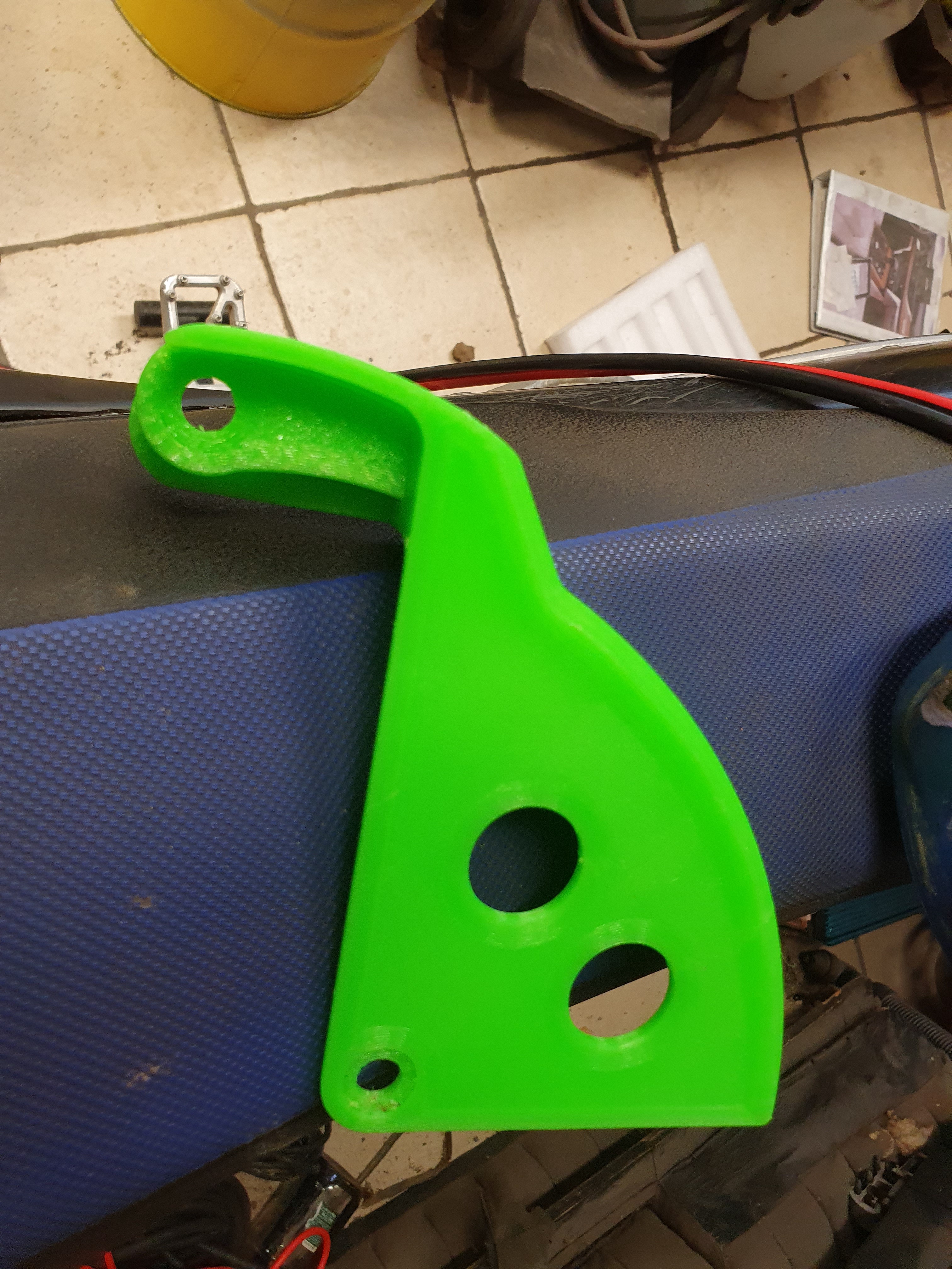

As I havent really got the printing of flexibles working yet, I decided to have a go at PETG.
I mean, how often do you break a plastic bottle?

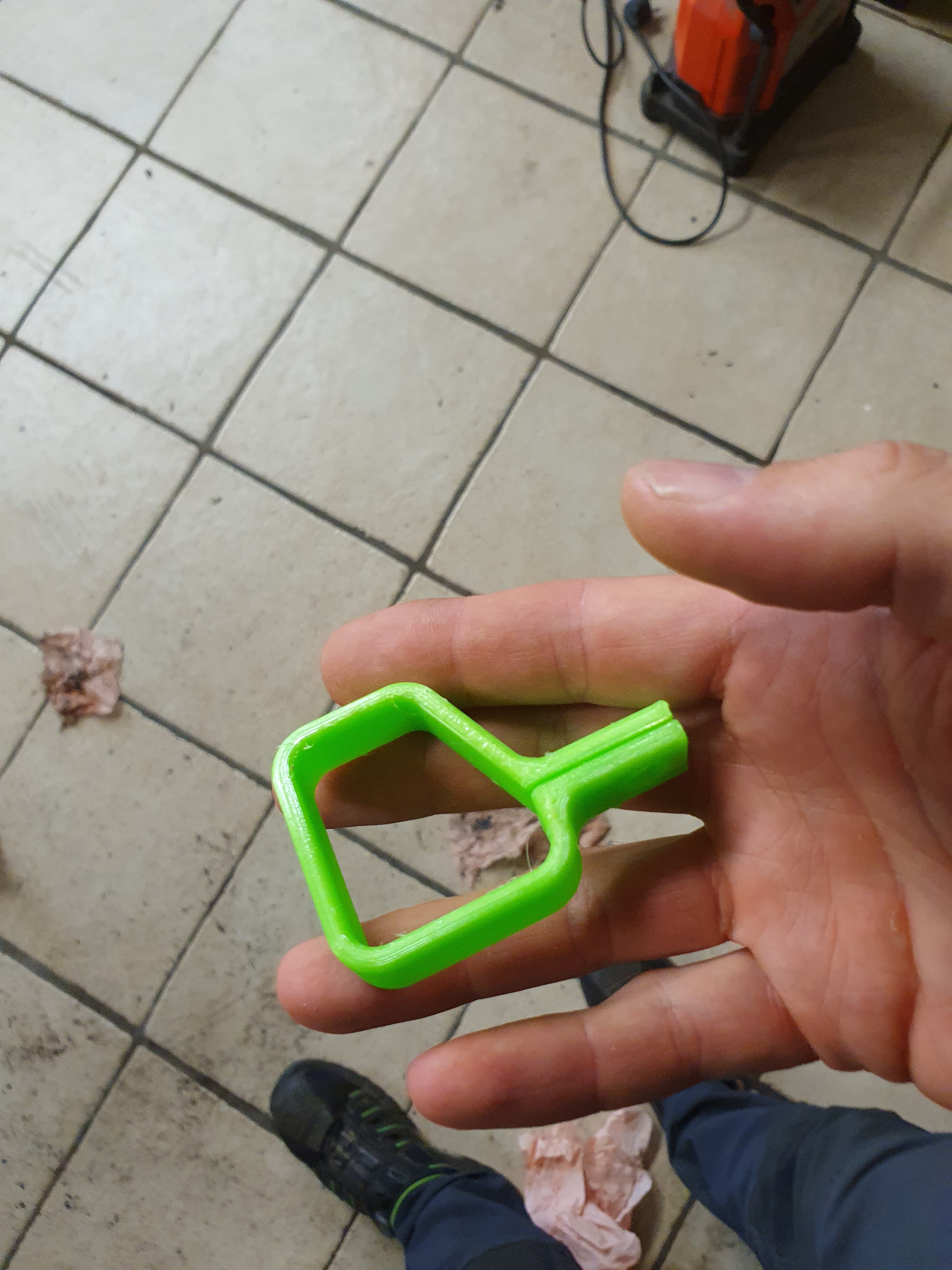

First I tried a brake line guide:
Turned out alright I think, some stringing but not too bad.
Ehum, the color might not be the best match to the rest of the bike 😬

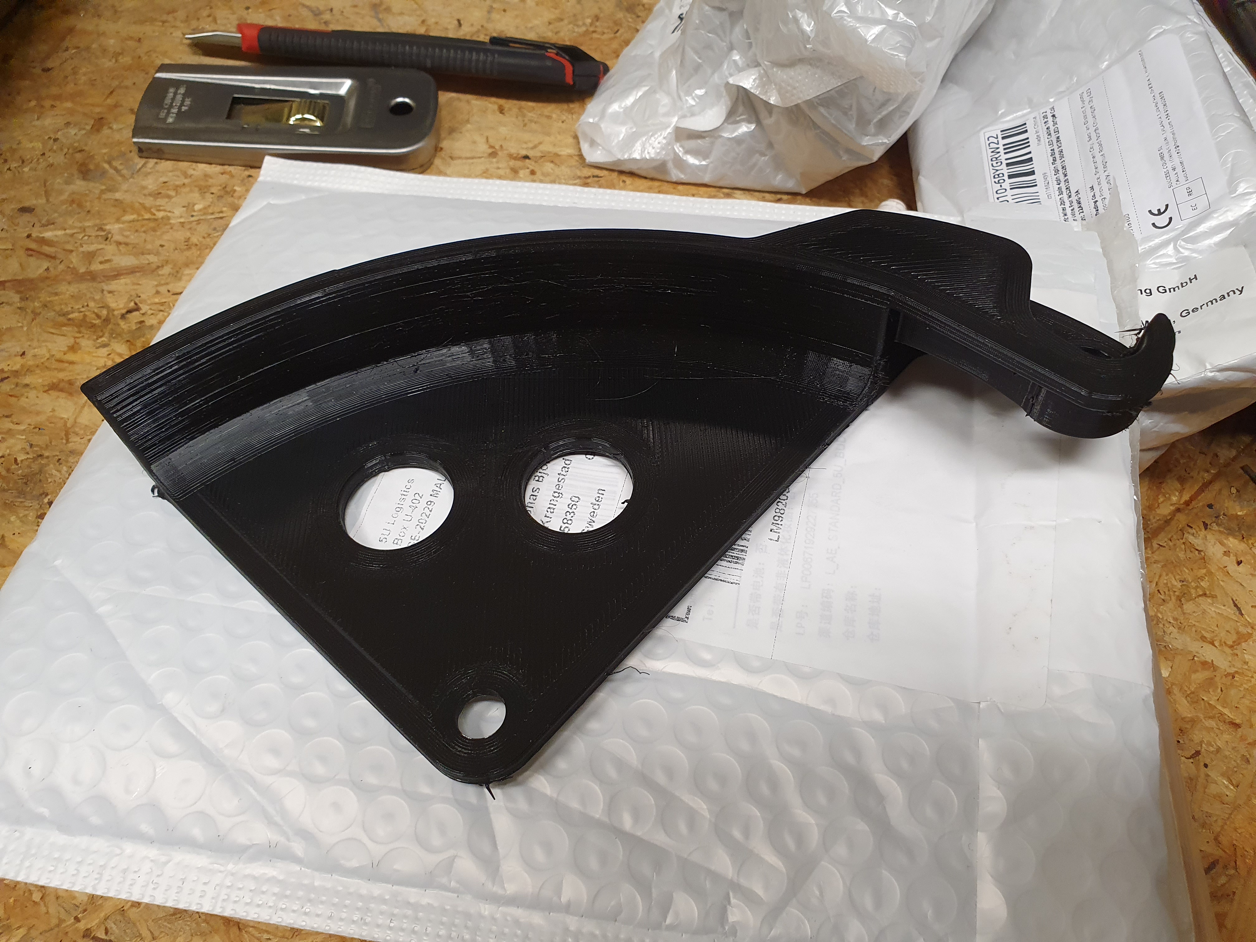

Then I did the brake disc guard:
Oh my god 😅
Is that your reaction because you like it? Because it turned out well? Or just because the color is so shocking?
The color, it was the first time I printed PETG and I already had this roll. I didnt want to buy another before testing it.
Not sure why I bought this one, but I suppose I thought it could be an interesting color in some circumstances ;)

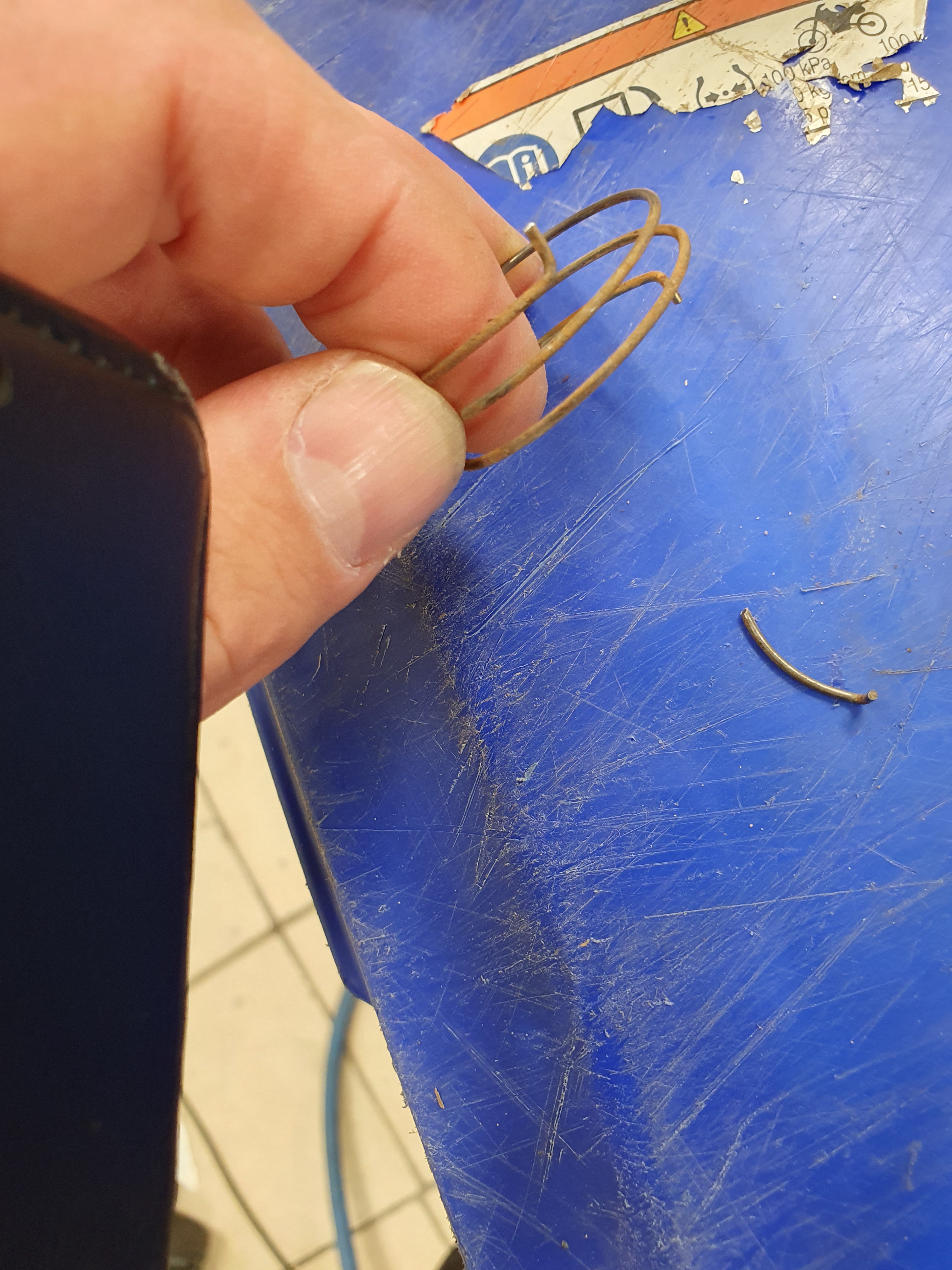

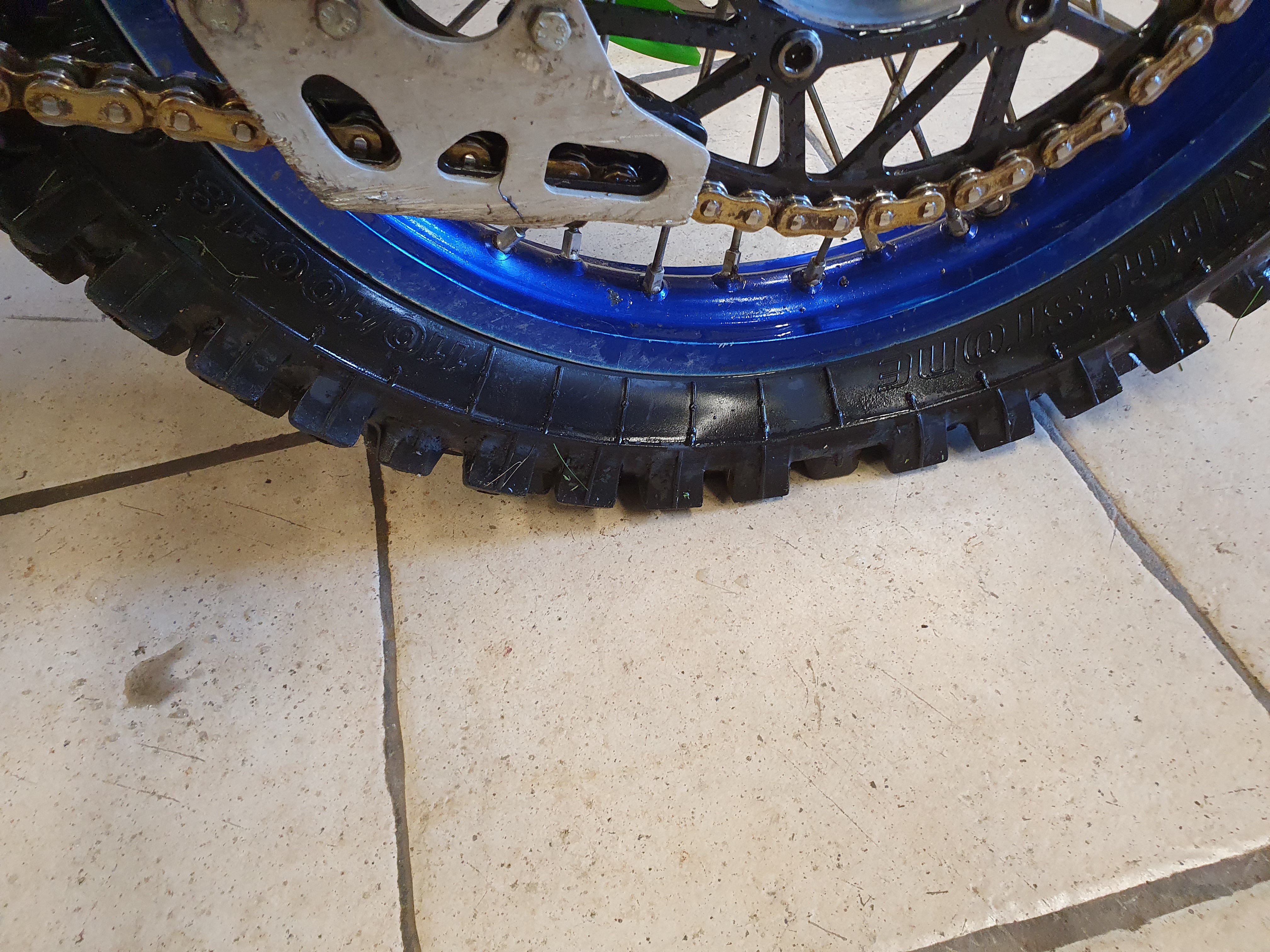

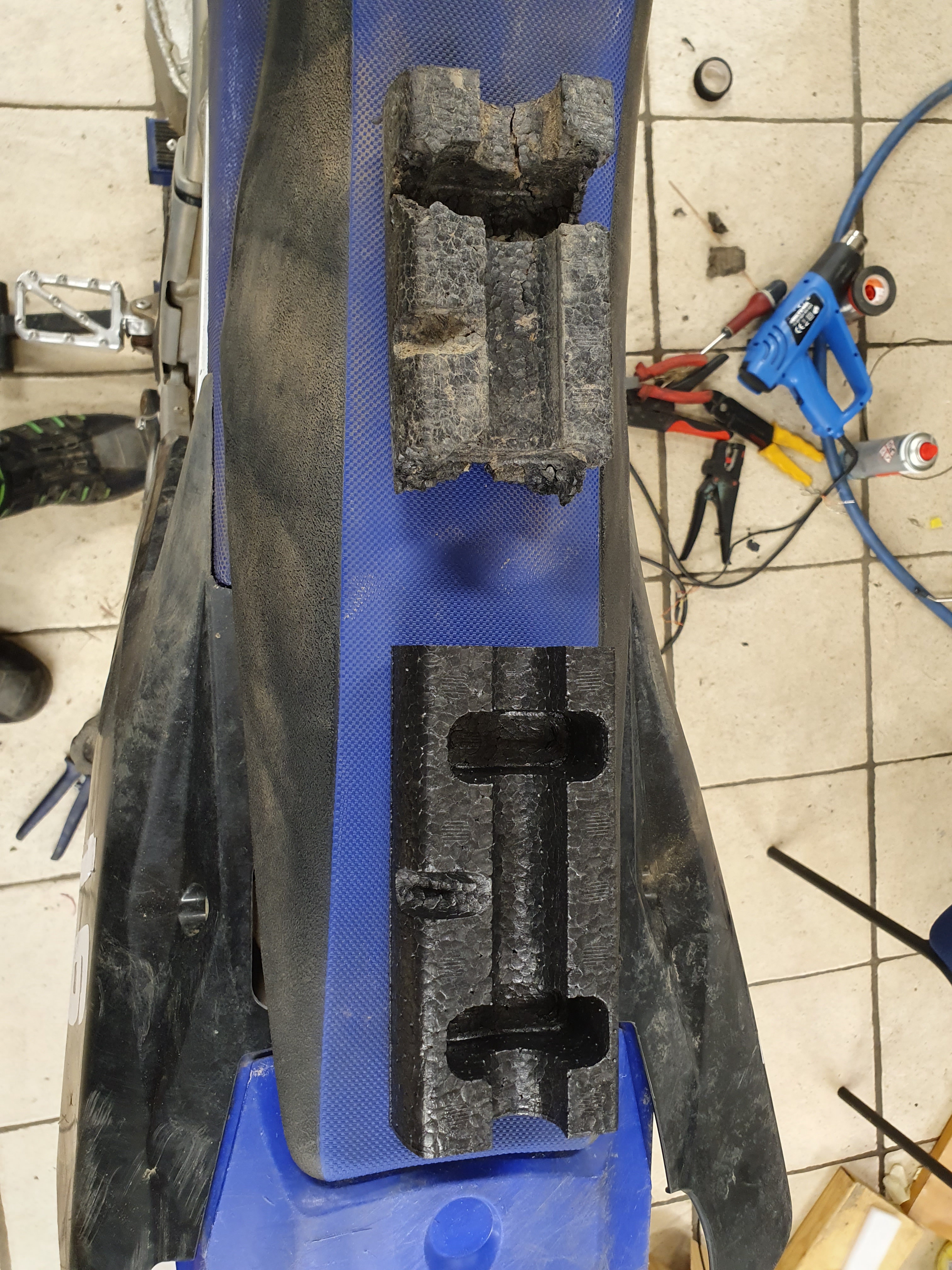

Last ride I came home with this:
I run tubes in my practice wheels, mousse in the race wheels.
I thought it was a pinch flat, as I had been at a rocky track. But it turned out to be the valve that had ripped partly out of the tube.
Anyway, I decided it was time for this:
I have hesitated as I have some used tires to run, and I was worried they will leak.
I guess I will see, the air is still there after a day at least :)

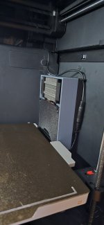

Here is the extruder, there is a screw in each end of the spring. But they are not connected to anything adjusting, they are just securing the spring in place.
The whole system, I have a ball bearing spool holder with a strait feed line to the extruder.

Thanks, I decided to do a smaller update on my ender 3 v2 with another extruder and a smaller steppermotor mounted as direct drive. Maybe later I get another printer. It has been discussed in this thread: Ender 3 v2, upgrade or not?

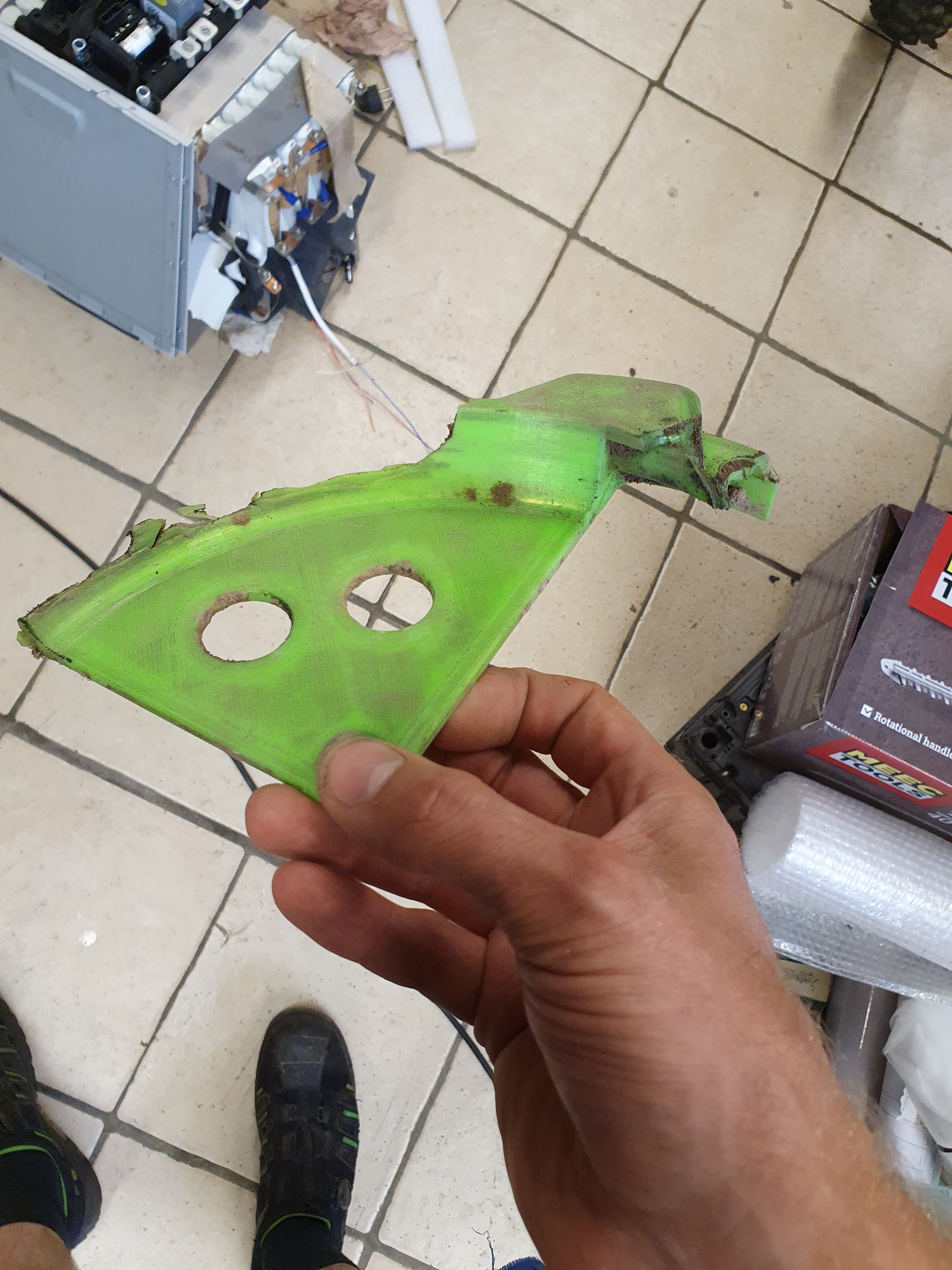

The petg discguard died today:
The front mount broke off, and I suppose the rest of it broke when it was pushed in to the brake disc.
I think I will make another ABS one for now, then have another go at flexible when I have updated the printer.

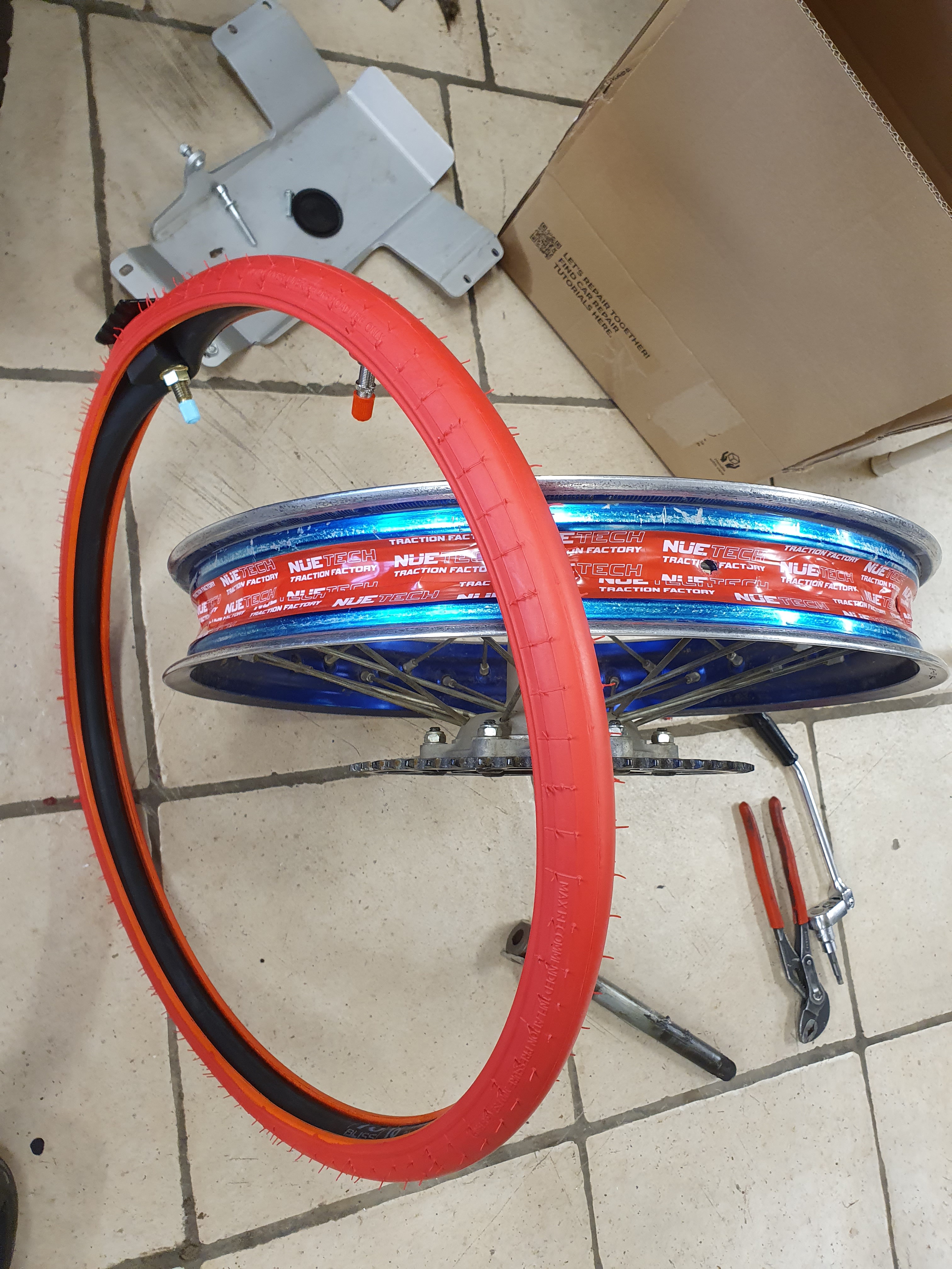

Oh, the red tire looking thing in the previous post is a tubeliss insert for the rear wheel. I see that it wasent very clear in the post ;)
I have been running it now for two practices, it feels weird at first until you get used to it. You can kind of feel the tire "climb", I dont know how to describe it in English. I have pretty low tire pressure now 0,3 bar. Maybe I should raise it a little.

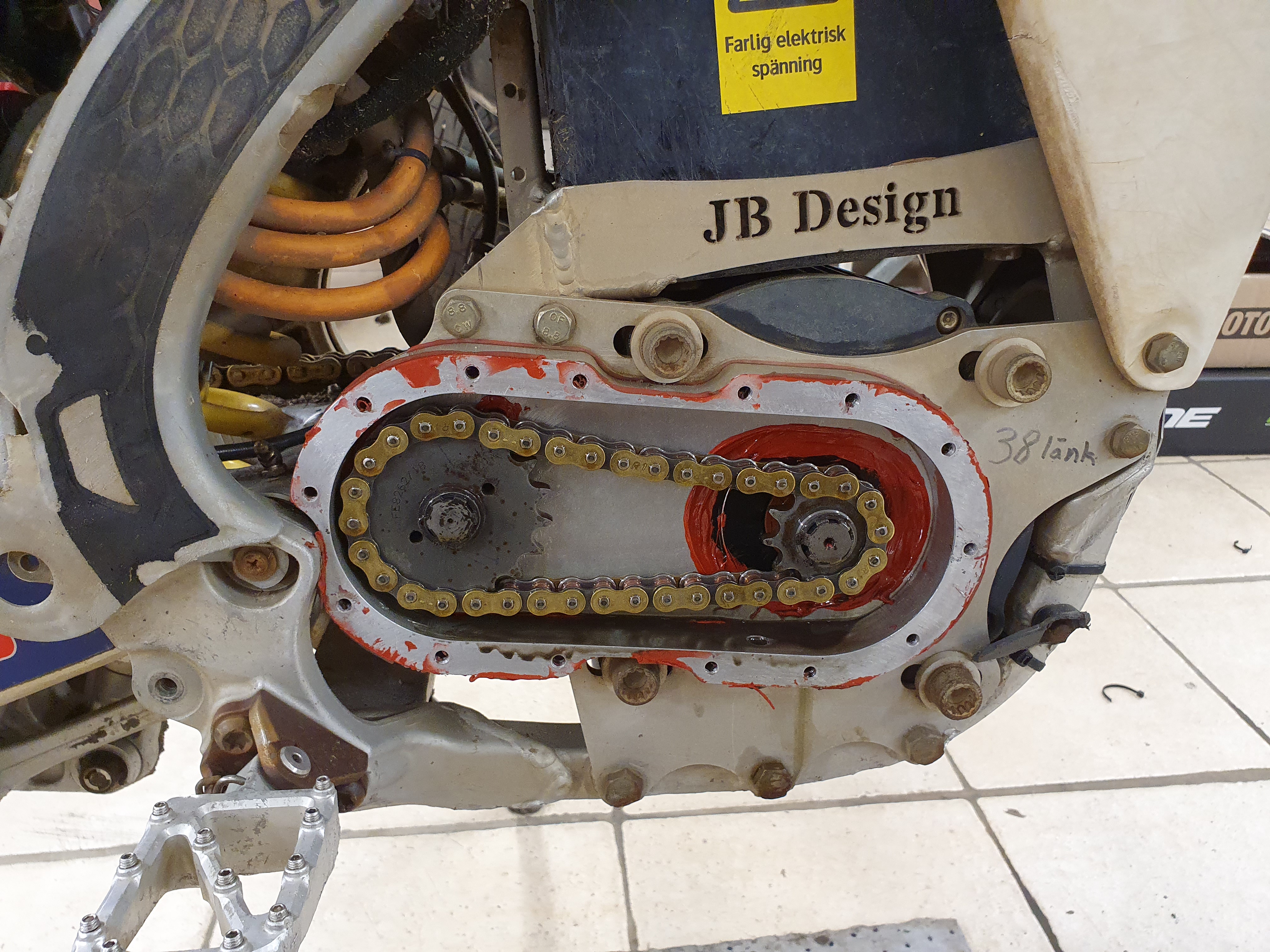

I recently had a look at the primary chain, I didnt see any note that I have checked since I changed the chain.
I probably had, there was almost no slack. I tensioned it a little anyway.

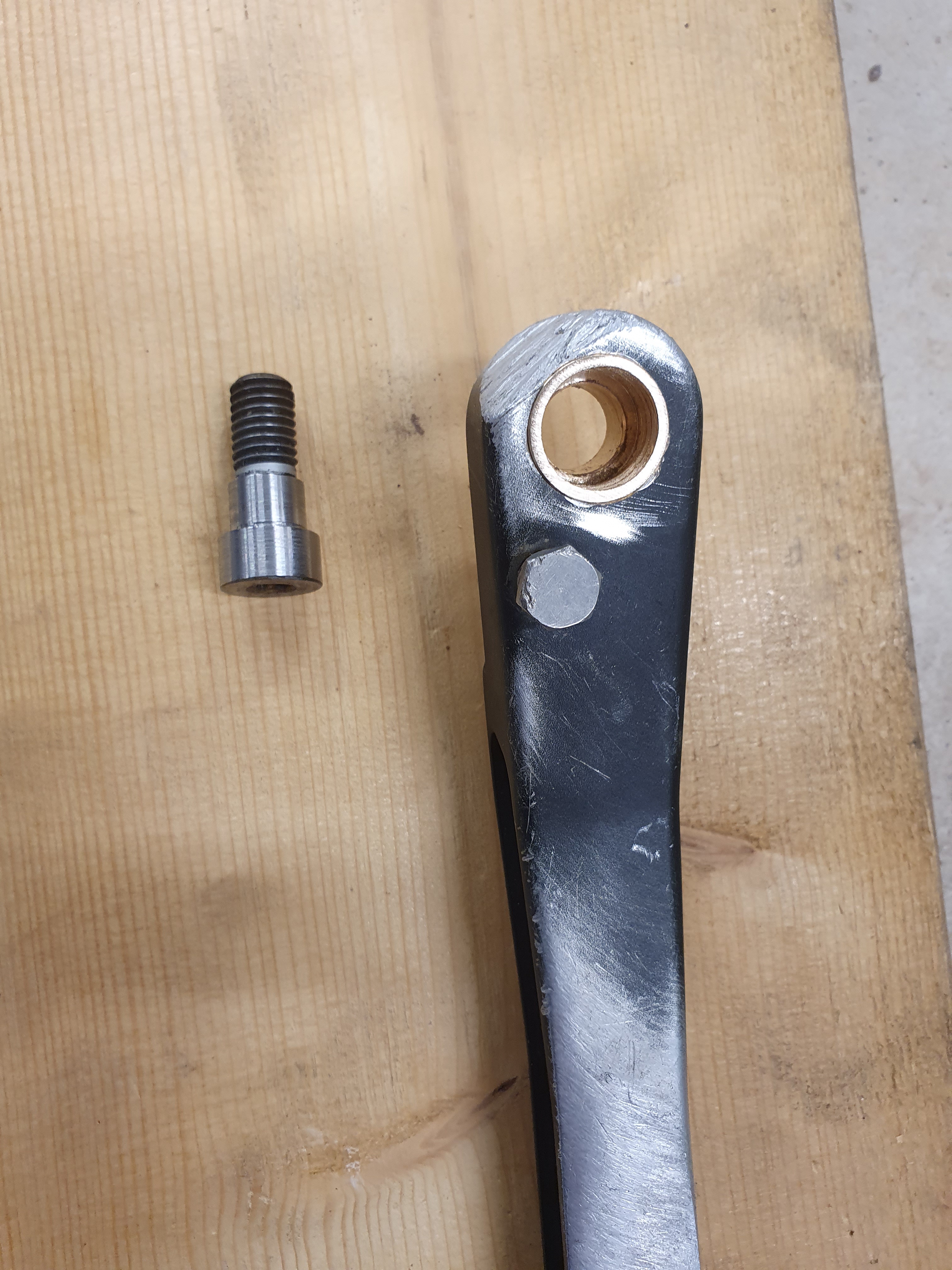

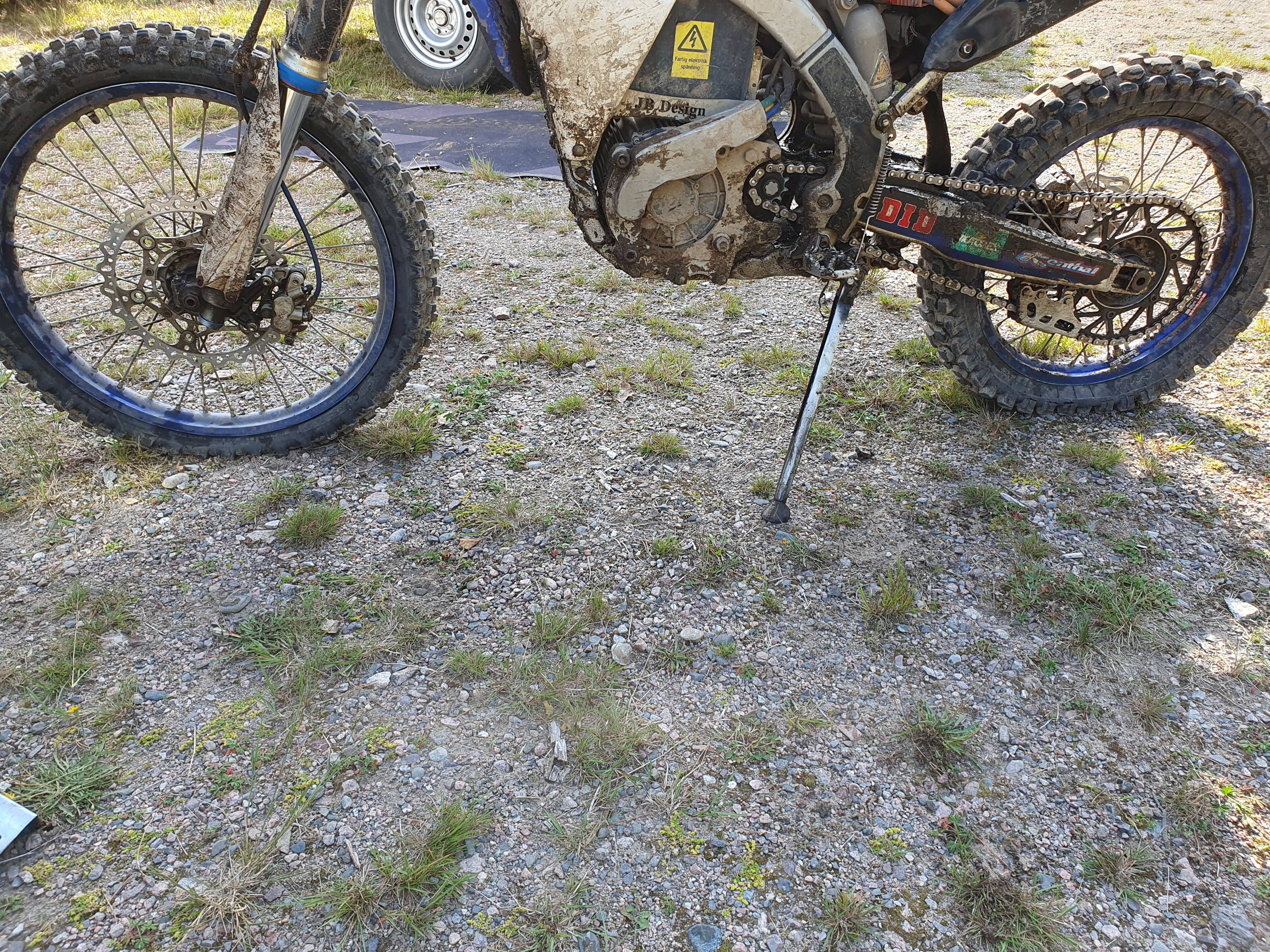

Finally I did something about the kickstand.
It had developed a significant play and would rub against the swing arm.
It was expensive when I bought it, and seems to be even worse now.
So I ended up making a bronze sleeve.
I didnt have the proper tools, but it seems like it turned out alright.
Time will tell ;)

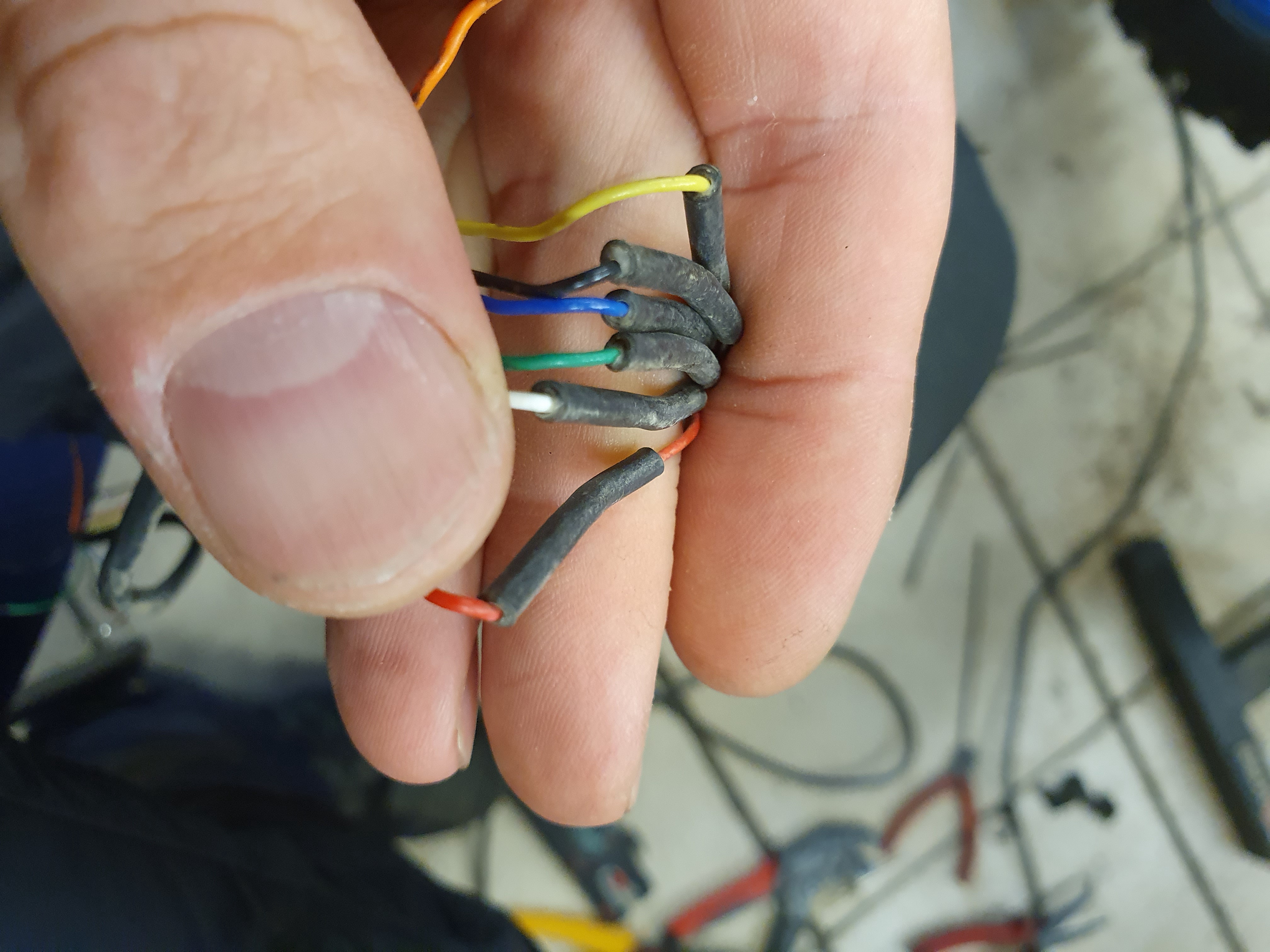

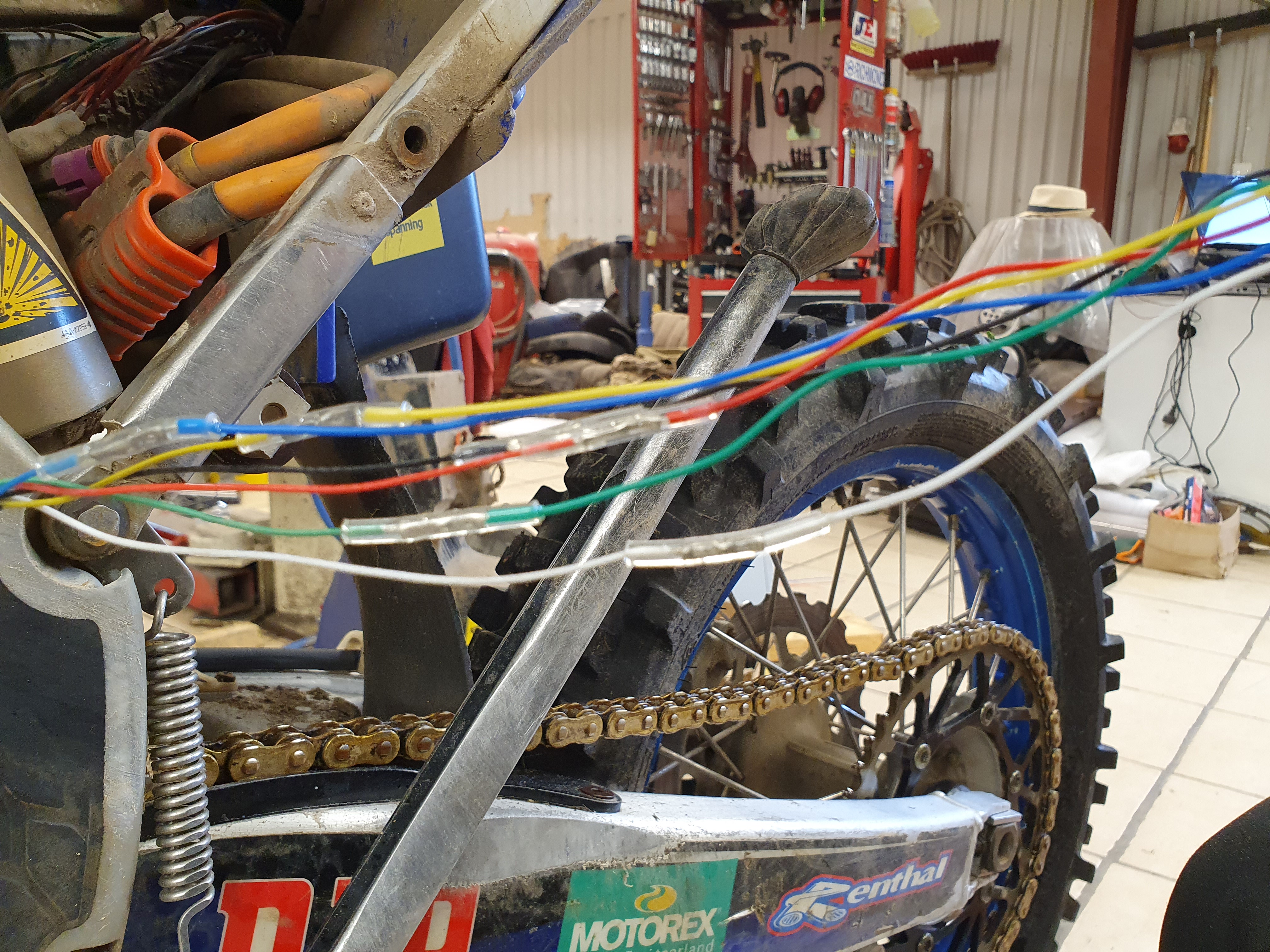

I got up and straightened the bark busters decently and tried to take off, but the bike wouldent run 😧
It just jerked like when there was a connection problem with the motor position sensor.
I tried to fiddle with the wires but it didnt help, I had to give up 🤬
When got up to speed the bike would run fine. And often very suddenly from stuttering badly to taking off at 3/4 throttle or something, almost throwing me off. I got back to the pit, and then the bike ran just fine again off course :rolleyes:
After a wash, still fine.
I opened up the wiring and pulled on the wires with no problem. But eventually when pouring water on the joints and at the same time pressing them together or against the frame I was able to recreate the problem, and do the same thing a few more times for confirmation.
Very annoying to have a problem with the same wiring again, but at least better than if it was the controller or motor.
I used shrink tube with glue the last time, but I suppose it wasent enough.
The wires have a hard, slippery surface. That dosent help I suppose.
What I did this time is use "press and melt" joints. I suppose it is the same sort of hot glue as the shrink tube, but these are transparent so you can see that there are no air or anything like that.
I also spread out these joints and made new wires all the way to the controller.
I put a shrink tube over this and filled up with silicone sealant (RTV).
I was hoping that when heating the shrink tube it would press the silicone everywhere inside, but the shrink force was a bit weak.
It filled out in both ends at least. This is getting ridiculous, I really hope it works this time :rolleyes:

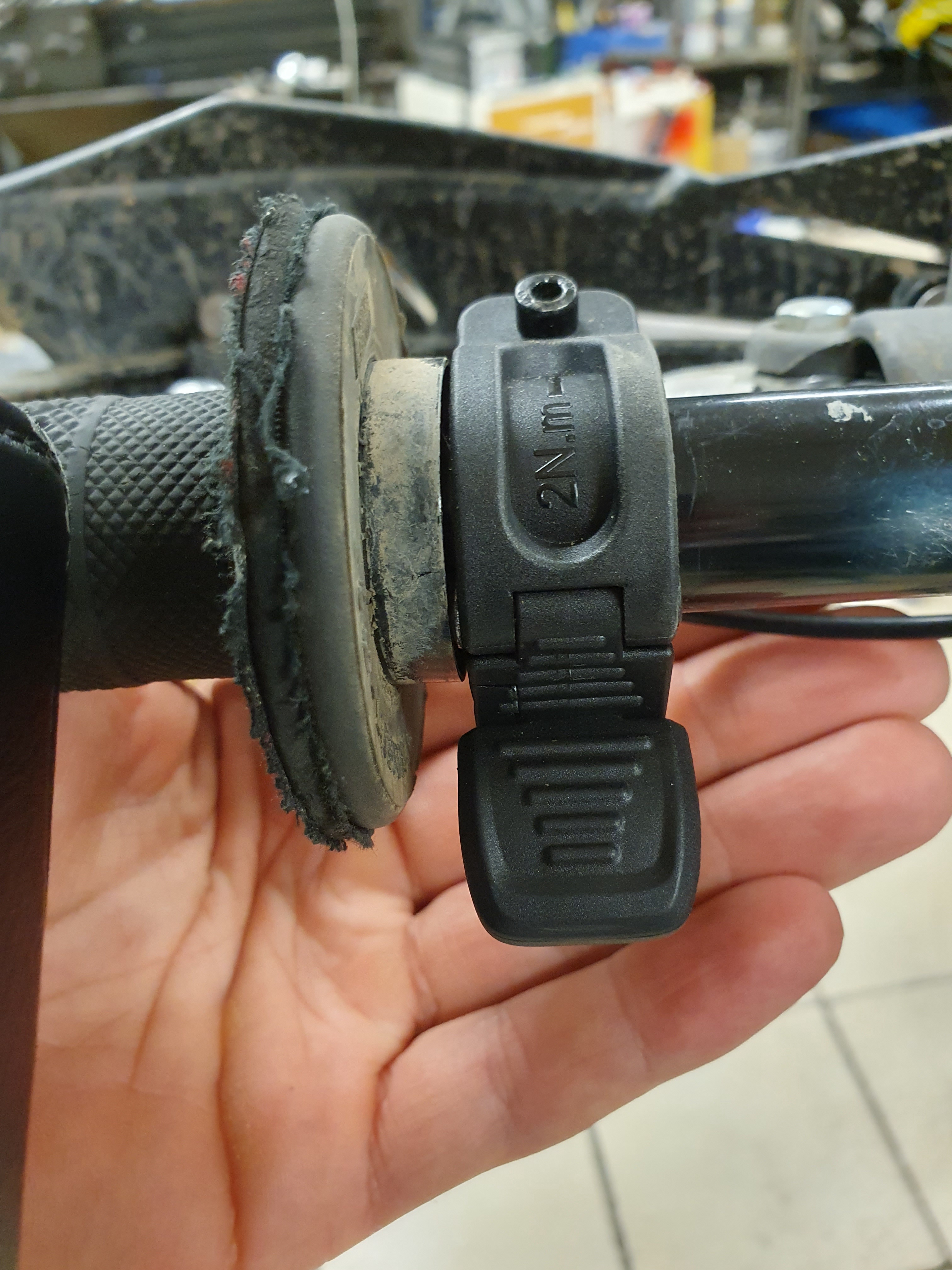

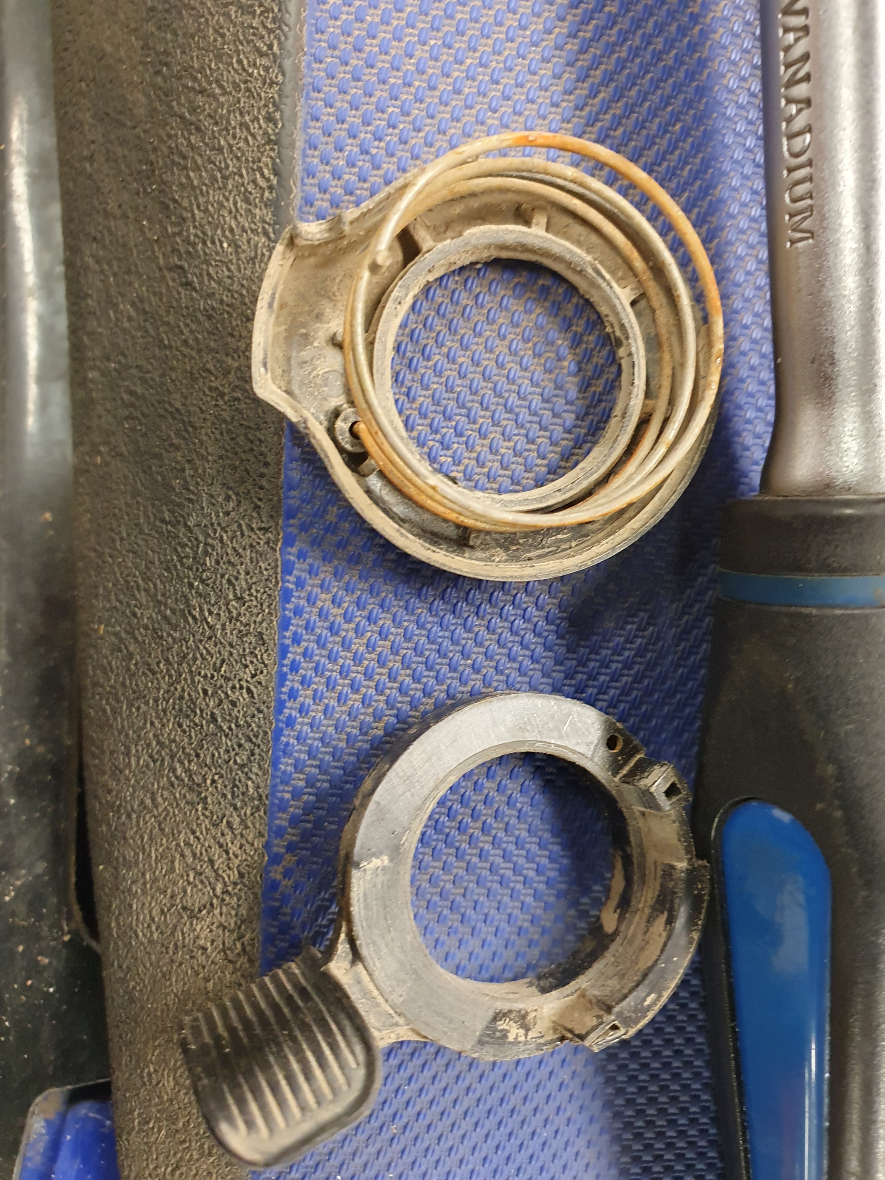

My regen brake thumb throttle has getting stuck rather easy lately when it is mud or wet sand on the track.
I decided to see if I could so something. It was rather dirty and the surfaces where it glides were scratched.
I cleaned it a little and tried to put some extra tension on the return spring.
I shortened it maybe 25mm, but it turned out it got too small and would jam halfway when pressing the lever.
I ended up just changing it, and trying another model this time.

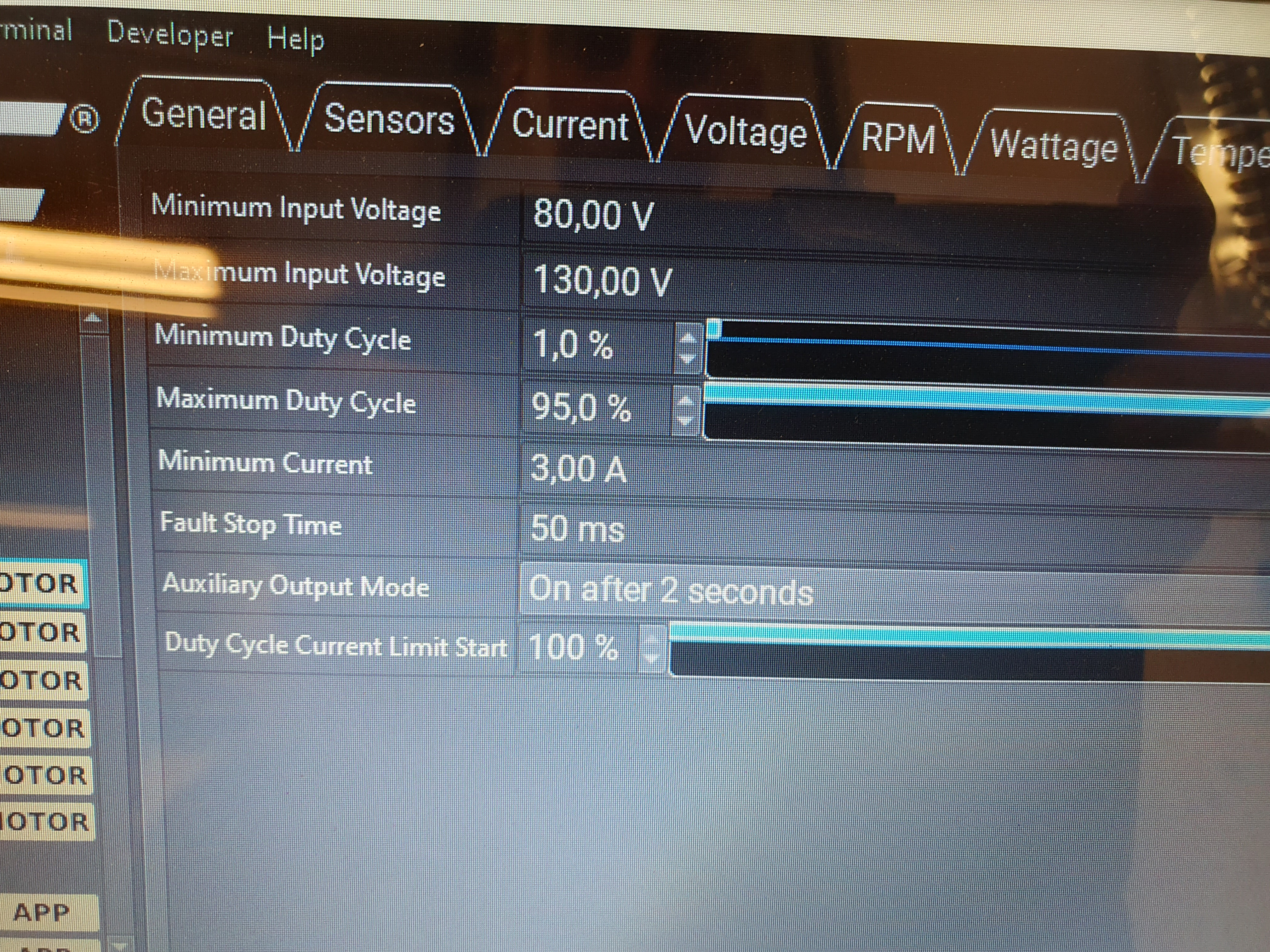

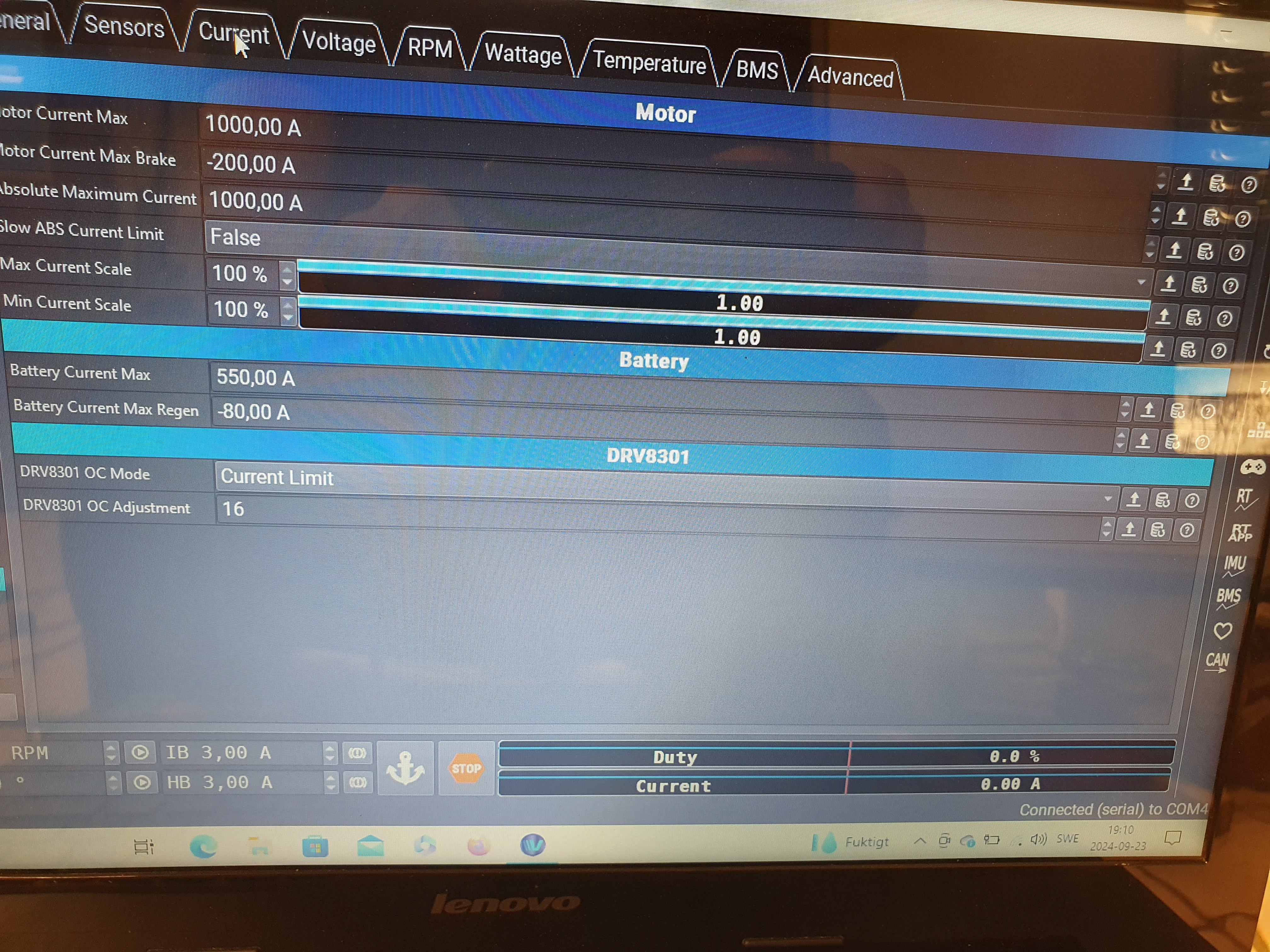

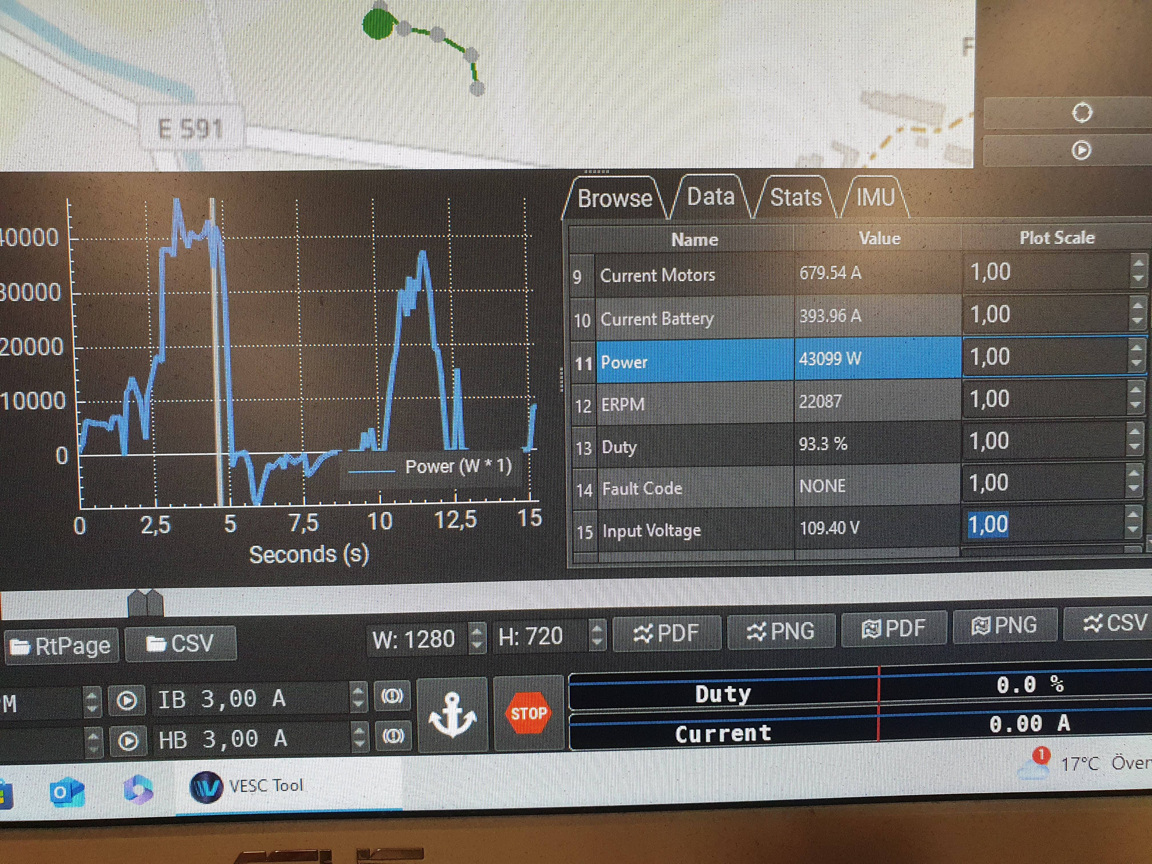

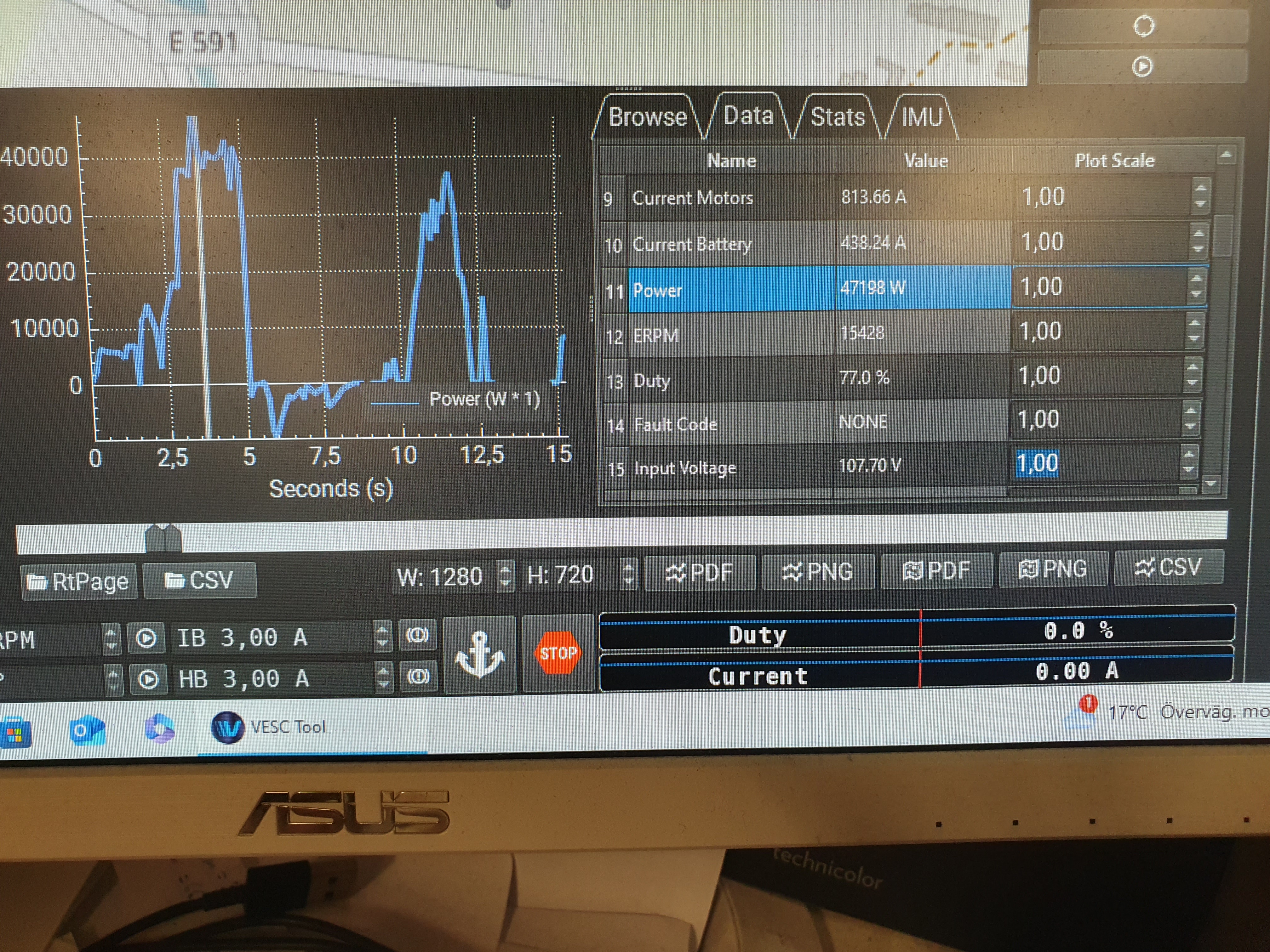

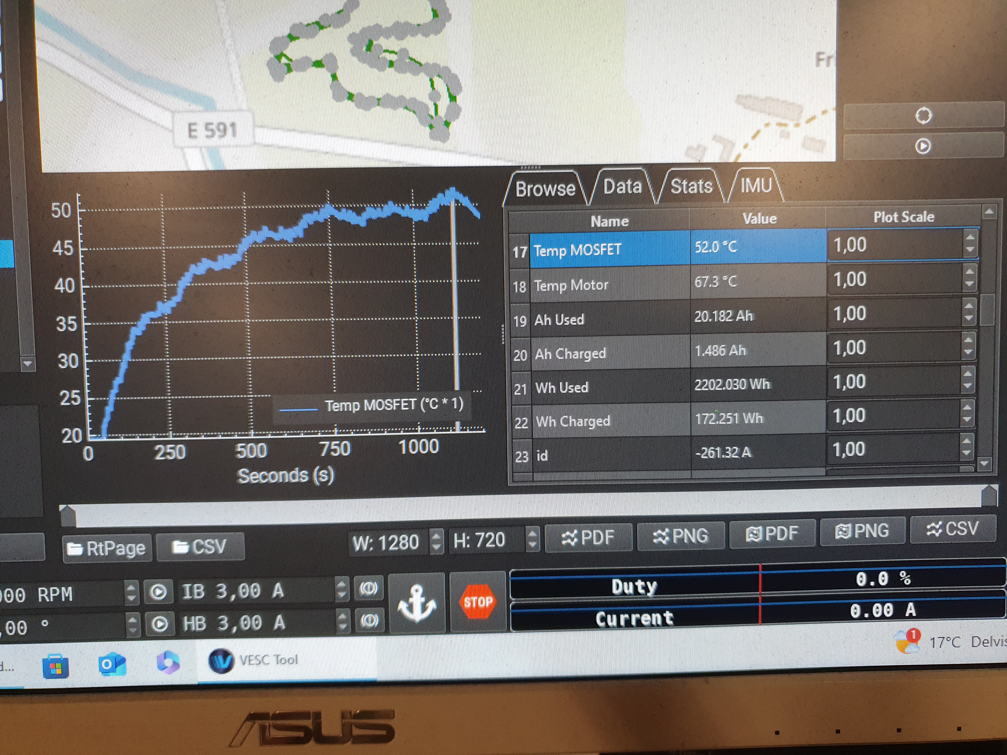

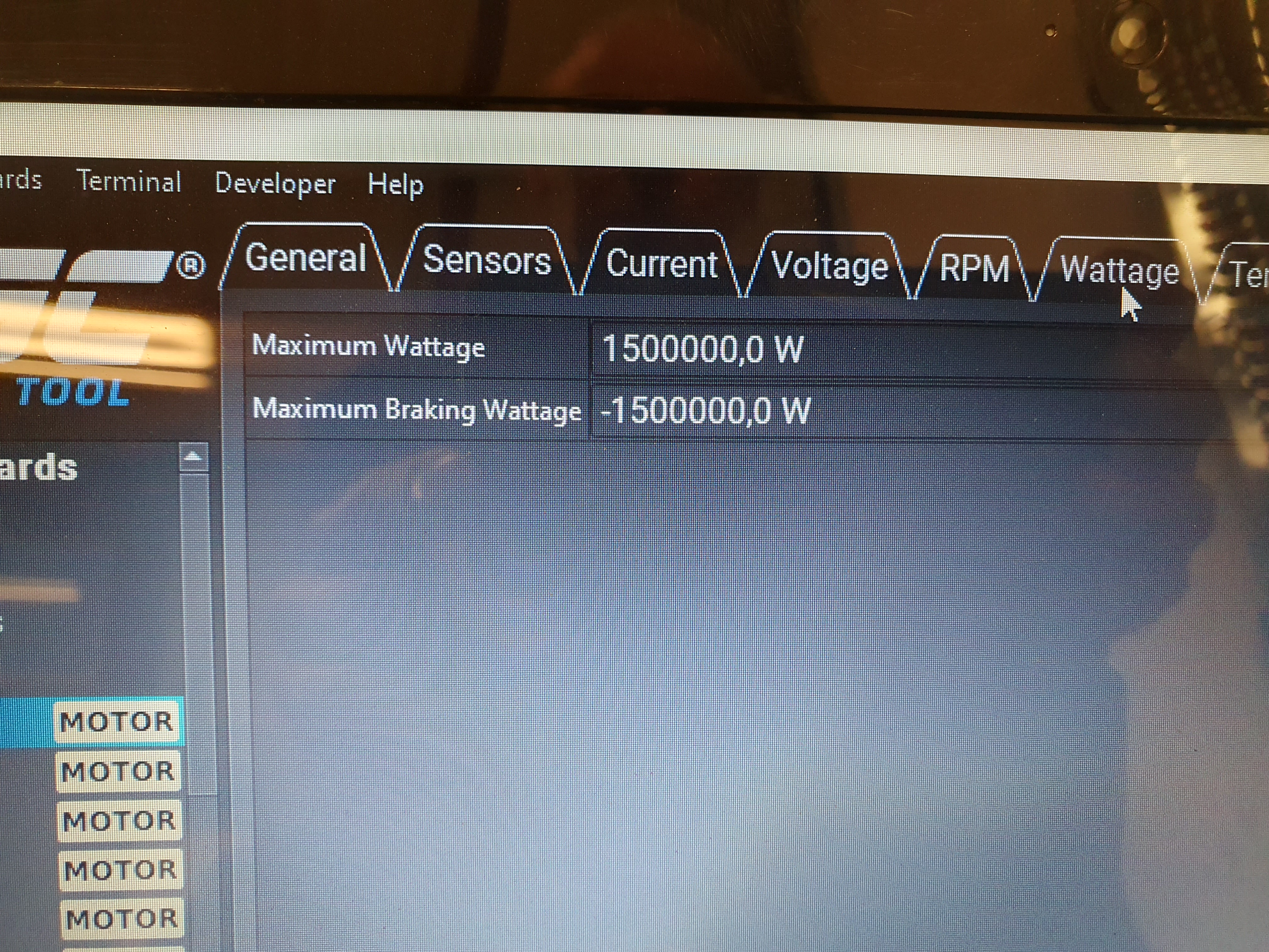

I have a log from the final that might be interesting to some here:
Mosfet temp, I suppose the motor temp curve looks similar.
