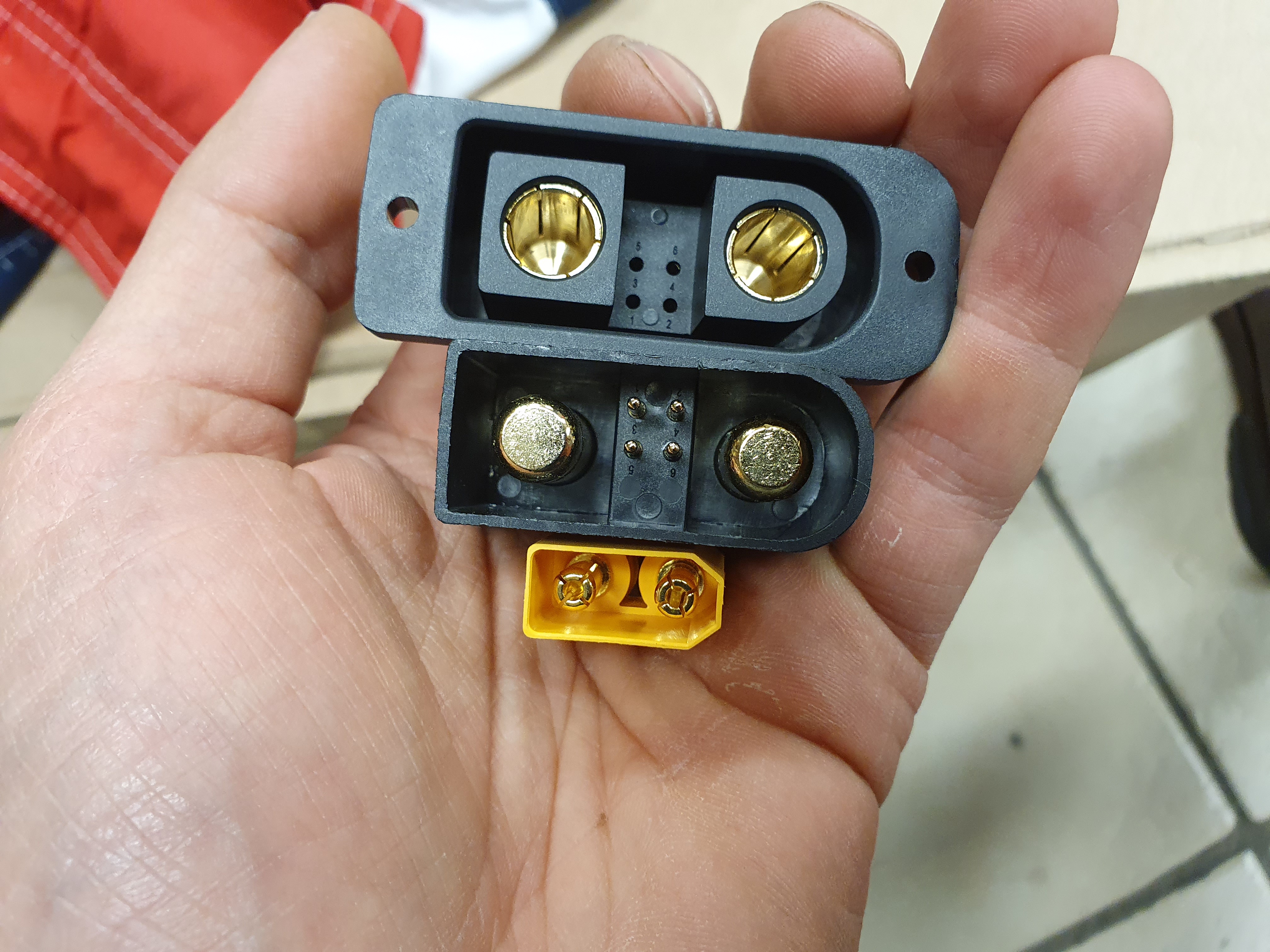

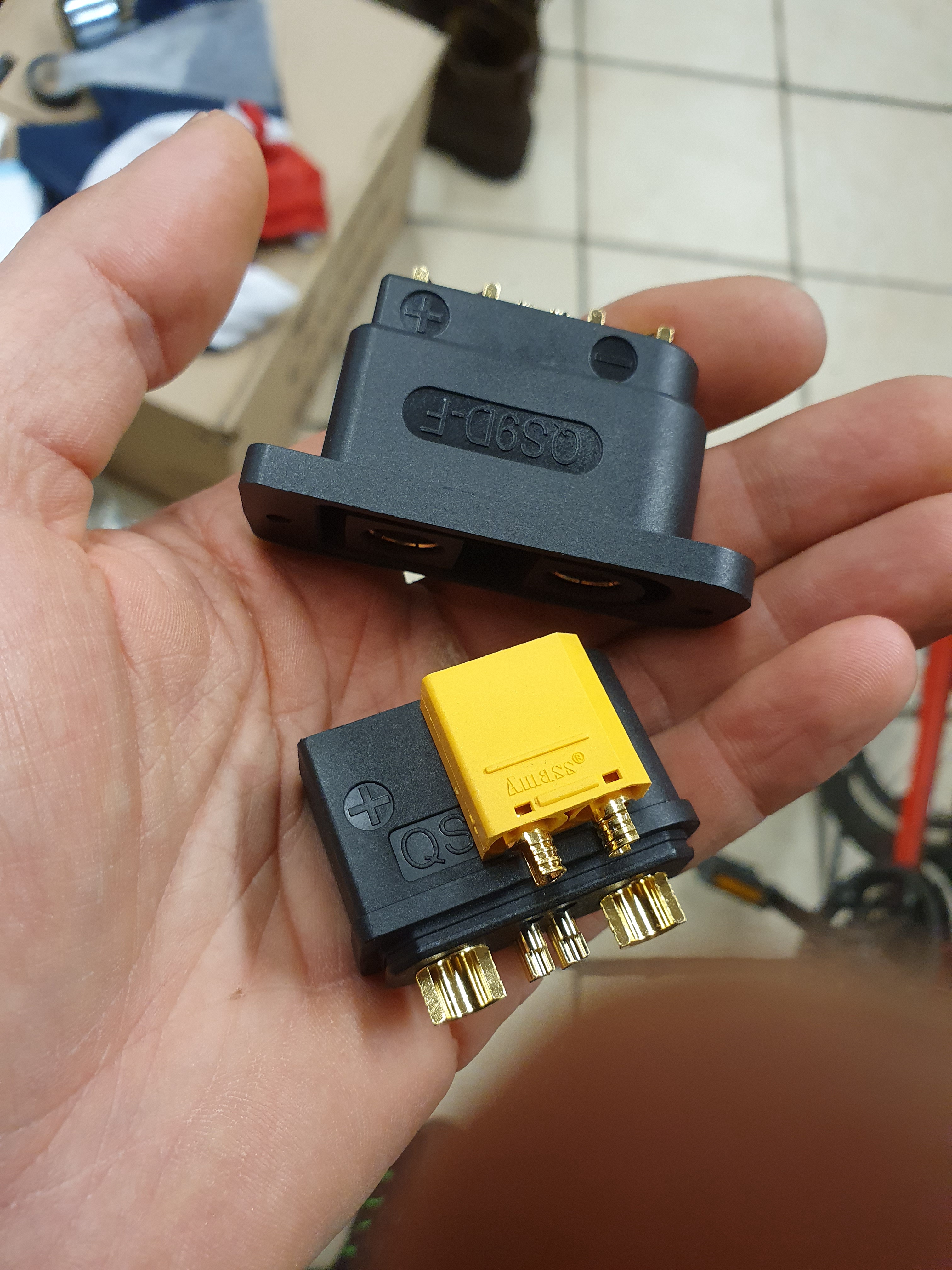

I got the QS9 connectors today, those frockers aren't small either :oop:
A XT90 for comparison.
There is a 5,2ohm pre charge resistor built in.
Those QS12 connectors are looking more interesting for discharge connectors after I got these🤔
I would like something like this with a mounting flange, but I havent seen that in the bigger connectors I think.
With this pre charge built in I could probably skip the whole contactor business, and just pull and plug in with power in the circuit.
A little less safety in exchange for simplicity..

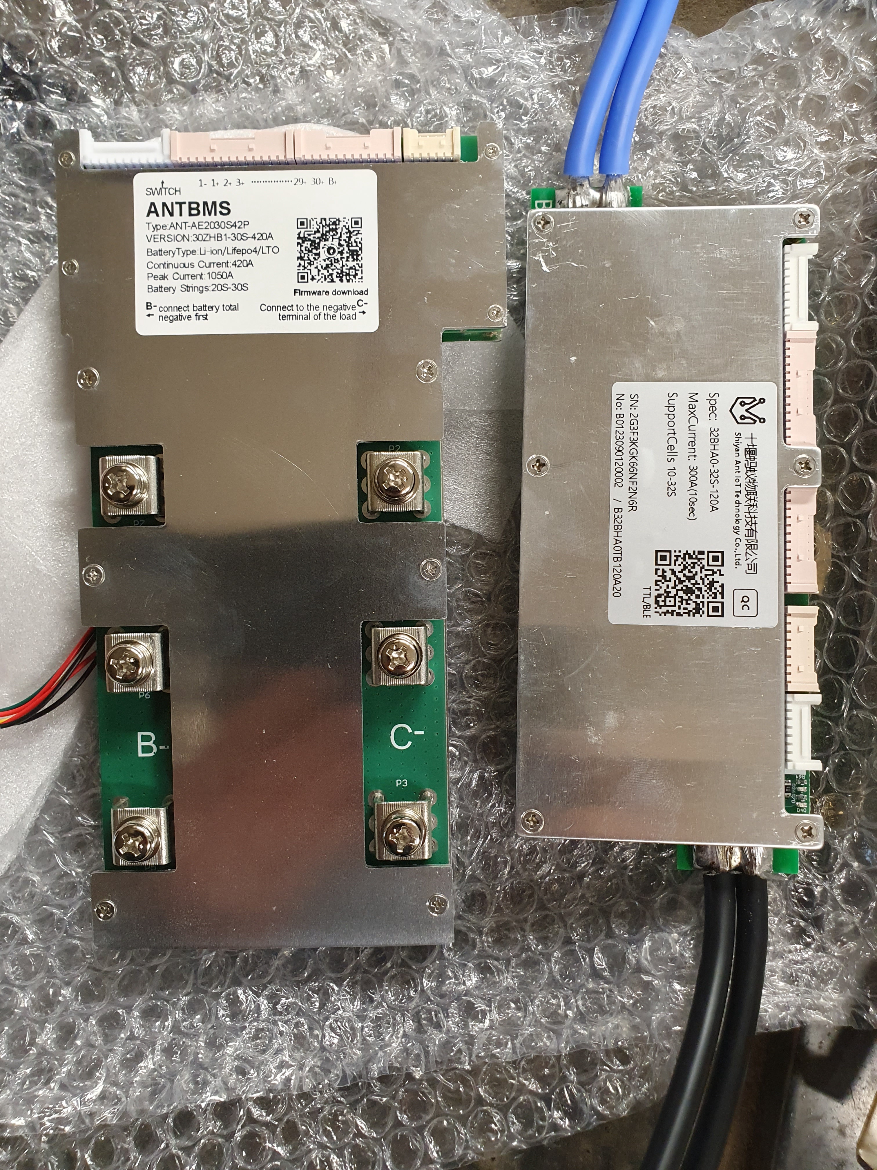

Finally my bms:es arrived:
After all the back and forth I eventually just went with ant.
The big one is for this bike, the small is for the old one.
I´m thinking that hopefully I can get the controller and bms to communicate over Bluetooth, but if not it´s not a big deal.
I will just run these as they are, no bypass or modification.
It will be some challenge to fit it in the battery it seems.

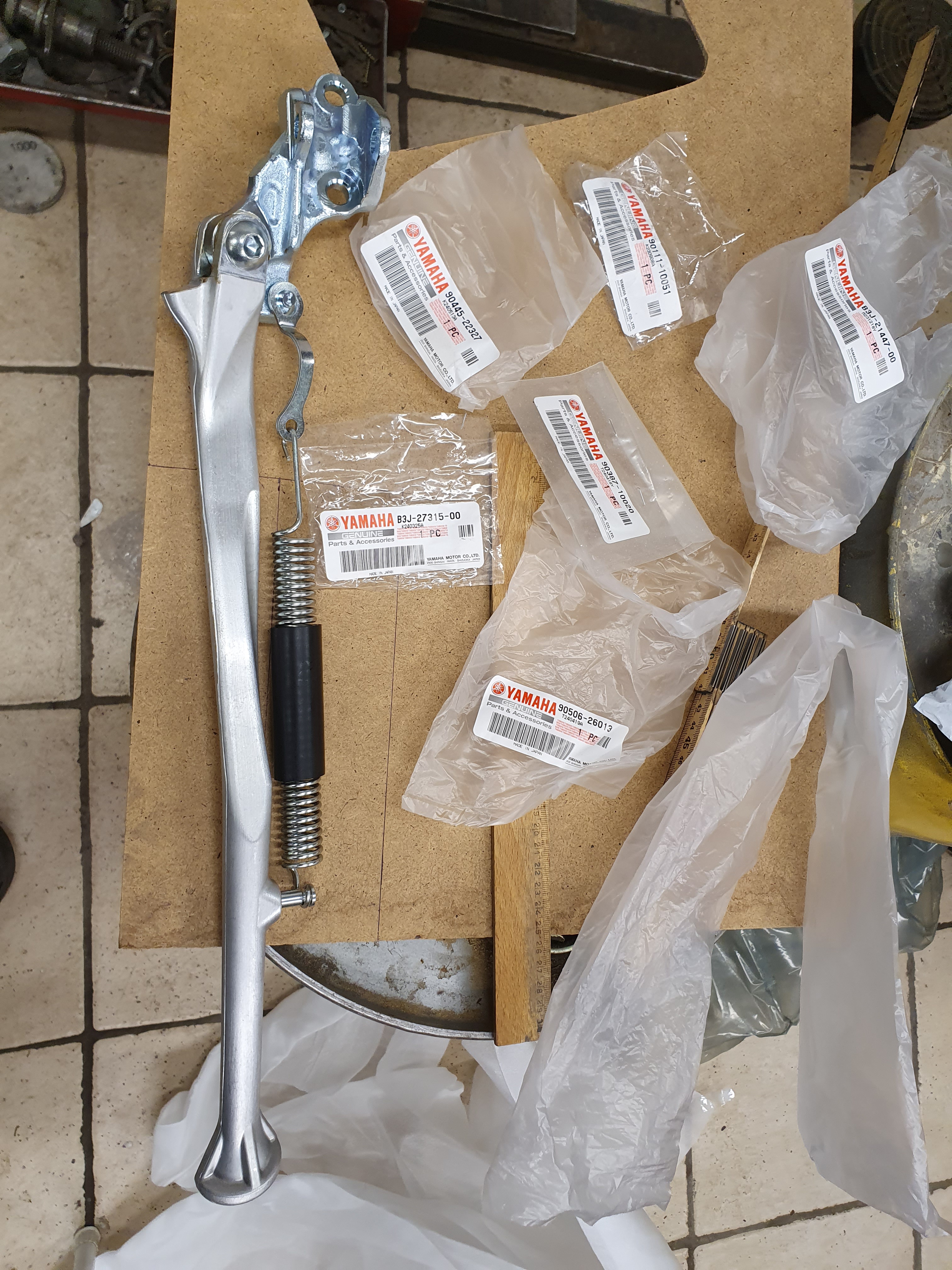

I want a side stand on this bike too, but Im not that impressed with the aftermarket stuff.
So this time I went oem and just bought all the parts.
As usual it wasn't cheap :rolleyes:

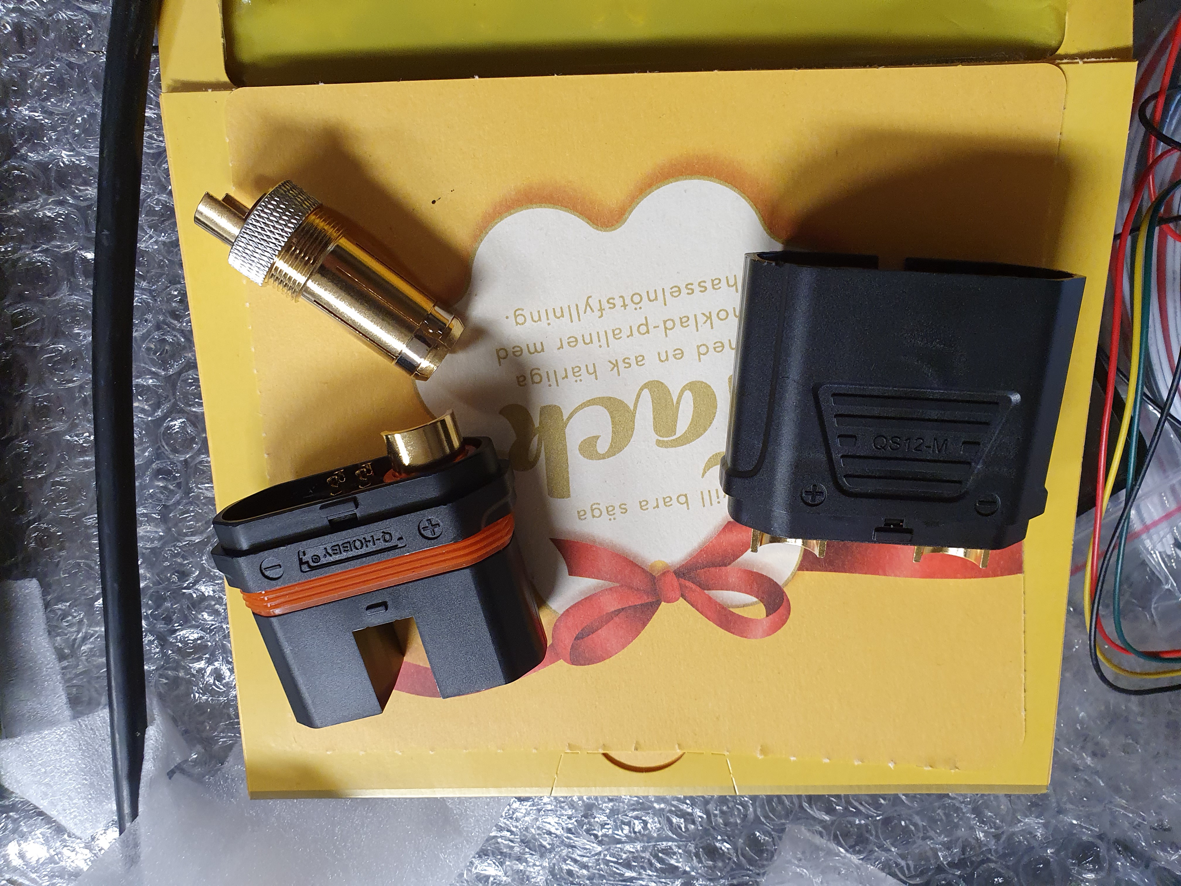

I got a pair of qs12 connectors today:
They seem better than I hoped :)
I dont know how they came up with the wire sizes, I tested 35mm2 and it fits just fine.
I wouldn't go smaller, it can probably take bigger. The hole for the wire in the pin is 10mm.
And as you can see you can remove the pins, they are threaded.
That sure makes it a lot more likely that I can solder it properly.
I wonder if that is possible on the smaller ones too? 🤔
It has a 15,2ohm pre charge resistor, strange that the qs9 has 5,2ohm.
It has a seal, but I wouldn't call it sealed..
There are gaps and and ridges that it cant seal, so that is mostly for show.

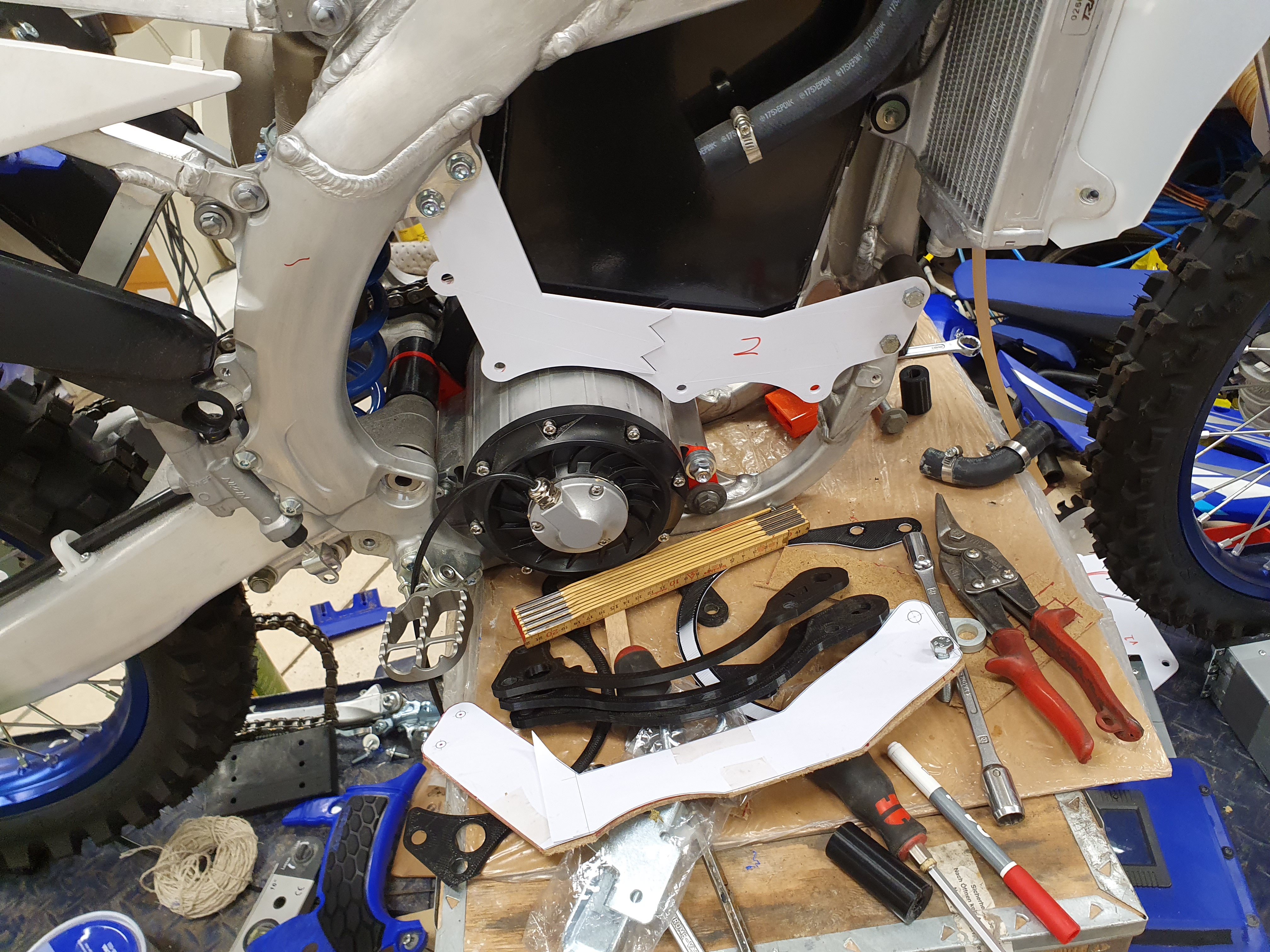

Then I have actually done something on the bike:

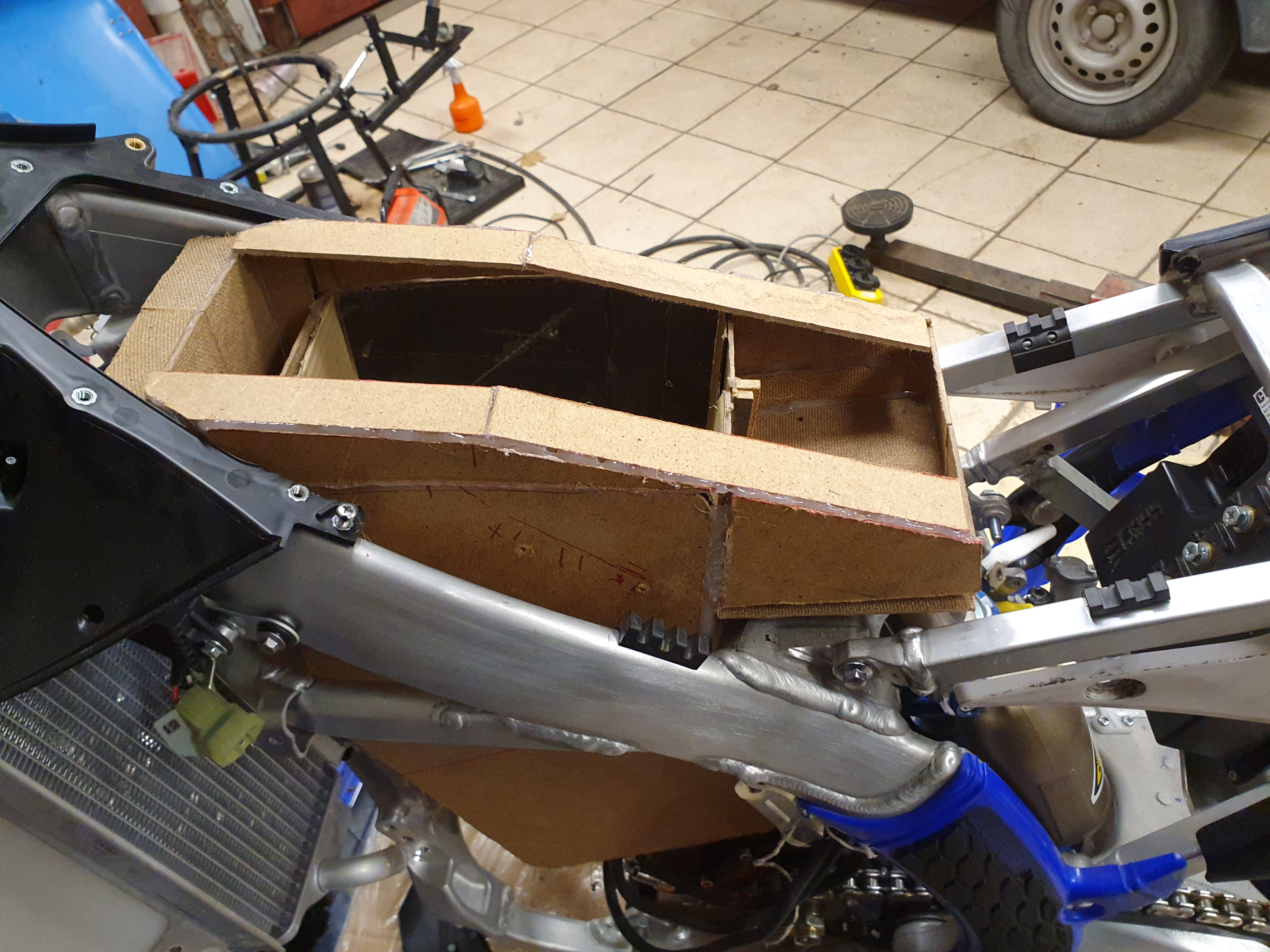

The battery box has got a pocket for the bms in the front, it seems like the only reasonable position.
I have an idea of making the battery mostly square, then make cover over it shaped as the gas tank that also holds it in position.
I have spent more time just looking at that damn box than actually building it.

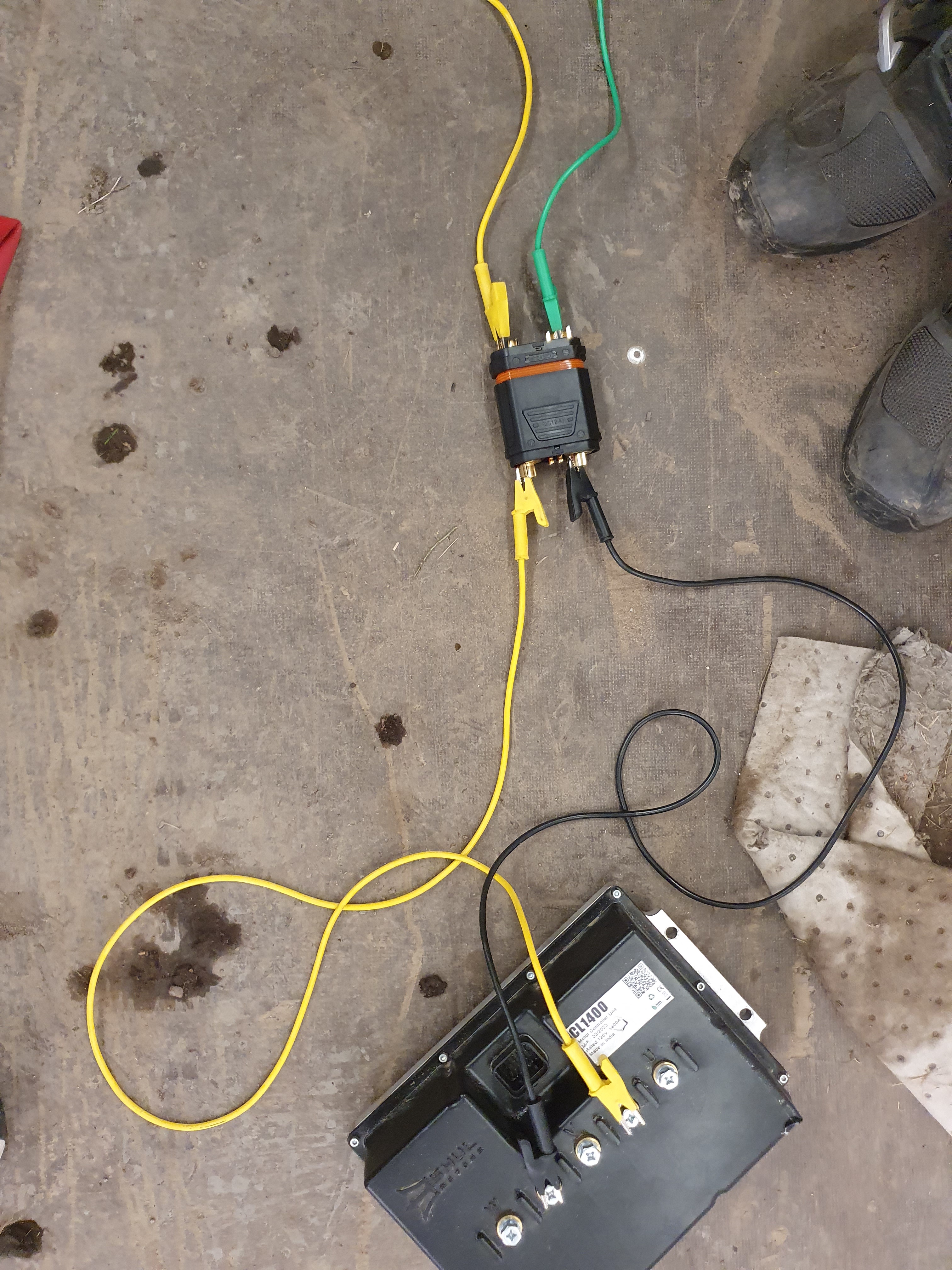

Not much new here, but I have done some pre charge tests:
So, trying to plug it in at a normal speed while not getting electrified :rolleyes:
I used a battery from the other bike at 120V, so pretty normal circumstances there.
Seemed to work just fine, I didnt hear any spark or see any traces of arcing in the connector afterwards.
I think I will use this connector, well there is at least one problem left. Soldering 35mm2 wires:confused:

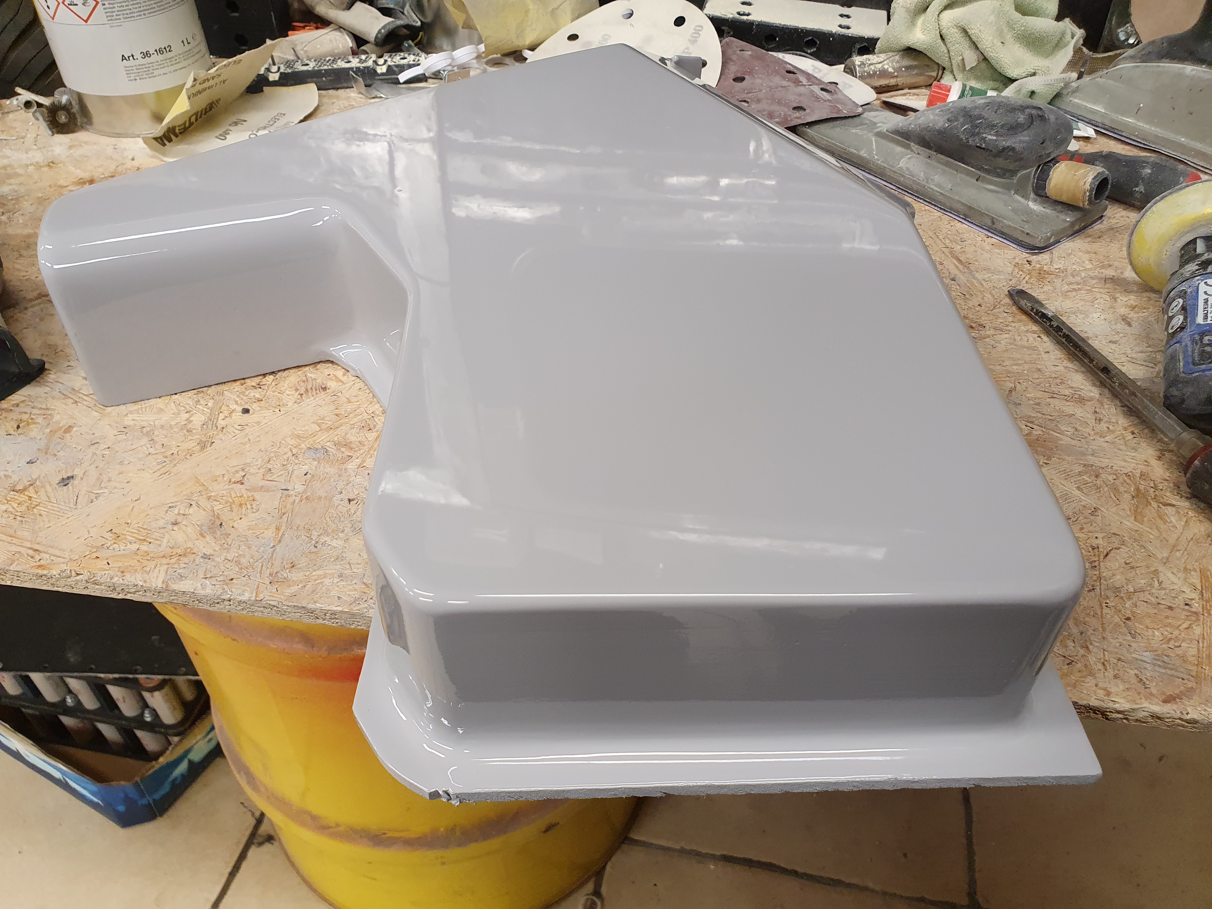

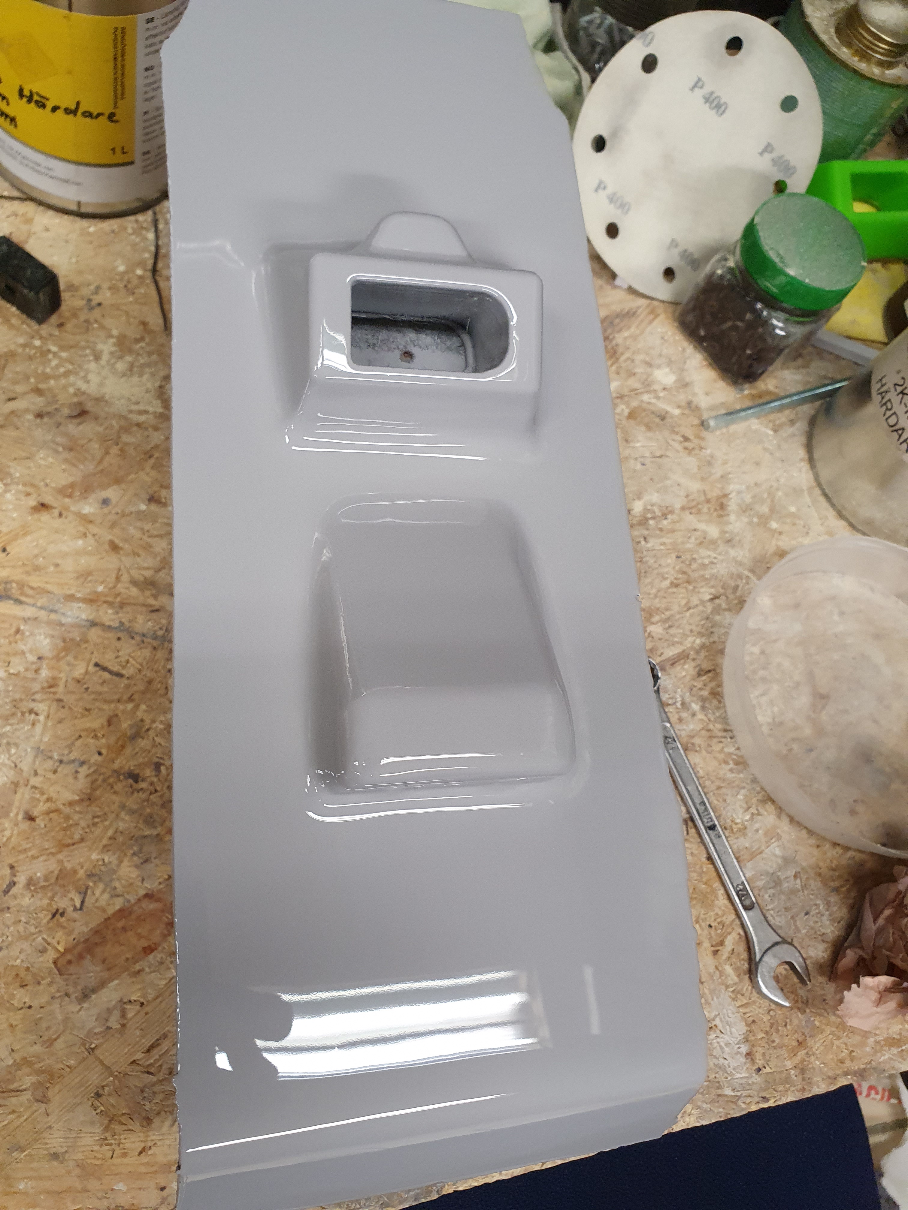

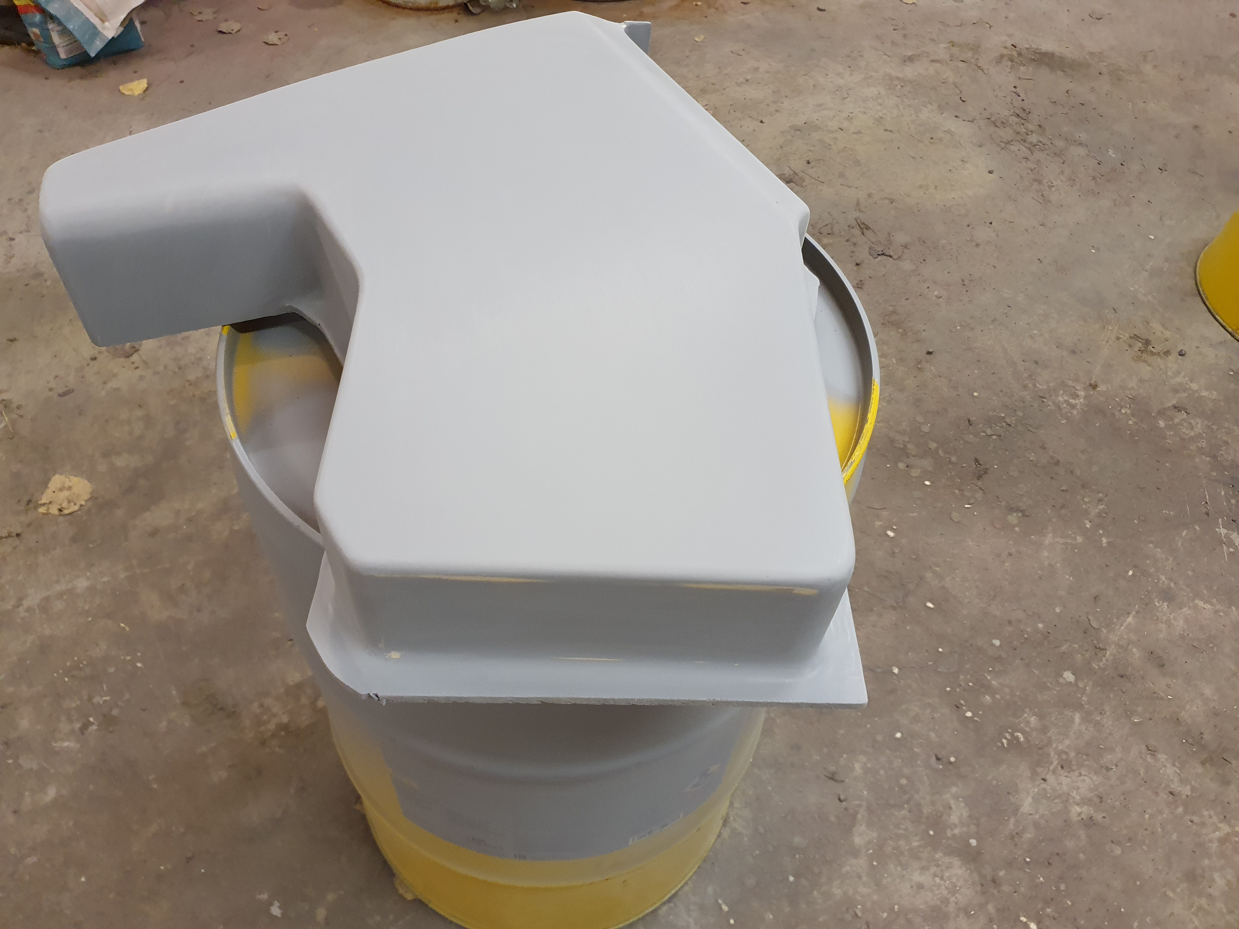

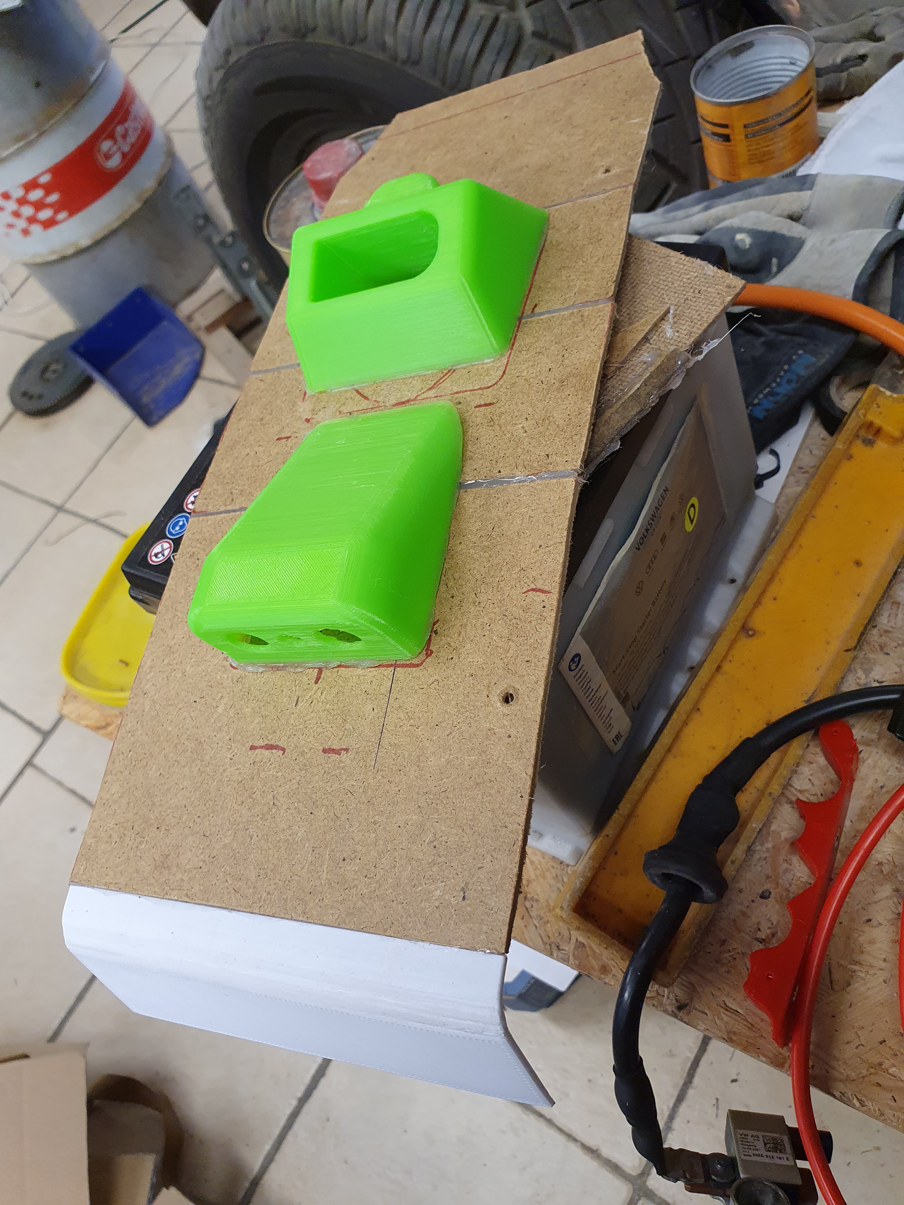

Working on the model for the battery box..

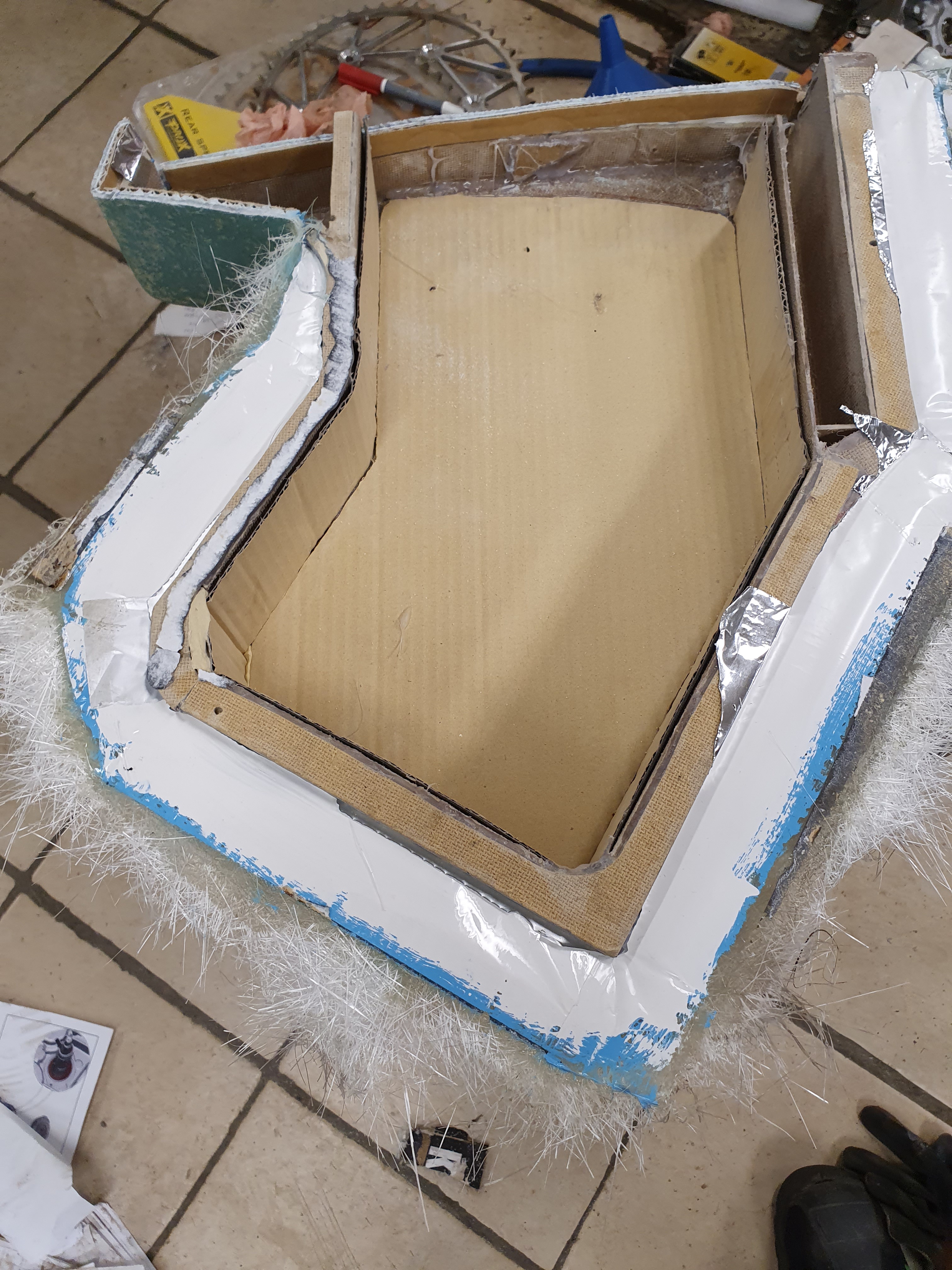

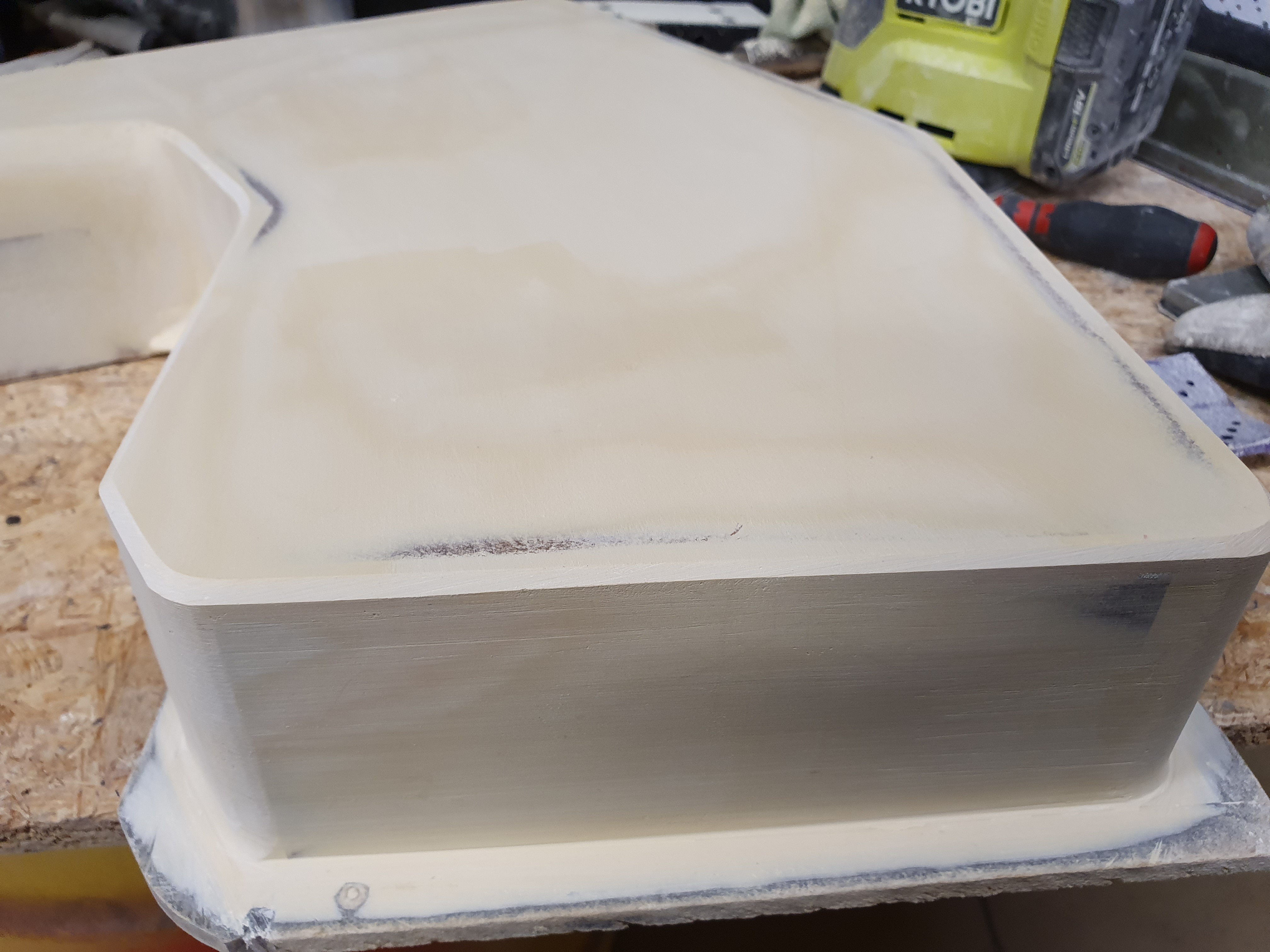

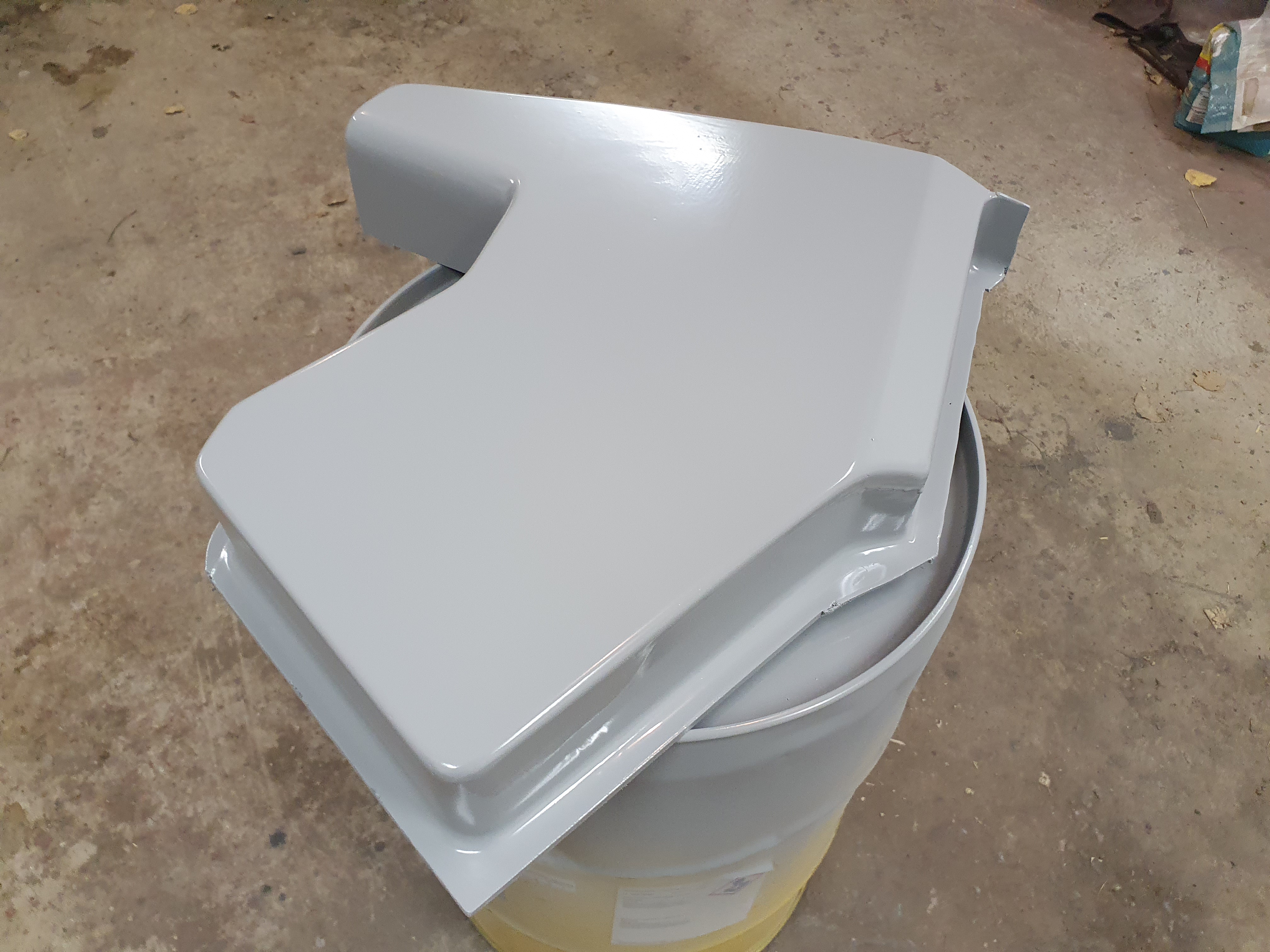

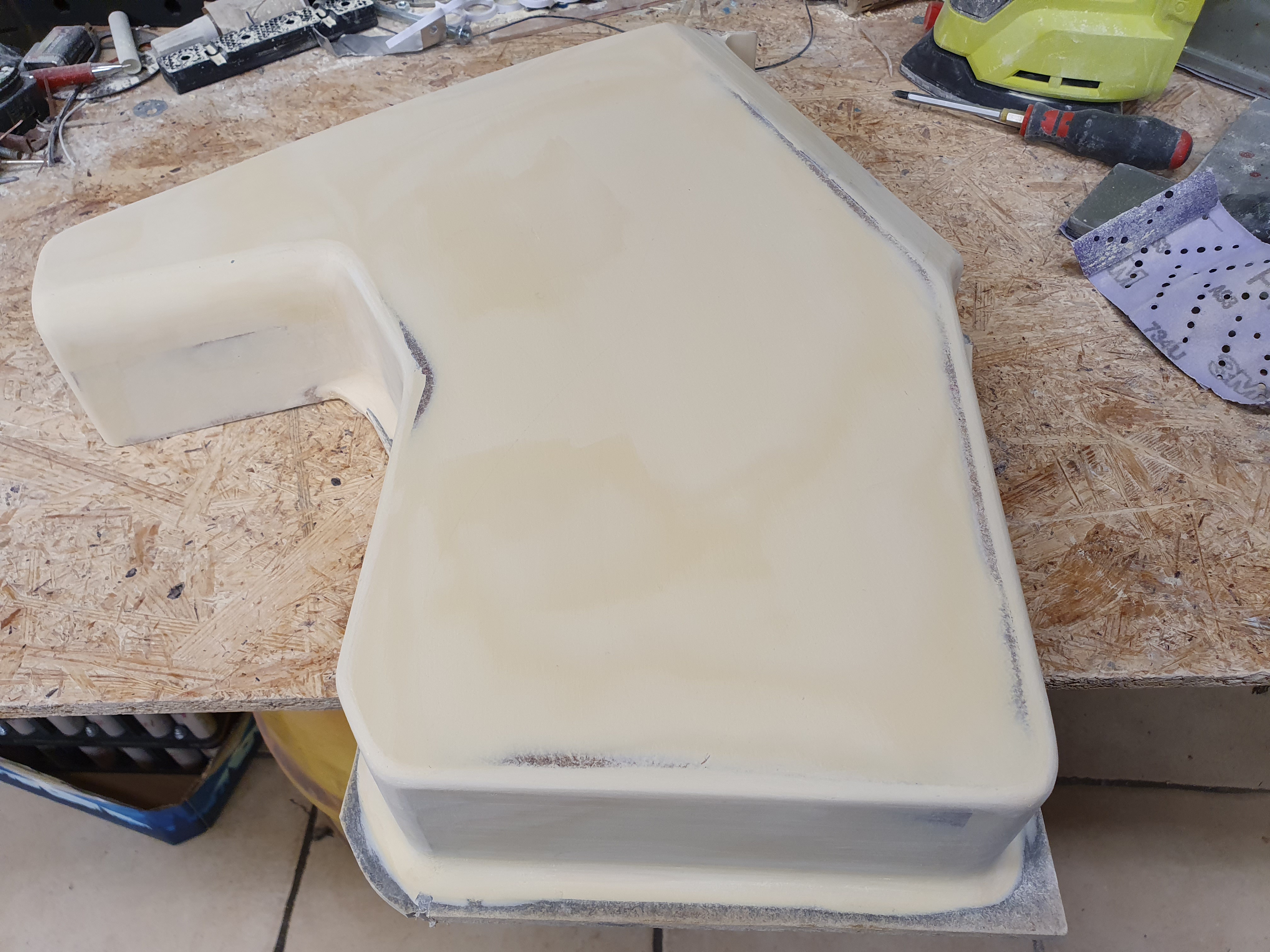

Step 1 of putty and sanding is finally kind of done:
It is amazing how it can take like 5 times more to get it even and strait when you think it is the last time :confused:

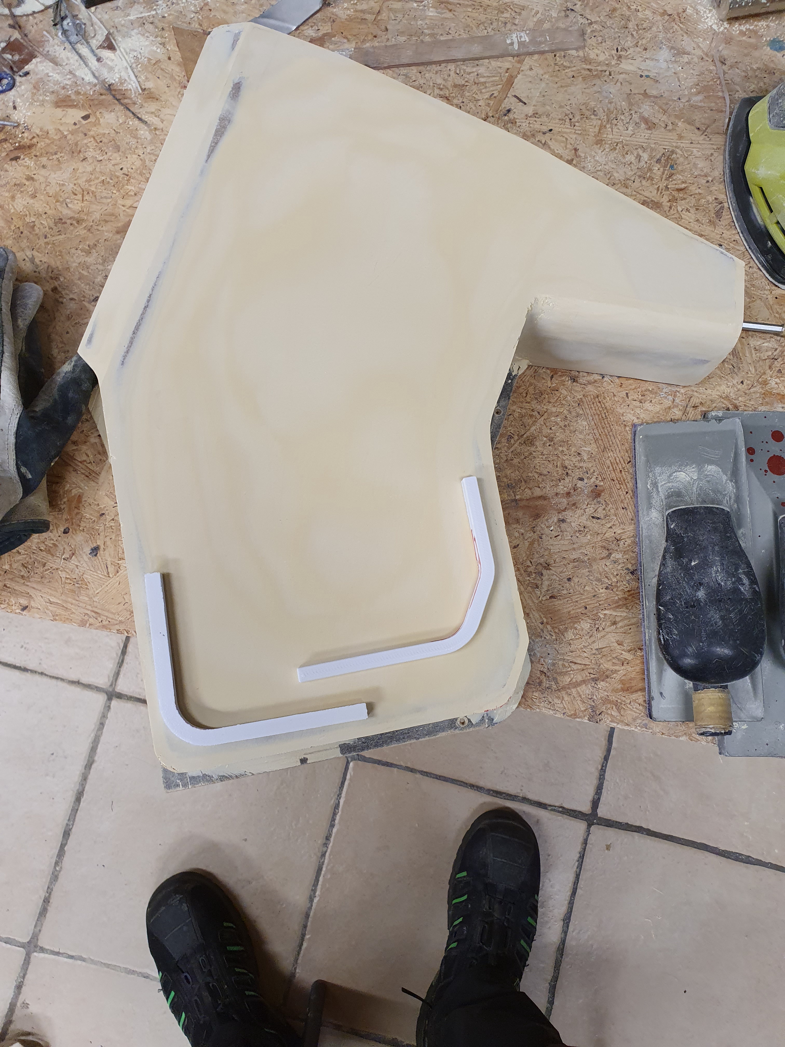

First I do all the edges possible sharp to see that everything is strait.
I made those white plastic tools to get the rounded corners in the bottom right that I couldn't do strait.

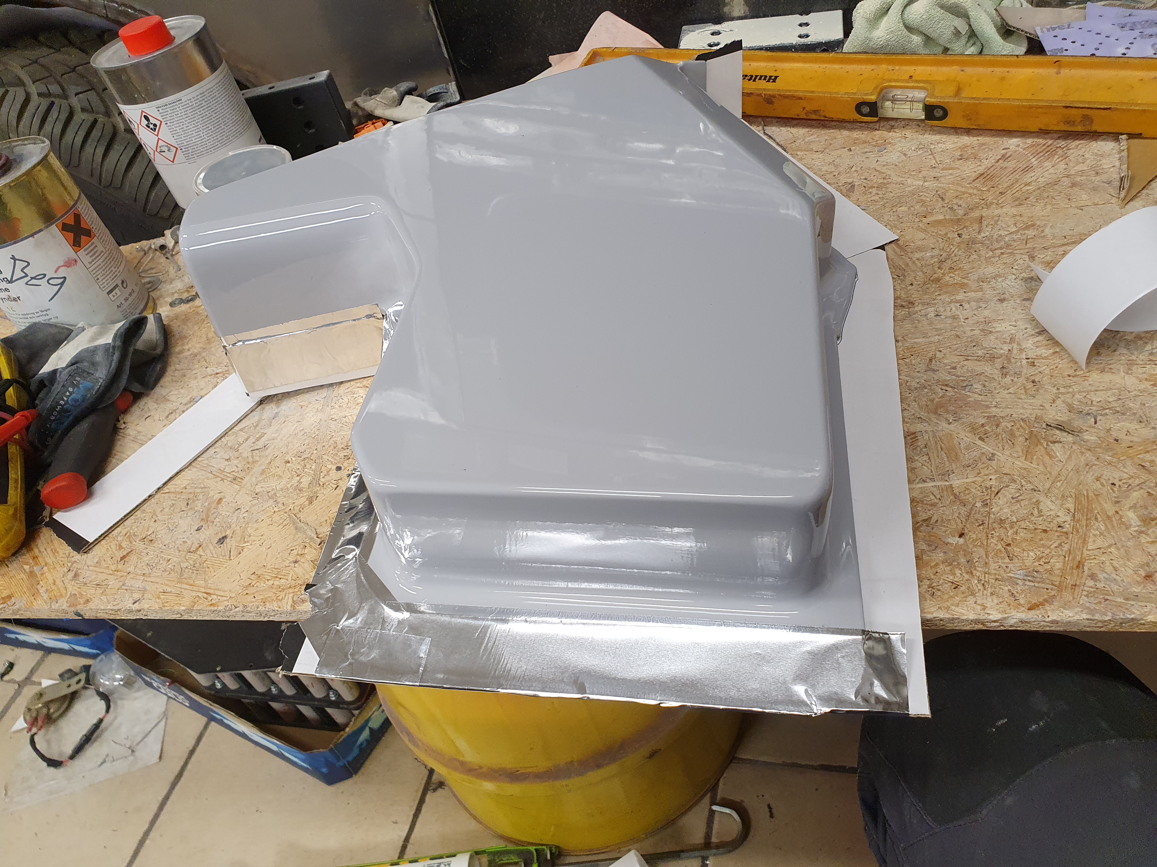

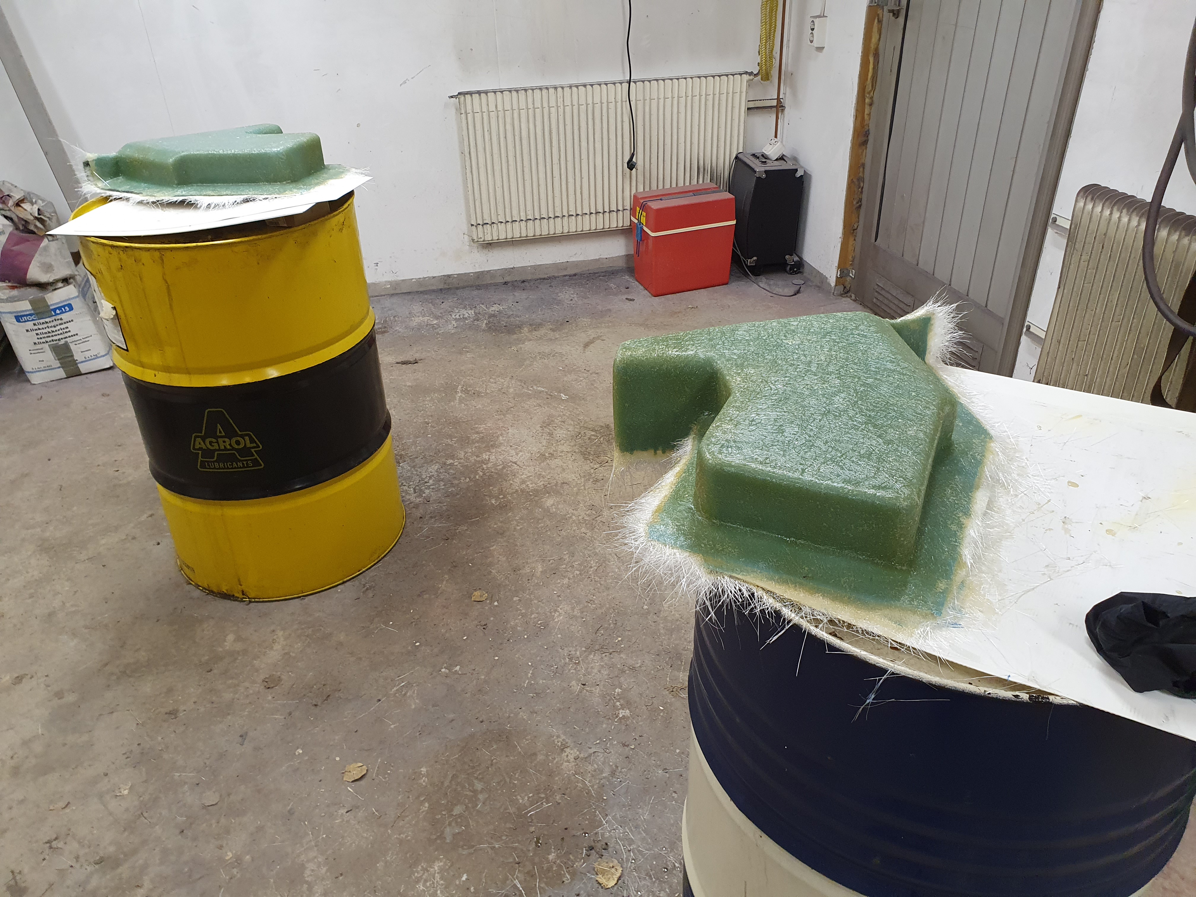

Step 2 is to sand a 45 degree edge all around:
This way I can see that I take about the same everywhere.
Preparing with some extensions on the edges:
It is nice to have some extra that can be cut off, both on the mold and the finished part.

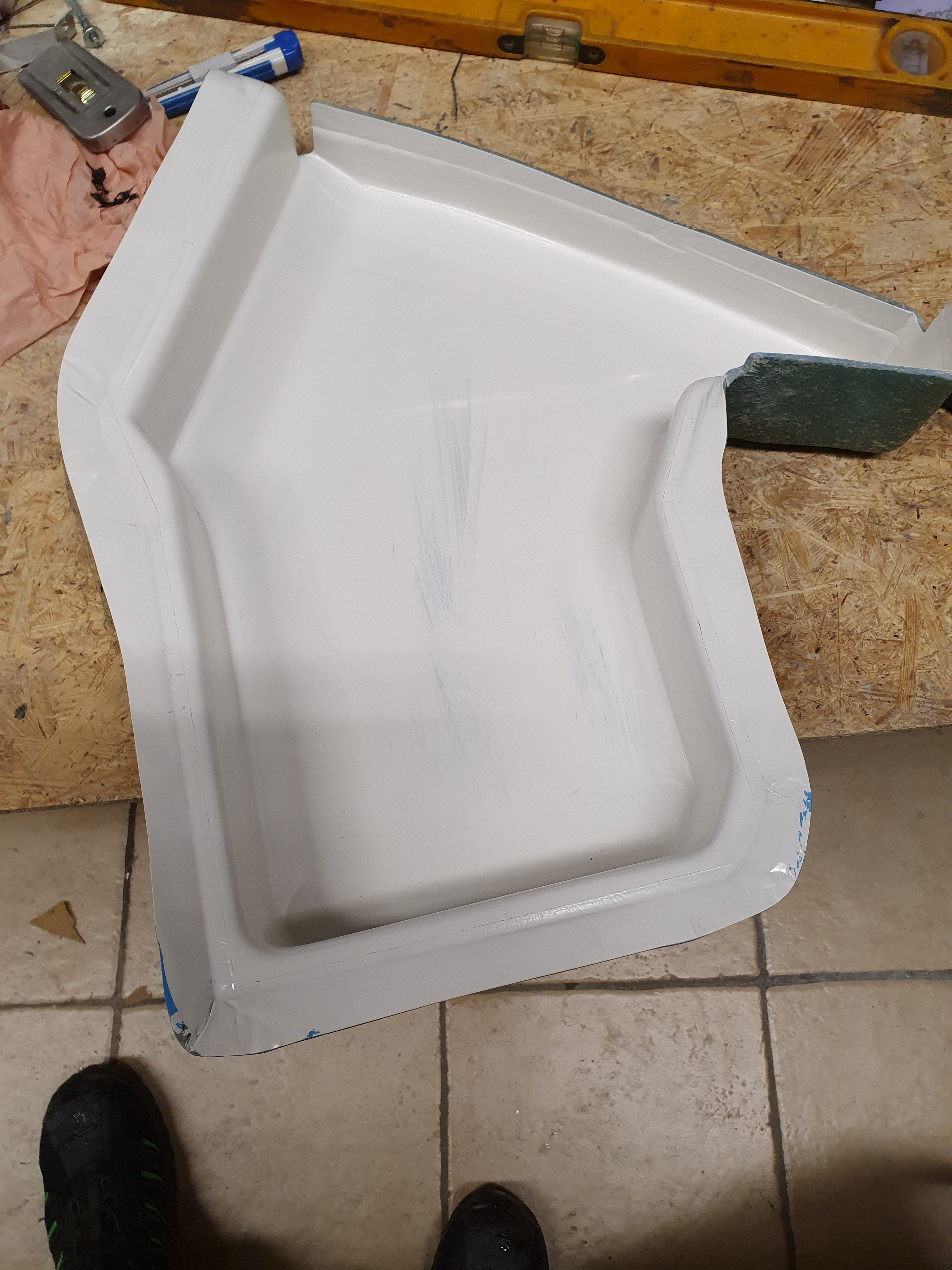

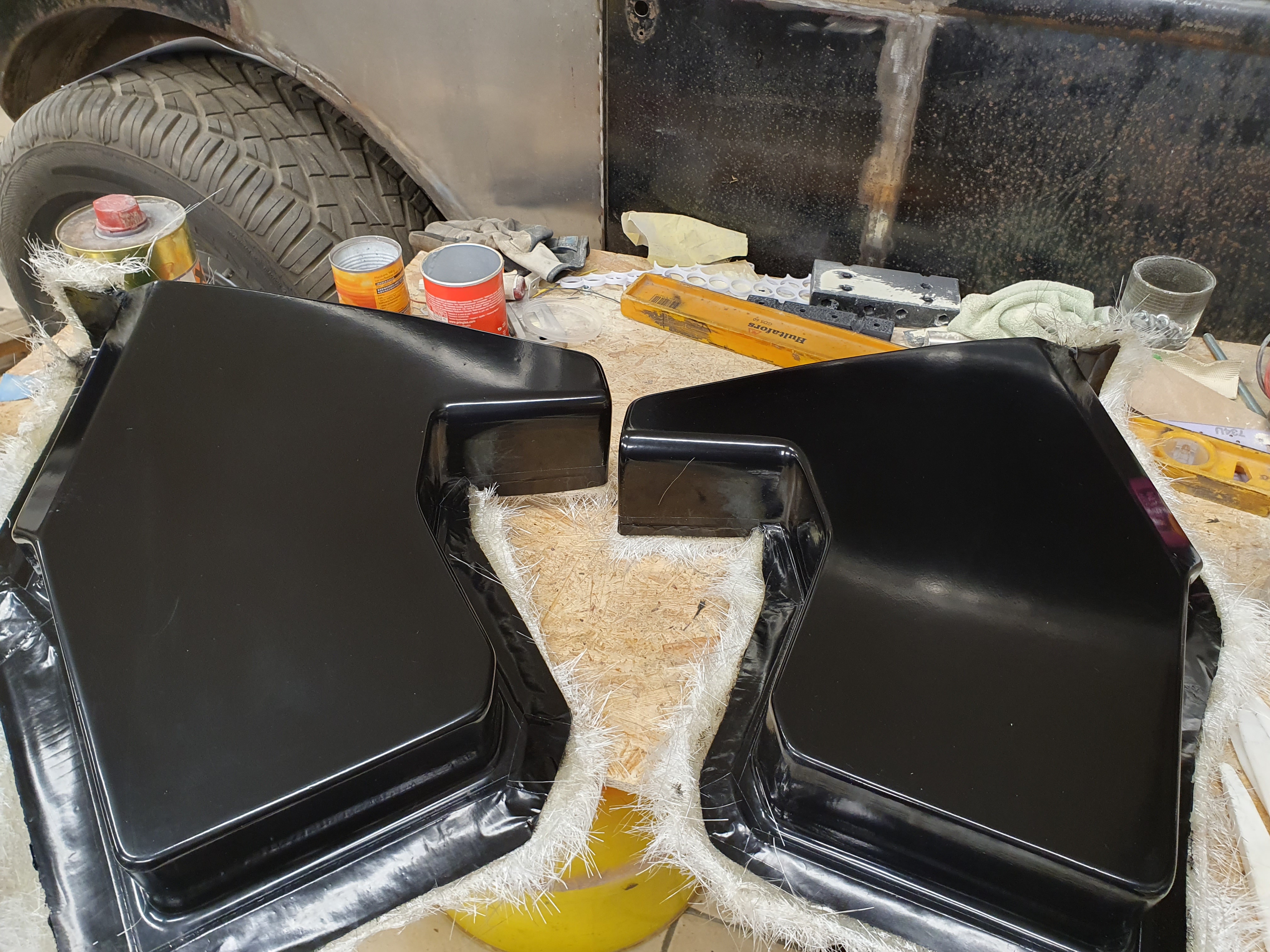

I put on one layer of gelcoat yesterday, then one more today. After about 45min I started with the fiberglass and polyester.
I will see tomorrow how it turned out :)
That looks very nice!
I made my battery tray/box from 1.5mm thick stainless steel, but I think this looks a lot more professional.
