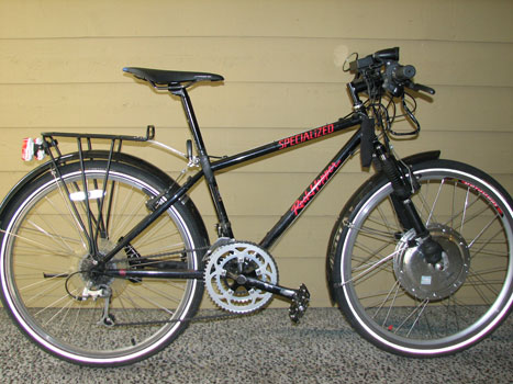

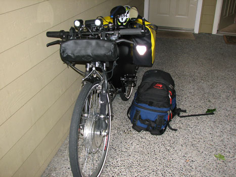

I took my commuter P0 ebike and stripped it bare, then rebuilt it for touring. The Plan now was to get the bike on Amtrak, ride from Seattle to Klamath Falls – Oregon (the last stop to handle baggage before Sacramento), and ride out to our family farm in the forest located about 80 miles north of Truckee/Lake Tahoe.
P0: Stripped down and dirty.
Rebuilt and ready to rumble.
Front view. Toolbag: I just had to mount a piece of HD-hardware :twisted:

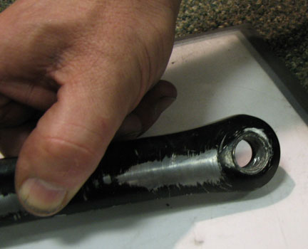

On the way into downtown Redmond I noticed my left pedal feeling really odd. Almost right in front of the Matador (a nice Tequila bar) the pedal is nearly falling off the bike. WTF?? -> I head to REI directly for emergency repair. The guy applies a helicoil to the left crank for $30. I finally reach home about 3:30-4PM.
Stripped out.
Repaired.
Mounted; good to go.
Conclusions:
  • I figured out the ebrake was causing the throttle to drop (this would plague my performance all the rest of the trip, though not as severely). This is my fault. :oops:
  • Testing the rest of the system with my default original controller with six months of reliable performance proves to me that the Lyen’s Mini-Monster is hosed. Mods to this unit were applied by myself and through Lyen, thus is would be difficult to determine where the error lies.
  • The left pedal came loose because I was distracted by my anger at missing the train, and I did not properly tighten the unit. My bad. :cry:

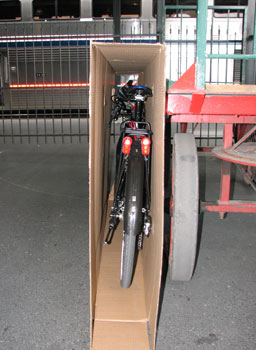

Got to the Amtrak station at 8:45AM ~ plenty of time. Got the bike loaded into the box; all good! I get in line to get on the train.
Bike-outside-a-box...
Bike-in-a-box!
Folks see me in my biking regalia and I relate the saga of the day before, especially about being turned away by Amtrak. As if on cue, not five minutes before boarding the train, the same snotty employee that told me I was too late to board comes right over and tells me that my bike-in-box is 10 lbs too heavy (60 lbs total). I didn’t get angry, though I did give him a look of contempt, and so did the others around me. Wavering, he says “I’ll let it slide this time”. What a little penis. :x

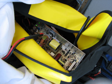

I noted that the train has power :idea: :idea: so I break out the charger and try charging both batt-packs but no joy. Removed the pesky fan and cover from the S-350-27, re-ordered the boxes placing the S-350-27 unit on the top of the stack (so I could easily have the cover removed), reset all the units to the minimum output which equaled 63V, and tried again: It works! But it seems to charge at 1/2-power.

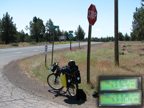

Time? Stopped at about 50.43 miles for rest, drink, snack. Stats: 58.3V, 21.19 Ah. Took some pics.

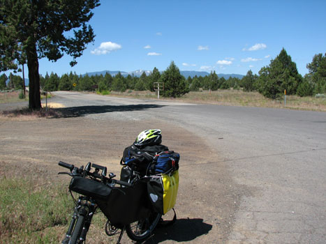

Time? At 101 miles and 54V, I stopped for a scenic view (see panorama). Somewhere around 55 miles I passed through a USDA checkpoint.
The friendly officer warned me not to camp near the road least I be assaulted and robbed by a roving band of malcontents; I promised that I’d stay in motels. Later at about 80 miles a calf wandered out onto the road to see what was coming towards it (the hub making the unusual sound); I ran my little ding-dong people bell and the calf bolted off the road. Neat! At about 87 miles I began to descend into the farming plains near the town of Lookout; here is where I began to experience a growing headwind. In Lookout, I made a wrong turn but a local taking his toddler for a walk corrected me; enjoyed a brief chat with the guy who seemed quite worldly for being so far off the beaten path. Motoring on…
Mount Shasta and me bike.
Panorama of the Pitt River Valley. Mount Lassen is the snow-capped mountain on the left, and Shasta is on the right. Fall River Mills is about in the center. If you can't see the full image (it looks like it's cropped to me) click here.

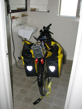

Time? At 113 miles I began to lose power (42.7V); suspect LVC or power resistors preventing further operation (this is a good thang). I had to pedal against a very strong headwind to the edge of Fall River Mills. I pedaled up to <redacted> market and right away began lurking for a power connection. I found one almost as I pulled up but it was too difficult to reach, so I pulled around to the front main entrance of the store where I discovered a Pepsi machine had an extra plug-in a foot away. Parking the bike to hide the connection, I clandestinely set up my charger, covering it lightly with a tee-shirt and made like I was tinkering on my bike for the next 90 minutes. The employee break area was just a few feet away, and I got one of them to watch my bike and stuff whilst I used their facilities.
Nice Pepsi Machine 8)
Oohhh, lookie here!
Hidden by tee-shirt, my funky Meanwells mean business :twisted:
Oh, forgot to mention: When I was on the train the attendant running the snack bar suggested I try the Veggie-Burrito; Man I don’t know what was in that but I had major GI-pain building up. Maybe it was nerves too; I dunno. Gas-X did not help. At one point I was feeling quite ill. WTF? :cry:
I also took this time to UN-MOD the shunt/parallel resistor (R33) and I noticed that the charger was working slightly faster. The wind is really picking up and the charging slowed down as I hit the meat of the pack. At 53V …I’m wishing the wind would turn into a tailwind. Charger was getting warm and needs to be in the open so I move it but this exposes my operation.
Anyway – at some point someone figured out that I was siphoning a charge and I figured that my good will had run out, so I packed up and headed on down the road, partly charged to 55.3V – I leave at about 4:30PM. :twisted:
