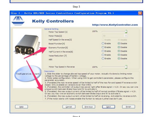

+ Low speed growl at throttle-on from a stop(0-2mph), and even after enabling the firmware's (#7) noise reduction, it's still noticeable. Even while braking, when we get to that 0-2mph zone, it growls (regen is on so that's likely why). Did some reading and apparently this is common in the Kellys. Didn't know that. amberwolf suggested it's probably to do with the current limiting being done by the Kelly on the motor. Will advise as I learn more.

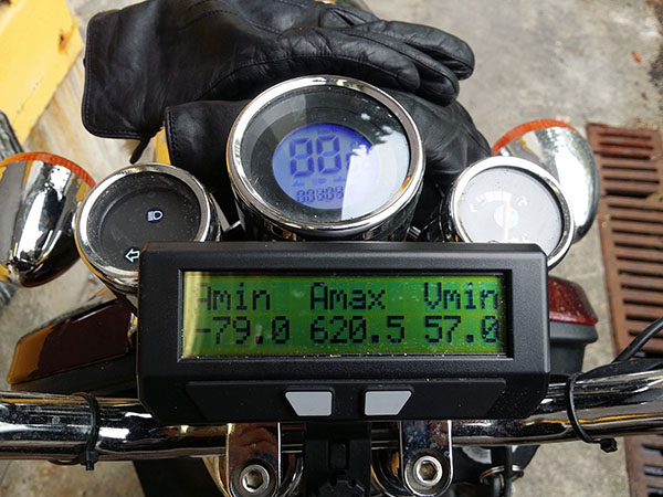

I ended up getting a CA. Can anyone share experience with programming their kelly controller and what spec battery pack they used? (cont. batt amps, peak batt amps)
I have a KEB and 20s10p with LG MJ1 = 100a cont. People at kelly say to limit battery current to 60% and motor current to 80%. Thats 60a cont, but how do I know I'm getting the full peak amps for torque/takeoff?
Okay- so I should probably just set it at like 60% battery current, 100% motor current. Do a couple test runs and see what the CA says, then adjust (I would just be looking at the max Amps reading right, I only have to adjust for that- looking for approx 90a)
Just to double check, CA will give me a battery amps not phase amps right? I've seen some crazy readings on Mistercrash's latest setup like 400a - I know he has a different setup, but just wanted to make sure before I confuse myself further.
The only way to read phase amps is with current sensors installed in the phase wires. If the Kelly has those then it can read phase current, but the CA can only read battery current, because that's where it's shunt goes--in series with the battery.
Not sure if this is the right place for this question but would it be possible to use KEB "economy function" as a speed limiter? Its says it limits speed to half of normal

If memory serves, Fany (from Kelly) told me that KEB series controllers make the growling sound, but KLS series don't. Mine doesn't, and I have a KLS 96501-8080I. Mistercrash has a similar one. I'd imagine his is silent too. Hope it's not too loud. I rode with a trapezoidal controller once, and it was like a lawnmower: brrrrrRRRZZZ!

For settings, I have a 20S Leaf pack similar to mistercrash, and I programmed the CA with LiPo and 21S (for most accurate battery meter icon, otherwise at 68V it still said I had some range left when I was nearly dead). For Kelly software settings, I just opened everything up to 100%. You can then see on the CA whether or not you're exceeding recommended ratings for your parts, at which point, tweak as necessary :p You can choose to play it safe and stay within specs, or surprise yourself with what you can get away with.
This melts the phase wires :p

Regarding your switch and throttle, it would be nice to set that up so you have forward, reverse, and economy mode. Throttle sends 0-5V depending on the position of its twist. In my software, it's possible to set dead-zones too (e.g. 20% high and low deadzone is handy). I'm not sure how the actual electronics of the switch work because I haven't spent time probing mine (I fixed it once by replacement, and once done I moved on), so if anyone knows, that'd be nice to learn about.
