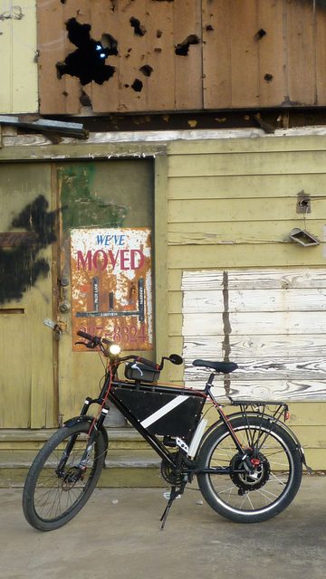

My worst nightmare is passing out at my girlfriends with the bike charging, a packing going thermal, and burning down her apartment.
This is the bike:
This is the battery pack layout:
