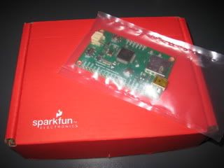

Ding Dong...FEDEX !!
My cute little red box arrived from sparkfun!
Then i first started to read how to begin with this little monster. First you put in a formatted 1 or 2gb micro sd into your computer and format it with 16FAT

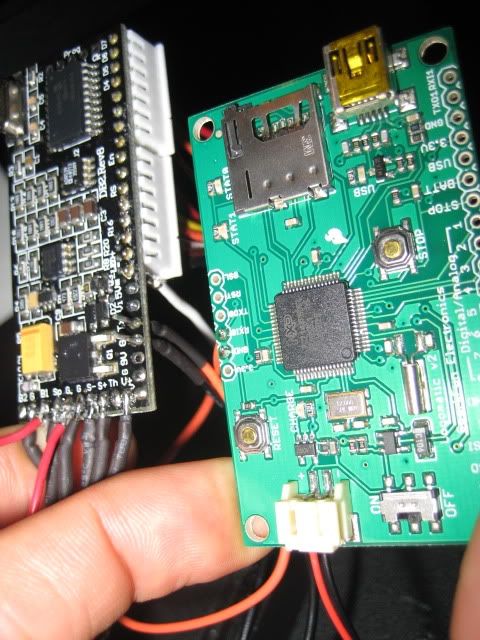

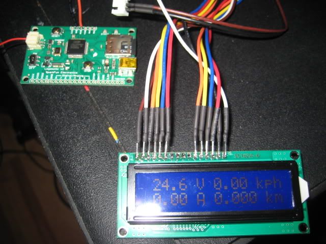

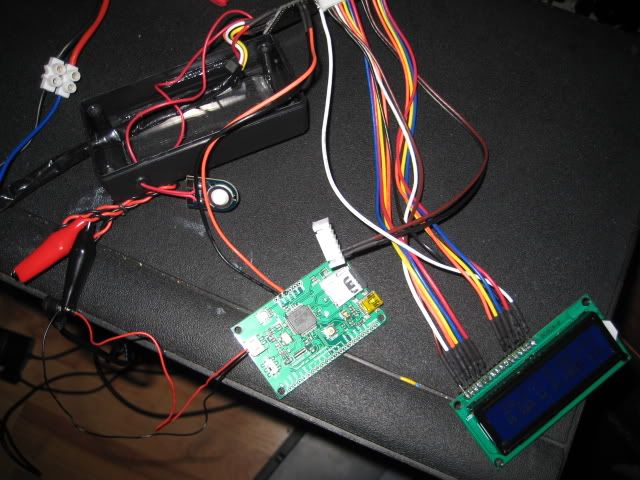

Just put it back into the logger and then connected the TTL output from the CA into the input of the Data Logger.

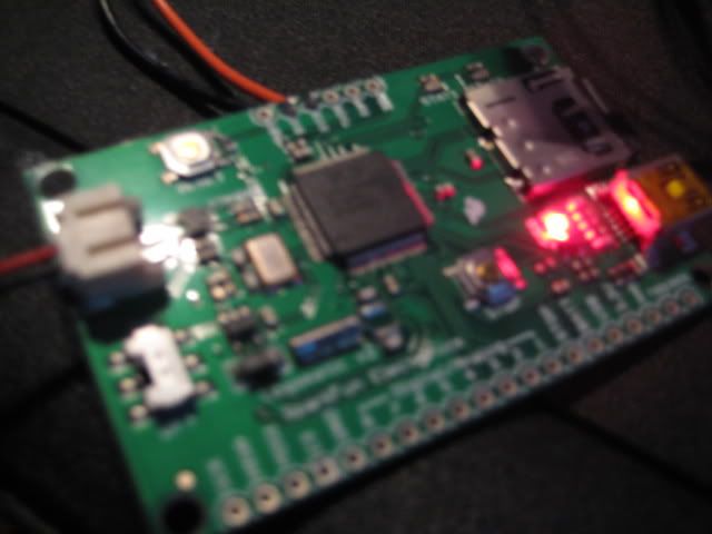

Finally i powered up my CA with 2 experiment lipo's and went into the setup mode to set the output for 5Hz.
Powered up the Data Logger and watched it blink some led's (which indicate that it is writing data) so that was allready a good sign.
Then i put my figer onto the CA to give some old skool 50Hz distortions to let the parametrs change a bit.
Pushed the 'stop' button on the data logger and powered it off and pulled out the micro sd to find out if it had written anything.
And wow ! Yeah it works !!
