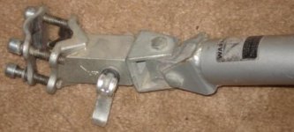

The hitch I had previously used the design of on my old trailer, and since I still want to use it sometimes, needed to use the same hitch on this one.
I did experiment with some other hitches on CrazyBike2 for the flatbed, but like M1-M4, they were not entirely successful. ;)
It's basically a 26" front fork bolted thru the retaining washer lip holes into my rear dropouts' accessory points, with a metal plate securing it at an angle to the rear rack setup:
Part of a cheap steel stem is inserted into that, but not using the jamnut/wedge. Instead, a piece of allthread has a washer (the same diameter as the inside of the steering tube on the fork) trapped between two nuts and lockwashers at it's far end, and the washer is welded to the tube at two points on it's edge by having drilled a hole in the tube so I could see the washer and ensure a good weld to it.
Then the allthread is fed into the stem, as the stem is inserted onto it down into the tube just like normal, and a nylock nut on the allthread pins the stem into the tube so it can't come out. A second stem, this one off a BMX type bike, is placed with it's handlebar clamp parallel to the first stem's clamp, and a long bolt is passed thru them both, with a few washers about the same size as handlebar tube along the bolt within the clamps, to give the clamps something to hold to and keep the bolt from wiggling around. A larger washer between the stems prevents binding, and at least one at each end holds them together.
It is quite stiff to move by hand, but the weight of the trailer easily moves it around. Stiffness makes it easier to attach the trailer, and keeps it from bouncing around when I ride without the trailer. The trailer simply is lifted down onto the upward-pointing stem, and the stem bolt is tightened to keep the trailer from being removed easily (it probably could never fall off unless a bolt shears). The red flashlight is a taillight to mark the stem, just hoseclamped on. (I do not yet have regular lighting back on DGA). Also has 3M reflective tape on there. I only have yellow and white, so white is used up front half of the bike, and yellow in back. Rather have red, but I use what I have. :)

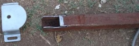

Now for the hitchpost on the trailer itself...
I figured a simple neck of square tube and an angle forward should work, and found I had what was needed already laying around. Neck and headtube off the old ScootNGo carcass:
Some square tube for the vertical mast, notched to fit with a 1/4" thick steel piece off of some stickshifter a friend gave me out of his old van's leftover stuff:
turns into this:
Then after welding the parts together, it's bolted to the front edge of the flatbed, and then slips over the stem that is the hitch on the back of DGA:

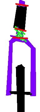

More pondering:
A possible gotcha is that the hitch post is not vertically stiff in the forward/back direction, because of the twistability of the front edge of the trailer even with the angle-steel reinforcement, due to it's long lever arm.
So it's possible that under load in forward motion, the fork plus hitchpost could bend enough to have the tire touch the trailer's leading edge unless I give it a really good clearance of a couple of inches or more.
*Or*, the hitch post and fork post could bend *back* towards the trailer, causing there to be less trail on the caster, and making it jitter back and forth a lot.
It also occurred to me that if I can find the old little coil springs I was going to try to use on ReCycle way way back as rear shock springs, they might have enough springiness to be used as a coilover between the top of a U fork like in the pics and the bottom of the headtube of the hitchpost, preloading it by the tightness of the steering tube nut. I'd just have a big thick fender washer at the top of the spring that the bearing race (normally at the top of the fork) rides on.
Maybe when hands work better i'll put up a better sketch that doesnt' look like it's made of wrecked bike parts.
I thougth about the yellow springs I got recently, but they are too long, the old ones I have aren't much spring but are small enough to fit, and might at least help with a lightly loaded trailer. I'm not even sure springs will do anything much but I am curious to try it both ways and find out.

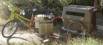

Had to do the dogfood run today. Meant to yesterday, but first I sat down and had an unintentional nap, then later (partly before and partly after the above post) wound up having to give all five dogs flea/tick baths (and spraying some watered F/T shampoo around the house to deter the ticks elsewhere), as the ticks seem to have suddenly bloomed out of nowhere. :(
I can fit five 40lb bags of dog food inside the kennel, and in theory tie two more to the top. But I don't have safe storage for the last two right now, as I am not yet that far down in stock, so I only got five. 200lbs of food in that trailer is pretty unwieldy, but it can now handle it pretty well. There is a slight issue with the left rear wheel's mounting bracket, but I think just adding another U-frame like i did in front will take care of that.
Before I headed out, I swapped out the small caster for the smaller of the two bigger ones above. I also moved the new caster's wheel up to the top set of axle holes, since it is so much larger, to make the trailer bed closer to level. It's still raised a bit at the front, but not by much.
There is still a wobble, caused most likely by the caster and hitchpost both being off center in opposite directions. This is not an issue if the front of the trailer doesn't carry the load, so I think I am going to move the rear wheels forward about 1/3 of the way from the back and try it out. This will require some under-bed bracing across the trailer, so that they do not flex inward at the top and outward at the bottom. The rear wall of the flatbed mostly prevents that now, but there's nothing at the new mounting point to do so.
All in all, it still works much better than the old trailer. It'd still be nice to have a brake I can lock for it, though, when it's parked. Loading and unloading would be way easier, without worrying about knocking the bike over. :)

A friend stopped by to drop off some DayGlo paint, tires, and other things, and he offered to take me to get the trailers in his truck. Given the likelihood of winds and storms later in the afternoon/eve when I'd probably still be on my way back with the stuff on the bike, I took him up on the offer.
Uneventful pick up of them, and they are in pretty good shape. Turns out that the hitches are complete (though the tires are all flat), but I would only have been able to use the Bell trailer to haul the pedal trailer if I rode The Velcro Eclipse, as it's clamp-on hitch requires using the left side chainstay, which is inaccessible due to the cargo pod. I suppose I could've clamped it to the U-fork I have as my hitch for the other trailer, but I'm not sure there'd be enough clearance at the rear of teh trailer to ground then.
It did end up raining cats and dogs for a short time, with very high winds (more than 45 degree angle rain, nearly horizontal at some points). So I'm glad I took him up on his offer. :)
Anyhow, here they are:
THe pedal trailer is foldable for storage, just between the seat and bars.
Hitch clamps on seatpost or seattube.
Folding joint
Clamp-on bars. I'm thinking that if I take the bars and the seat off, I can bolt a platform across there and over the rear wheel to give me cargo space, with something down the sides to tie things to and keep them clear of the rear wheel. I have two big computer-tower carrying cases from CompUSA's old training classes stuff that would probabably work fine; I considered using them on the bolt-together semi recumbent cargo bike originally and there are pics in that thread:
