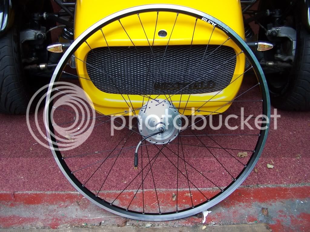

I built a Q100 into a 36h 700c Mavic A319 - erd is 604.5mm, pcd of the hub is 108mm can't remember flange width.
Spoke length came out at 262.4mm left and 262.1mm right - so basically no real difference. Spoking pattern was two cross. Ended up builing with a mix of 263mm and 262mm spokes as that was waht the lbs had in stock.

Sorry - Typo -I meant 262.4mm and 262.1mm - I'll edit the post! And yes the wheel required dishing.
schwibsi said:
@ amiga
What connector did you use there. Looks like for a car.
Yeah - waterproof 3 pin connector left over from the Westfield build.

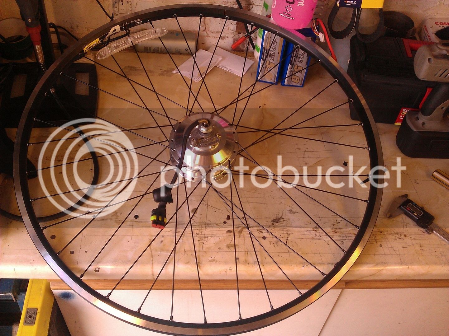

I wouldn't recommend 2 cross for a motor. I'm sure it has been done, but the angles required added to the relatively larger hub means bending spokes.

A Q100 is small though - the flange width is only 108mm. Hell, I had 3x on my Tongxin and that gave me no issues:-
As long as you're using good quality spokes a little bend isn't an issue.

Ok, I guess I stand a bit corrected :D
Is that a 700 rim?
